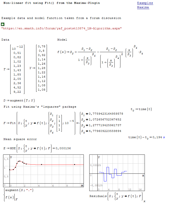

Example application for Fit(), MSE() and Residuals() and efficient plotting.
Example Fit.sm (13,62 КиБ) скачан 1690 раз(а).

Thank you Martin,
I tested it briefly with a larger data set and more than one dependent variable. At a first glance it seems that it works surprisingly fast. I might have forgotten but I think there is not yet a strictly numerical procedure in SMath (available via plugin) for nonlinear fitting a quite large data set to a function with multiple dependent variables.

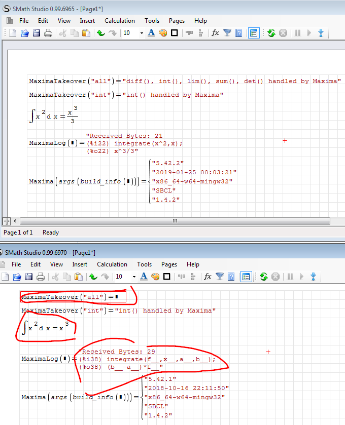

Severe problems since SMath build 6970. Last version tested ok is 6965.
maximaproblem.sm (4,28 КиБ) скачан 1690 раз(а).

Confirmed, I think...

#256 Опубликовано: 06.03.2019 04:29:41
The problem remained unsolved
However, it seems that Det(),Diff(),Int(),Lim(),Sum() are working well.

Plugin updated. Please try.
I think it is all right now. Thank you.

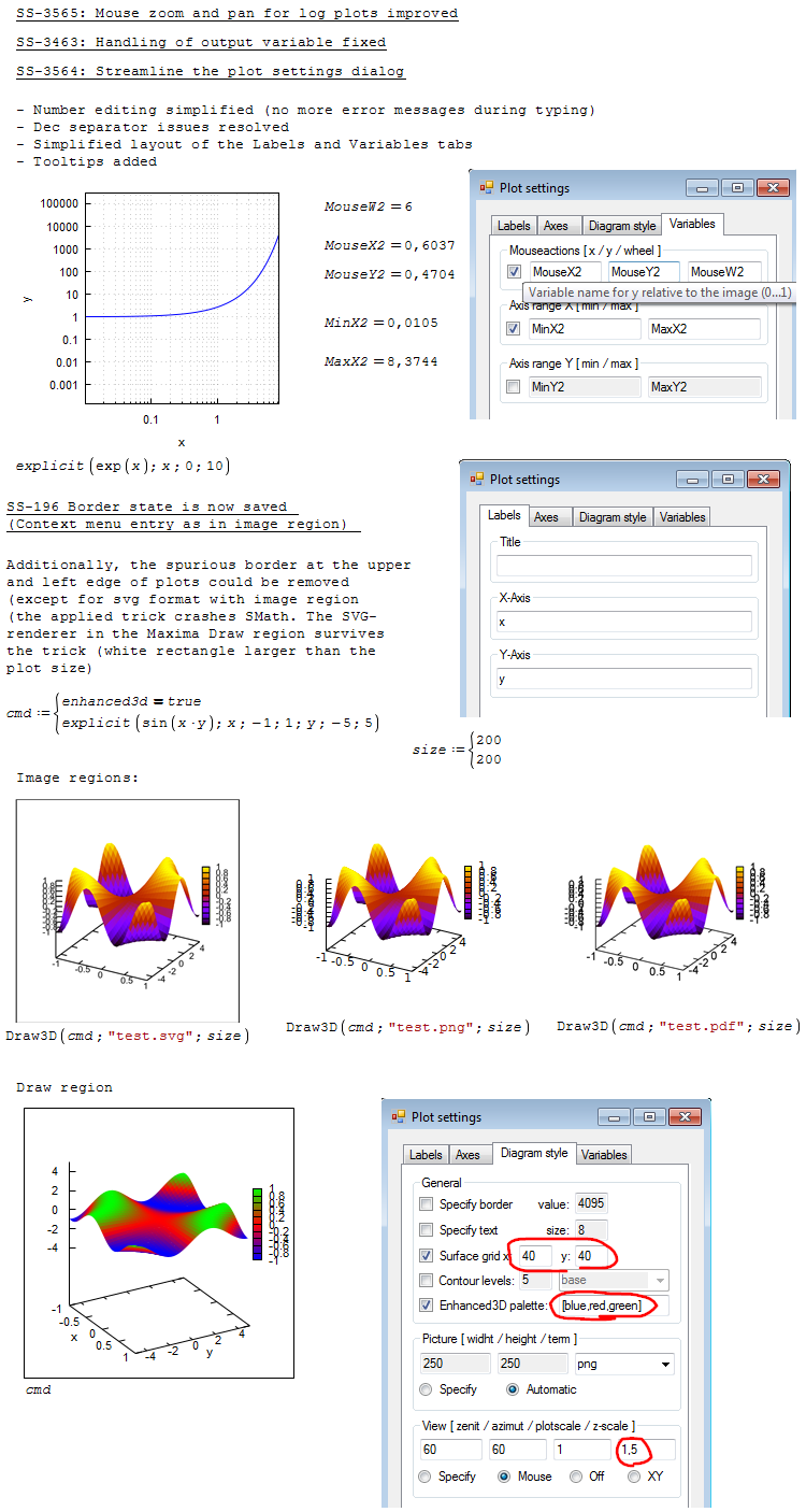

#260 Опубликовано: 06.03.2019 15:40:46
I confirm that the API issues seem to be resolved. Andrey, thank you very much, I might not have been able to fix that soon.
In the test suite (Plugin maxima test.sm in the interactive handbook) there is just a new issue with displaying svg images in the Maxima-Draw-Region and in the image region. PDF and PNG work fine though.
