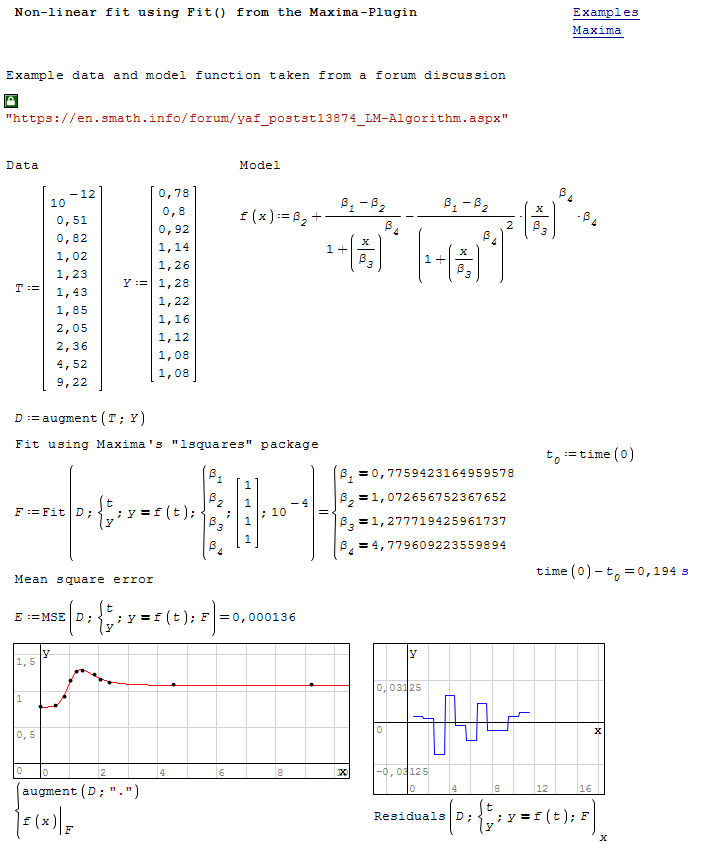

Example application for Fit(), MSE() and Residuals() and efficient plotting.
Example Fit.sm (13.62 KiB) downloaded 1668 time(s).

Thank you Martin,
I tested it briefly with a larger data set and more than one dependent variable. At a first glance it seems that it works surprisingly fast. I might have forgotten but I think there is not yet a strictly numerical procedure in SMath (available via plugin) for nonlinear fitting a quite large data set to a function with multiple dependent variables.

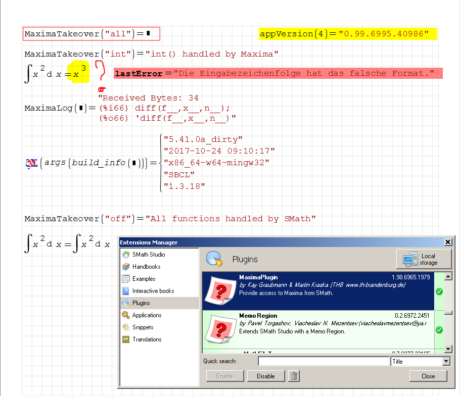

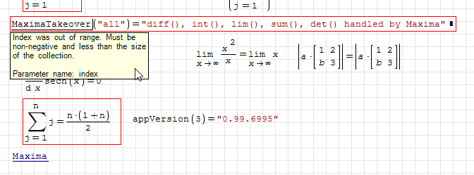

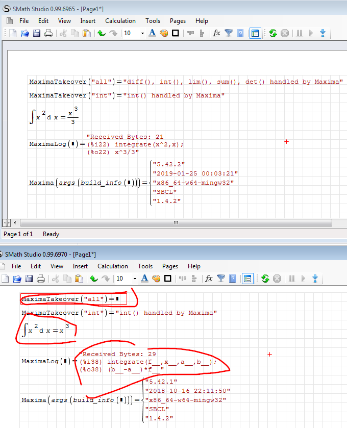

Severe problems since SMath build 6970. Last version tested ok is 6965.

Confirmed, I think...

Hello SMath-Team,
I confirmed, it confuses me too
Best regards,
Andrey

Int() certainly does not work.

Plugin updated. Please try.
Martin Kraska 3/6/2019 3:41:00 PM, frapuano 3/6/2019 5:28:00 PM
#259 Posted: 3/6/2019 3:14:38 PM
I think it is all right now. Thank you.
#260 Posted: 3/6/2019 3:40:46 PM
1,361 likes in 2,275 posts.
I confirm that the API issues seem to be resolved. Andrey, thank you very much, I might not have been able to fix that soon.

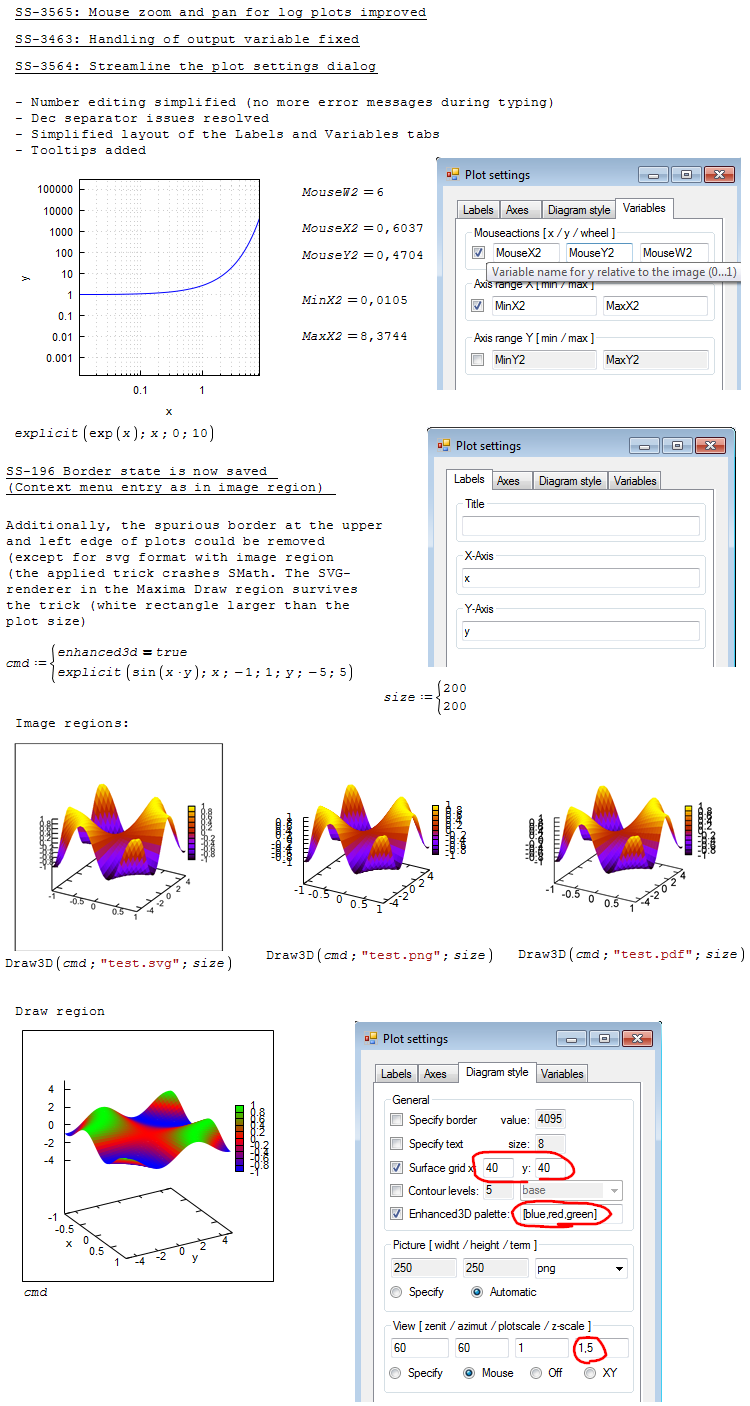

In the test suite (Plugin maxima test.sm in the interactive handbook) there is just a new issue with displaying svg images in the Maxima-Draw-Region and in the image region. PDF and PNG work fine though.
