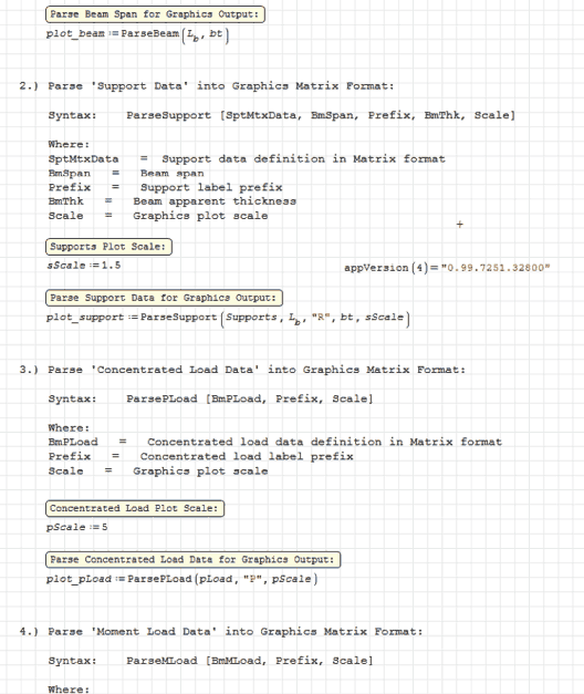

Hi everybody,
I'm trying to use the Structural Beam Analysis plugin, but I've got some problems.
When I open the “Beam Analysis” example I've got the next problem.
The error says "Indice fuera de los limites de la matriz" (Index outside matrix boundaries)
Could somebody help me with that?
Thanks in advance

I've got the problema with the example that's why I didn't send the file before.
You can find it attached.
Thanks
Beam Analysis Input Guide.sm (86.78 KiB) downloaded 1538 time(s).

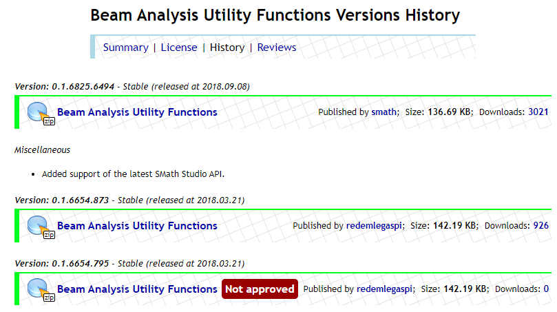

Page Beam Analysis Utility Functions exists but I see this plugin for the first time. If anybody find sources I can update them to work state.
Quote
Analysis of Beam with any number of supports and with any type of loadings.
The worksheet requires that the associated Plugin (Structural Beam Analysis Utililty Functions by Redem Legaspi Jr.) be downloaded and enabled from SMath Studio Extension Manager tool.
The worksheet does the following:
1.) Plots Beam Diagram, Shear Diagram, Moment Diagram, Deflection
2.) Calculates Support Reactions
3.) Calculates Shear, Moment, and Deflection at any given point.
Refer to 'Beam Analysis Input Guide.sm' on how to use the plugin.

Redem Legaspi can ask Anrey how to upload sources to svn. After that we'll can maintain his project without author.
As far as I can see, the last update was made by Andrey. Maybe he has sources.

Sources of Beam Analysis Utility Functions stored on SMath server but author of a plug-in asked not to share them.
Several days ago I've got permissions to fix an issue.
Plug-in functionality restored now. Tested ok with all available sample worksheets.
New version of a plug-in available using Extensions Manager.
Вячеслав Мезенцев 2020/2/5 05:17:00, sergio 2020/2/5 05:33:00, Martin_B 2020/2/5 07:10:00
