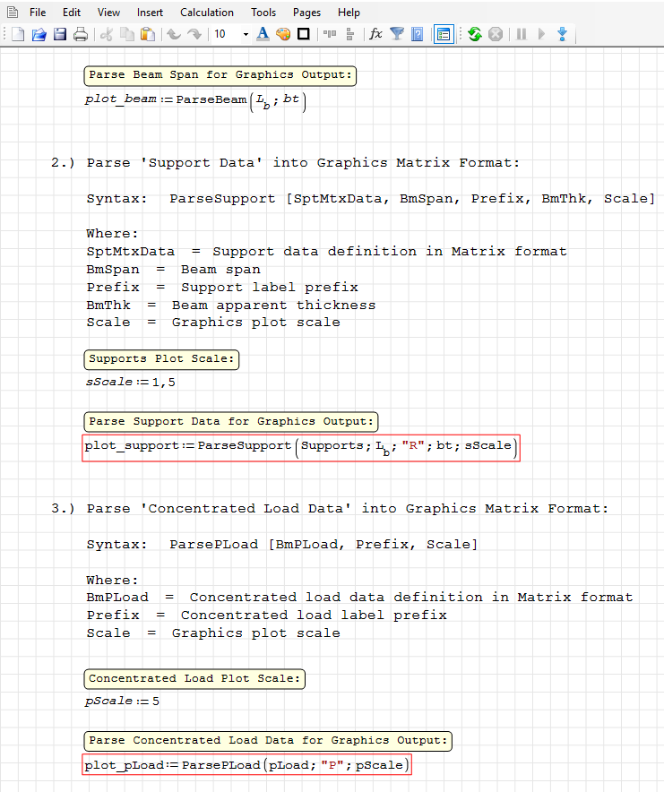

Hi everybody,
I'm trying to use the Structural Beam Analysis plugin, but I've got some problems.
When I open the “Beam Analysis” example I've got the next problem.
The error says "Indice fuera de los limites de la matriz" (Index outside matrix boundaries)
Could somebody help me with that?
Thanks in advance

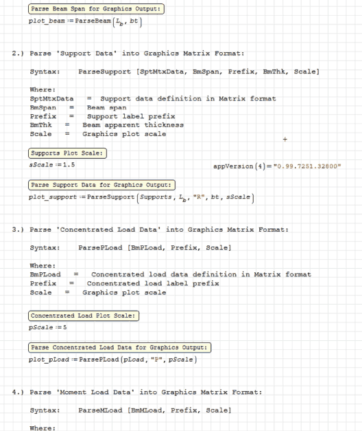

#4 Posted: 1/17/2020 12:14:18 PM
Ruben Sidranski
Ruben Sidranski
17 likes in 465 posts.
Do an AppVersion on the file
There has been a lot of work under the engine by the developers since this was issued. You'll need to update it and preferably, repost. I don't do a lot of beam calcs, so I have not touched this in a while.
NOTE: Opened fine in 7251

#6 Posted: 1/17/2020 3:56:49 PM
e.artola
e.artola
0 likes in 4 posts.
I've tryed in different ways to fix it but I continue with the same error.

#8 Posted: 1/18/2020 12:01:12 AM
NDTM Amarasekera
NDTM Amarasekera
130 likes in 352 posts.
There has been a lot of work under the engine by the developers since this was issued.You'll need to update it and preferably, repost.I don't do a lot of beam calcs, so I have not touched this in a while.
The original file showed Red while opening, but finally opened successfully in SS 7251.
Then saved as with a new name, which opens later without any such hassle.
#9 Posted: 1/21/2020 8:12:13 AM
e.artola
e.artola
0 likes in 4 posts.
Could somebody show me how to solve it please?
Thank you in advance

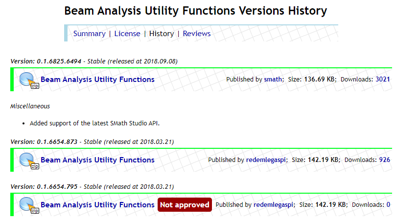

#16 Posted: 1/27/2020 8:49:15 AM
1,558 likes in 1,868 posts.
I'm going to try to find the sources you asked for, mailing Redem Legaspi. Any specific file or extension?
Redem Legaspi can ask Anrey how to upload sources to svn. After that we'll can maintain his project without author.
As far as I can see, the last update was made by Andrey. Maybe he has sources.

#18 Posted: 1/29/2020 12:12:55 PM
eswte
eswte
0 likes in 8 posts.
Hi I have the same problem with the Beam Analysis, have you got some answer?
#19 Posted: 2/5/2020 4:11:36 AM
2,344 likes in 4,057 posts.
Hello.
Sources of Beam Analysis Utility Functions stored on SMath server but author of a plug-in asked not to share them.
Several days ago I've got permissions to fix an issue.
Plug-in functionality restored now. Tested ok with all available sample worksheets.
New version of a plug-in available using Extensions Manager.
Вячеслав Мезенцев 2/5/2020 5:17:00 AM, sergio 2/5/2020 5:33:00 AM, Martin_B 2/5/2020 7:10:00 AM
