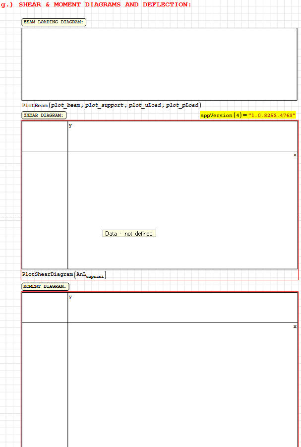

Hi everyone,
I have been using Smath for many years, but this is my first time writing to the forum
I have a problem with Structural Beam Analysis plugin. I download the Beam Analysis Input Guide from Extansions Manager and didn't change anything in the Smath file.
I couldn't figure out what is causing this situation. Do you have any idea?

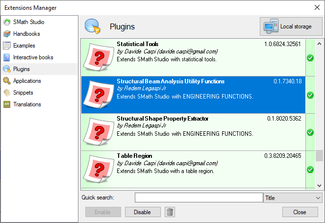

work fine for me, maybe -->
This worksheet requires that the associated Plugin (Structural Beam Analysis
Utility Functions by Redem Legaspi Jr.) be downloaded and enabled from SMath
Studio Extension Manager tool.
#25 Posted: 2022/9/16 10:24:58
Safak
Safak
0 likes in 2 posts.
Thank you for your reply. The plugin was already enabled.

Sources of Beam Analysis Utility Functions stored on SMath server but author of a plug-in asked not to share them.
Several days ago I've got permissions to fix an issue.
Could somebody help me with that?
Plug-in functionality restored now. Tested ok with all available sample worksheets.
New version of a plug-in available using Extensions Manager.
