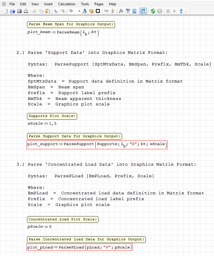

I'm trying to use the Structural Beam Analysis plugin, but I've got some problems.
When I open the “Beam Analysis” example I've got the next problem.
The error says "Indice fuera de los limites de la matriz" (Index outside matrix boundaries)
Could somebody help me with that?
Thanks in advance

I've got the problema with the example that's why I didn't send the file before.
You can find it attached.
Thanks
Beam Analysis Input Guide.sm (86,78 КиБ) скачан 1801 раз(а).

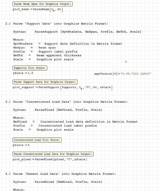

#8 Опубликовано: 18.01.2020 00:01:12
NDTM Amarasekera
NDTM Amarasekera
Do an AppVersion on the file
There has been a lot of work under the engine by the developers since this was issued.You'll need to update it and preferably, repost.I don't do a lot of beam calcs, so I have not touched this in a while.
NOTE: Opened fine in 7251
The original file showed Red while opening, but finally opened successfully in SS 7251.
Then saved as with a new name, which opens later without any such hassle.

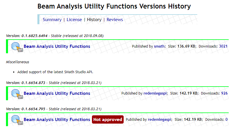

#16 Опубликовано: 27.01.2020 08:49:15
I'm going to try to find the sources you asked for, mailing Redem Legaspi. Any specific file or extension?
Redem Legaspi can ask Anrey how to upload sources to svn. After that we'll can maintain his project without author.
As far as I can see, the last update was made by Andrey. Maybe he has sources.
