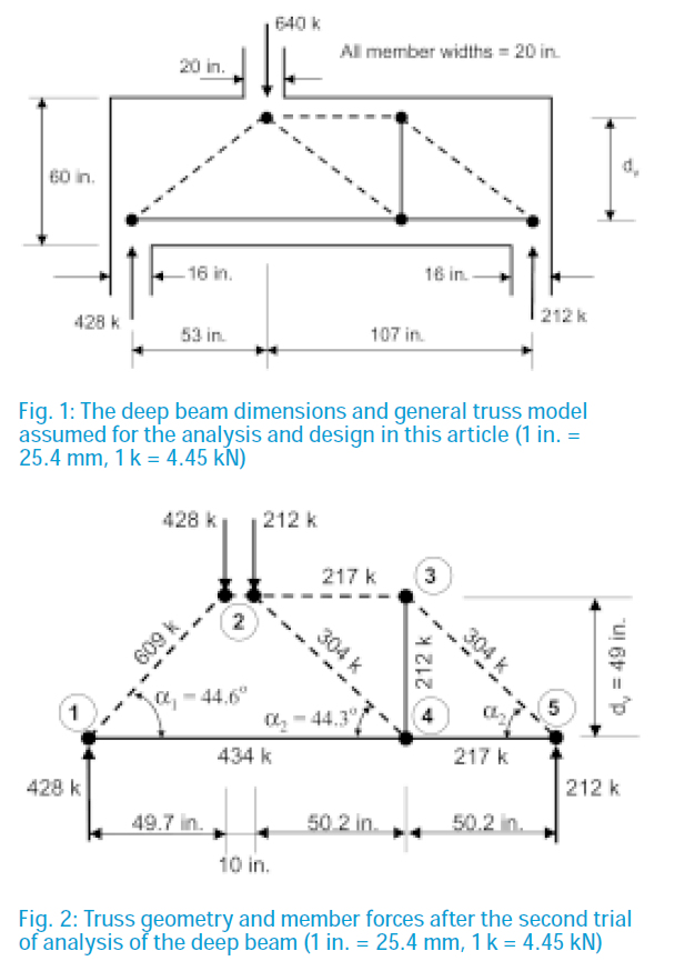

I am attempting to create a solver for a strut&tie model. The solver will loop through all the nodes of the model and create / solve equations of equilibrium. As long as there is as many equations as there is unknowns I can solve for unknowns by simple matrix inverse & multiplication (we all know how it works).
However say we have 4 non co-linear struts meeting at one node. There is more unknowns than equations, hence you cannot do X = A^-1 x B. It would be useful to define and solve actual equations of equilibrium so you can get your solution in terms of some unknown variables. As a designer you can guesstimate a ratio of one strut force to another after the fact, effectively substituting one of the unknown variables by hand after actual solution was done symbolically by SMath.
So the take away: a for loop needs to go through the nodes of the model creating equations of equilibrium. In order to do that it needs to define variable(s) with different names inside a for loop programmatically .

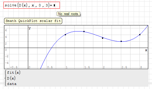

Non linear solver of some kind, poorly documented.
The Mathcad Given/Find would solve with an objective
function [my newbie interpretation]. The "M"
in the attached would solve "Pseudoinverse", posted
few weeks ago in the forum.
Polynomial fit_D[x].sm (18.53 KiB) downloaded 881 time(s).

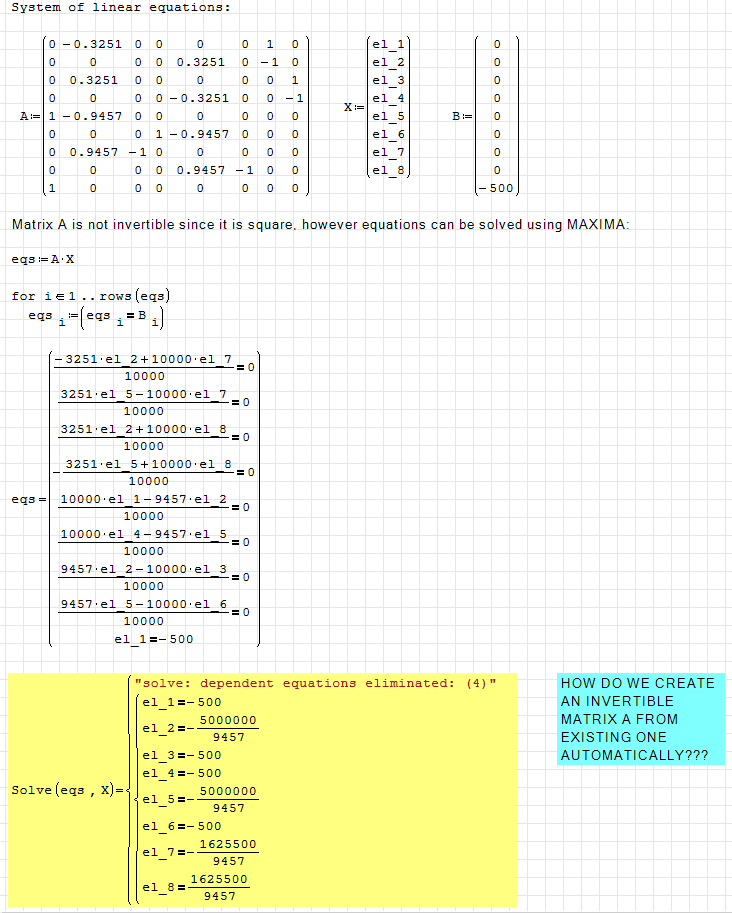

Anyway, from educations perspective, is the a way to solve the following without using Maxima:
solveMaxima.sm (16.48 KiB) downloaded 1042 time(s).

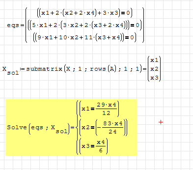

Ioan, one of the reasons why I am not going the FEA way for this task, is because in my design office there is a strong opinion against it (not the best tool for the task? influence of late James MacGregor? - I do not know) Those zero force members almost always end up carrying some load.. Anyway - I must do it the sum(F.x) = 0 & sum (F.y) = 0 way.
So if you, or anyone else know how to solve equations from post 11 the SMath way (3 equations, 4 unknowns, symbolic solution of 3 unknowns in terms of the 4th unknown) I would much appreciate it. So far I tried roots() and maxima's Solve(). Solve() works.

One of them is that when there are 3 unknowns (3 struts whose force is unknown, one strut whose force is known) and two equations of equilibrium at the node, you can guess the ratio between the unknowns (say strut 1 has same load as strut 2 while strut 3 is different, and strut 4 is known). You can base your guess on stiffness, however you do not always know the stiffness before proportioning struts, ties, and nodal zones. You can base your guess on strut angle. You can even do a wild guess, and given the nature of strut and tie (lower bound solution) the structure will behave AT LEAST as good as your guess was, and most likely better (if your guess was incorrect the structure will find a better load path).
So you always have same # of unknowns as # of equations. Except that some of the equations come from engineering judgement (difficult to program ), while others are from routine equilibrium.
And I probably can setup my solution in a way that does not require solving 3 equations with four unknowns, but heck, for educational purposes, can SMath do it (and how)? Maxima can.

Jean, would you happen to know how to find and remove reduntant rows from a coefficient matrix A, that happens to have more rows than columns:
A x X = B
X = A^-1 x B
SolveEquationMaxima.sm (14.67 KiB) downloaded 1007 time(s).
A x X = B
X = A^-1 x B
This is solved using DotNumerics plugin.
Thanks, Uni!
SolveEquationDotNumerics.sm (9.73 KiB) downloaded 1023 time(s).

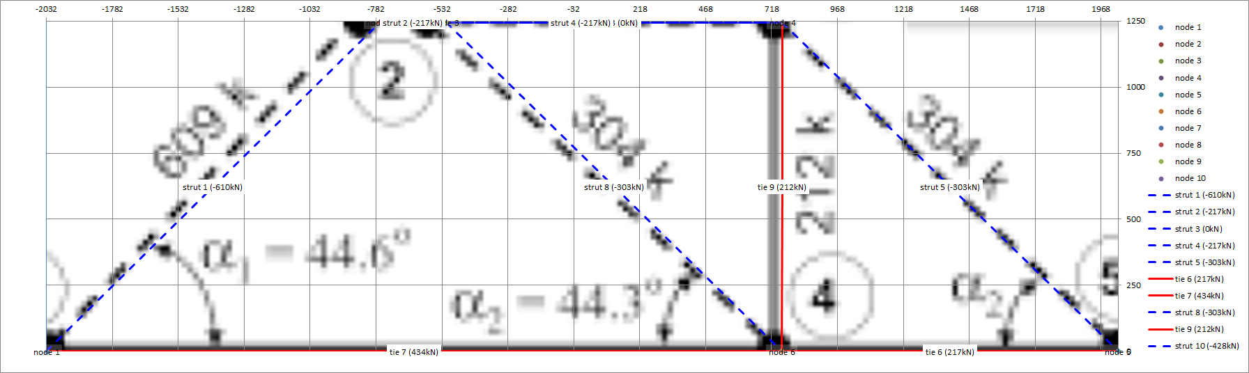

And a little teaser of what I am working on... Everything you see was created by an EXCEL macro (from graphical representation perspective), solved in SMath and presented in EXCEL.
Process of model creation / presentation / solution is fully automated.
By the way, Ioan, SMath solution of this strut & tie worked from the very first attempt - felt like a miracle

For instance in the appended document ci2505wight.pdf (155.21 KiB) downloaded 10974 time(s).they go to modify the physical height of the beam in order to satisfy the model, what's not usual in engineering.
However, the subject is for specialists and therefor, I decline my intrusions; I'm a specialist but not in this item.
It's strange for me to understand how they obtained that the reaction on the left support is 428k while a simple calculation gives 640*107/(107+53)= 361k and the beam is nothing that a simply supported beam. Does the beam know this forcing "joke" ?
As I know the apparently forum composition, it is not here the right place to "negotiate" such a fine item

And this little guy took me about 20 minutes to setup.. Mostly defining coordinates and stuff. If the drawing was to scale I could have just located the nodes of my strut & tie graphically.
Small typo:
640*107/(107+53)= 428
