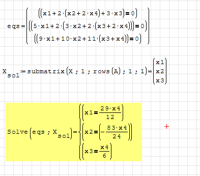

Hi All,
I have searched through the forum and could not find whether it is possible to define the new variable programmatically in SMath, in my case inside a for loop.
here is the problem statement.
I am attempting to create a solver for a strut&tie model. The solver will loop through all the nodes of the model and create / solve equations of equilibrium. As long as there is as many equations as there is unknowns I can solve for unknowns by simple matrix inverse & multiplication (we all know how it works).
However say we have 4 non co-linear struts meeting at one node. There is more unknowns than equations, hence you cannot do X = A^-1 x B. It would be useful to define and solve actual equations of equilibrium so you can get your solution in terms of some unknown variables. As a designer you can guesstimate a ratio of one strut force to another after the fact, effectively substituting one of the unknown variables by hand after actual solution was done symbolically by SMath.
So the take away: a for loop needs to go through the nodes of the model creating equations of equilibrium. In order to do that it needs to define variable(s) with different names inside a for loop programmatically .
How can it be done?
P.S.: Frankly if functionality does not exist I would not expect it to be difficult to create a function that takes input str2var("b7") and spits out just b7 without "". I am just not sure it is worth creating a separate plugin for such a function.

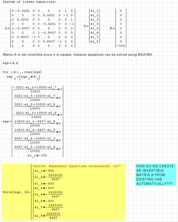

Anyway, from educations perspective, is the a way to solve the following without using Maxima:
solveMaxima.sm (16.48 KiB) downloaded 1212 time(s).

Alex,
As now things get more sense. Always an example or a sketch tell more than a long speech
Not importing on your mathematics tool you are in front of a mechanism case (physically speaking) that means that you have 3 equations and 4 unknowns.
Such a system has a simply infinity of solutions.
As I already said, you need a complementary condition to determinate the system from mathematical viewpoint.
One solution is to take one of unknowns as parameter and to determine it with an optimization technique, for instance in respect with the energy.

- Would you happen to know the answer from my previous post? I would prefer not to use Maxima unless I have to...
- A fake mechanism is quite typical in strut and tie, many of the typical solution-by-matrix will not work. Try to solve this (pin supports at each end of member) in any analysis software:
The mechanism is implied, but non existent in reality (we are looking at a chunk of concrete). Solution is generated by satisfying equilibrium at nodes.
- Im likely to revise my approach and define all conditions prior to, rather than after the solution - i appreciate your constructive criticism.

Ioan, one of the reasons why I am not going the FEA way for this task, is because in my design office there is a strong opinion against it (not the best tool for the task? influence of late James MacGregor? - I do not know) Those zero force members almost always end up carrying some load.. Anyway - I must do it the sum(F.x) = 0 & sum (F.y) = 0 way.
So if you, or anyone else know how to solve equations from post 11 the SMath way (3 equations, 4 unknowns, symbolic solution of 3 unknowns in terms of the 4th unknown) I would much appreciate it. So far I tried roots() and maxima's Solve(). Solve() works.

Jean, would you happen to know how to find and remove reduntant rows from a coefficient matrix A, that happens to have more rows than columns:
A x X = B
X = A^-1 x B
SolveEquationMaxima.sm (14.67 KiB) downloaded 1177 time(s).
A x X = B
X = A^-1 x B
This is solved using DotNumerics plugin.
Thanks, Uni!
SolveEquationDotNumerics.sm (9.73 KiB) downloaded 1199 time(s).

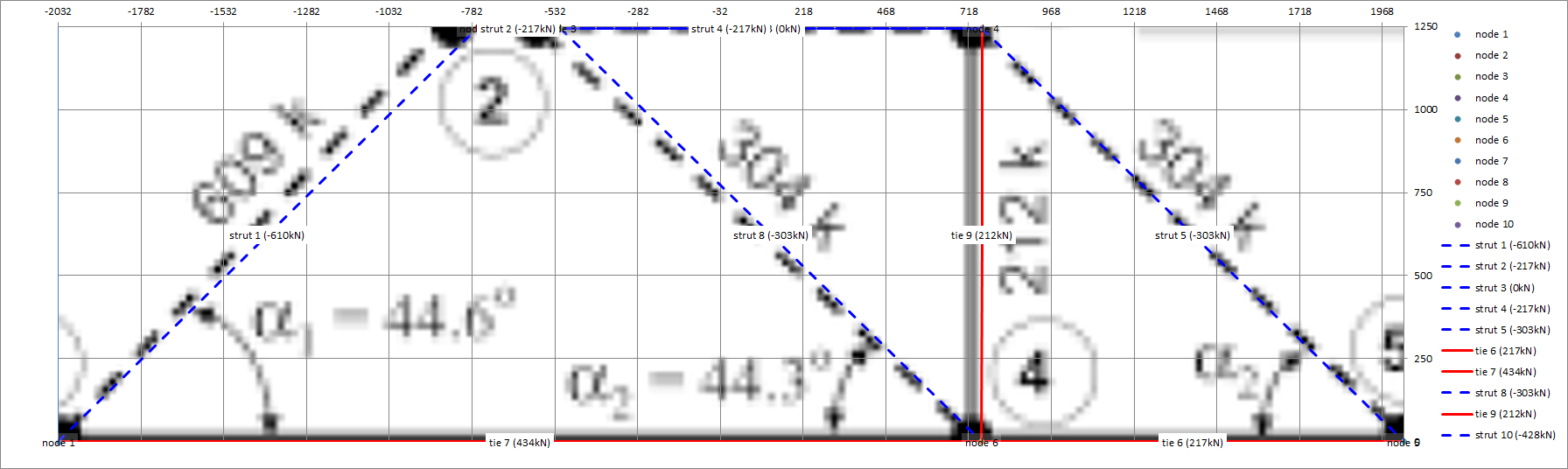

And a little teaser of what I am working on... Everything you see was created by an EXCEL macro (from graphical representation perspective), solved in SMath and presented in EXCEL.
Process of model creation / presentation / solution is fully automated.
By the way, Ioan, SMath solution of this strut & tie worked from the very first attempt - felt like a miracle

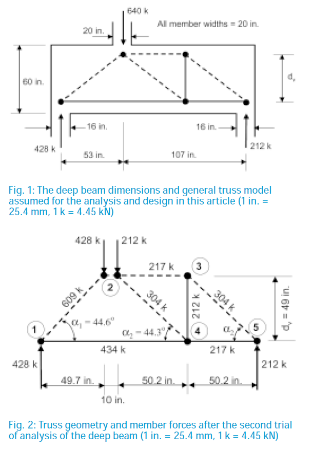

Alex,
I googled around the subject and I noticed an enormous quantity of documents, many dedicated to the experimental side.
It seems that the treatment is often very specific to any concrete problem.
For instance in the appended document ci2505wight.pdf (155.21 KiB) downloaded 11536 time(s).they go to modify the physical height of the beam in order to satisfy the model, what's not usual in engineering.
However, the subject is for specialists and therefor, I decline my intrusions; I'm a specialist but not in this item.
It's strange for me to understand how they obtained that the reaction on the left support is 428k while a simple calculation gives 640*107/(107+53)= 361k and the beam is nothing that a simply supported beam. Does the beam know this forcing "joke" ?
As I know the apparently forum composition, it is not here the right place to "negotiate" such a fine item
Good luck!
Ioan
And this little guy took me about 20 minutes to setup.. Mostly defining coordinates and stuff. If the drawing was to scale I could have just located the nodes of my strut & tie graphically.

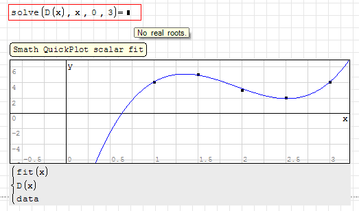

Hello Alex,
Very imppressive and educative. I have done no Smath project
using "Dot Numeric" yet. One thing at time. A vector that
cancels rows is one thing, though my understanding of Non-
Linear Programming wrt your application is an iterative
trial/error ... usually done via "While" loop for simple
stuff solving for not conventionally solvable [one unknown],
for more that one unknown, Smath is missing the program code
"on error" for branching the "while" loop. I'm actually working
on a picewise continuous function [not solvable]. Smath comes
close but never exact enough ... like Smath laughing hihihi !
Thanks, be good: Jean

... just solved the "unsolvable". Ah ! the silent bugger.
What is it ? the piecewise continuous function is very
granular. So, "init" has to be pushed manually, surprise.
Small typo:
640*107/(107+53)= 428
ioan92 3/13/2016 5:15:00 AM
