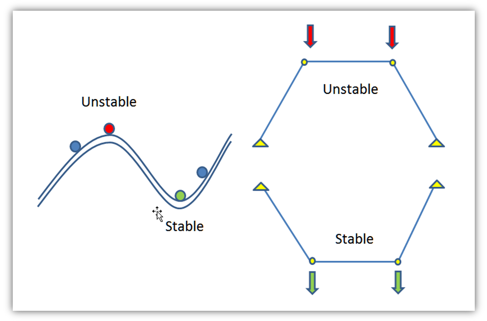

Alex,
Here is a little reflection concerning the risks of the confidence in mathematics let alone.
Here is an example:
You have a classical illustration of the stable vs unstable equilibrium.
Both mechanisms satisfy the equilibrium conditions (mathematically speaking), they can be well identified by a good mathematics tool, as you tried.
But, for us the two situations are far from being both acceptable. One is "happiness" (OK!) while the second is purely "unhappiness" (KO!!!).
Ties and struts are reversed.
That's one of the reasons why I think that it is better to handle a strong equilibred modeling.
I 100% on board with you for not solving the truss using F.x & F.y equilibrium alone - frankly I would not sleep well at night if I did. Lets keep things in perspective though. I am solving stru & tie model and strut and tie is looking at a solid chunk of concrete. Struts and ties are just the stress fields (is this a correct term?) within that blob of concrete. It ain't going nowhere. And is completely stable. (take a look at this deep beam crossection for example

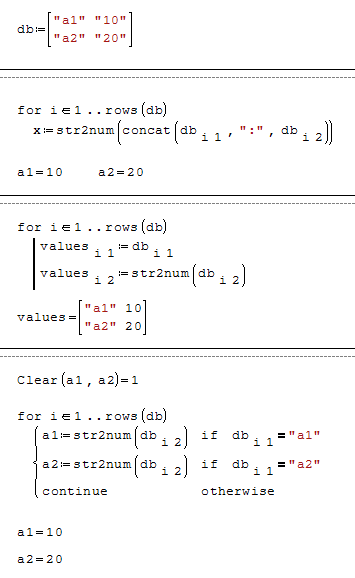

#24 Posted: 2016/11/24 13:37:57
Alexander O. Melnik
Alexander O. Melnik
127 likes in 498 posts.
I am still looking for a way to introduce a new variable name defined from string, and then assign a value to it.
Say if in a for() loop I came across a string "cat44" I would like to create & assign value to variable cat44:="Meow". str2num("cat44") :="Meow" predictably does not work.
#25 Posted: 2016/11/24 14:33:01
1,443 likes in 2,935 posts.
Several ways to do the task
Alexander O. Melnik 2016/11/24 15:58:00, frapuano 2016/11/24 16:45:00
#26 Posted: 2016/11/24 15:57:57
Alexander O. Melnik
Alexander O. Melnik
Thanks alot, I knew there was a way!

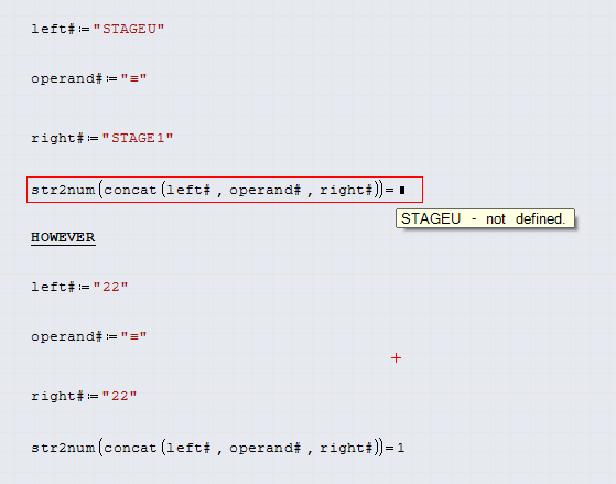

#28 Posted: 2016/12/28 18:47:56
Alexander O. Melnik
Alexander O. Melnik
I figured my question will be appropriate here.
I am trying to create a boolean string using for loop and str2num() on a matrix with three rows - left side, operand, and right side, and n columns.
It seems that everything would work if I could introduce quote charachter inside of quotes. Is this at all possible?
Is there another solution to waht I am trying to achieve?
Thanks!
#29 Posted: 2016/12/29 07:03:48
Nope.
You can use the unit symbol '
Alexander O. Melnik 2016/12/30 16:49:00

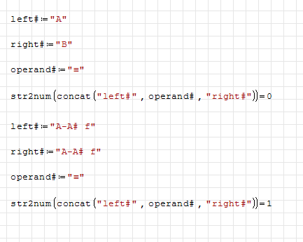

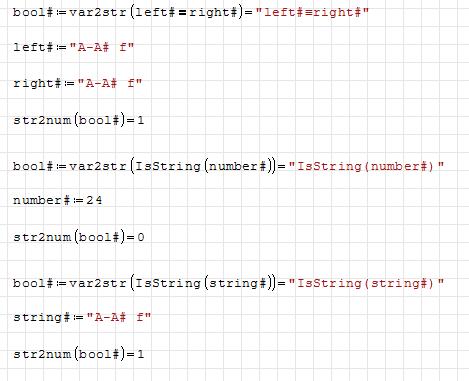

#30 Posted: 2016/12/30 16:54:06
Alexander O. Melnik
Alexander O. Melnik
Thanks alot, with you help i was able to complete my intelligent data sieving algorithm that runs through a data table and pulls out rows based on user defined criteria.
I actually slightly modified your approach using a dummy string variables left# and right#:
Or even better looking:
Now only if I could make the expression left#≡right# return itself in a string format without having to clear variables left# and #right beforehand
