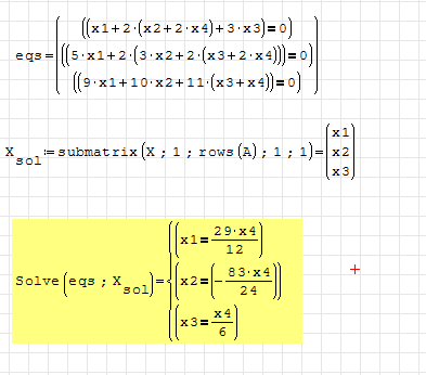

Anyway, from educations perspective, is the a way to solve the following without using Maxima:
solveMaxima.sm (16,48 КиБ) скачан 1212 раз(а).

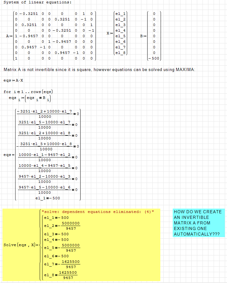

Jean, would you happen to know how to find and remove reduntant rows from a coefficient matrix A, that happens to have more rows than columns:
A x X = B
X = A^-1 x B
SolveEquationMaxima.sm (14,67 КиБ) скачан 1177 раз(а).

This is solved using DotNumerics plugin.
Thanks, Uni!
SolveEquationDotNumerics.sm (9,73 КиБ) скачан 1199 раз(а).

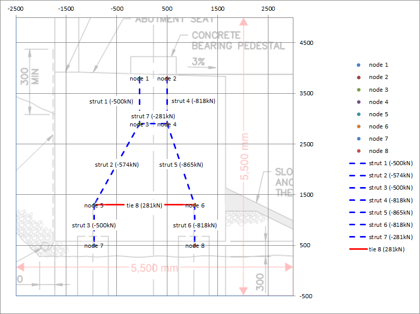

And a little teaser of what I am working on... Everything you see was created by an EXCEL macro (from graphical representation perspective), solved in SMath and presented in EXCEL.
Process of model creation / presentation / solution is fully automated.
By the way, Ioan, SMath solution of this strut & tie worked from the very first attempt - felt like a miracle

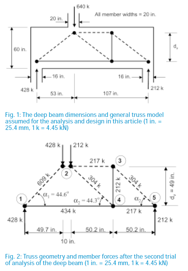

Alex,
I googled around the subject and I noticed an enormous quantity of documents, many dedicated to the experimental side.
It seems that the treatment is often very specific to any concrete problem.
For instance in the appended document ci2505wight.pdf (155,21 КиБ) скачан 11536 раз(а).they go to modify the physical height of the beam in order to satisfy the model, what's not usual in engineering.
However, the subject is for specialists and therefor, I decline my intrusions; I'm a specialist but not in this item.
It's strange for me to understand how they obtained that the reaction on the left support is 428k while a simple calculation gives 640*107/(107+53)= 361k and the beam is nothing that a simply supported beam. Does the beam know this forcing "joke" ?

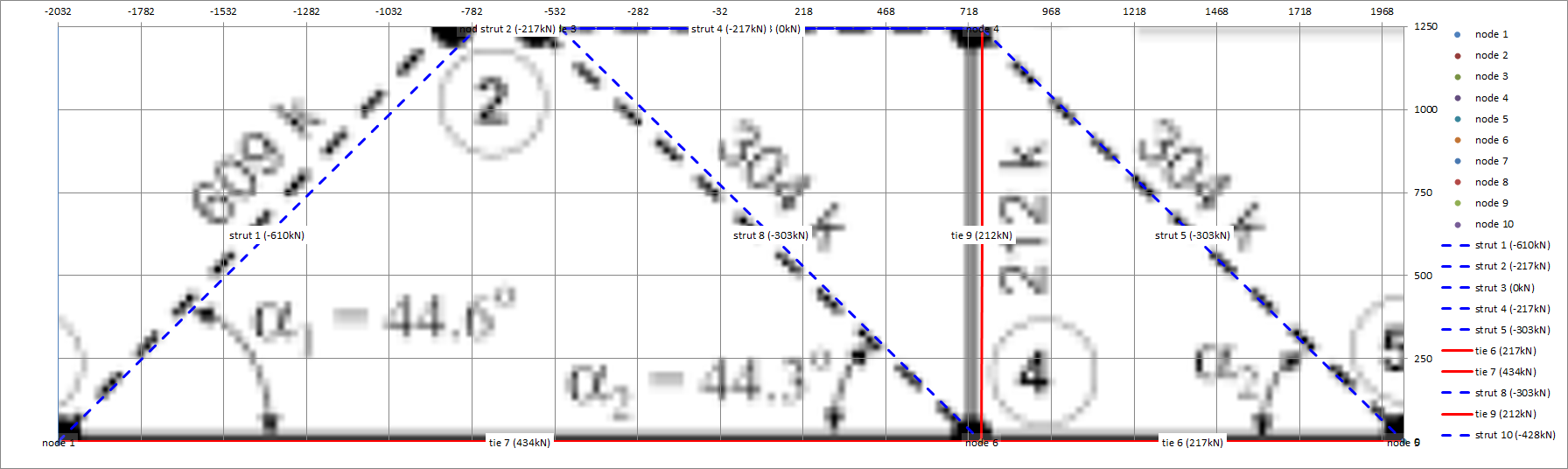

And this little guy took me about 20 minutes to setup.. Mostly defining coordinates and stuff. If the drawing was to scale I could have just located the nodes of my strut & tie graphically.

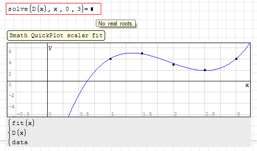

... just solved the "unsolvable". Ah ! the silent bugger.
What is it ? the piecewise continuous function is very
granular. So, "init" has to be pushed manually, surprise.
Small typo:
640*107/(107+53)= 428
