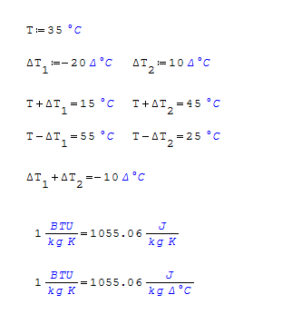

Finally we can use temperature changes now.
Davide Carpi 2014/7/6 21:15:00
We could use temperature changes in the past as well ;-) if we decided to stick to what is physically correct: use absolute units for them.
The new Delta units are good in that they suggest the more sloppy users that there might be a difference to care about.
Yet a major source of errors with offset-temperature units remains: the surprisingly low priority of the unary minus operator.
Radovan Omorjan 2014/7/8 02:40:00

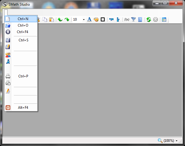

#10 Posted: 2014/7/11 09:11:11
Did anyone experience this Unhandled exception when just trying to change the language interface. When ignoring it, then SMath appeared quite strange - see the picture. Also, see the video on this link changing languages problem (~5min long)

#11 Posted: 2014/7/11 09:28:48
1,435 likes in 2,913 posts.
mhhh... I can't replicate your issue, I've tried with a lot of languages. Have you customized some units xml file?

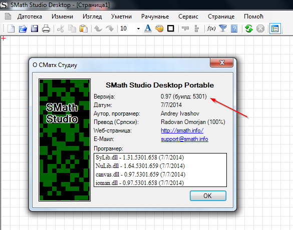

#12 Posted: 2014/7/11 10:33:00
No, I did not do anything like this. Strange, but it happened to my home computer as well (x86 win7) and this nightly build. This happened when you I choose my languages (). It puzzled my more when I managed to use other languages but mine . On the other hand, I have no notification of the changes will have affect after restarting SMath when changing to Srpski or Српски contrary to other languages when I have this notification
Just to note, SMath portable by Martin (2014 06 21 SMath and Maxima) had no problems at all - see the picture.
