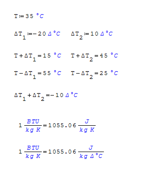

Finally we can use temperature changes now.
Davide Carpi 7/6/2014 9:15:00 PM

We could use temperature changes in the past as well ;-) if we decided to stick to what is physically correct: use absolute units for them.
The new Delta units are good in that they suggest the more sloppy users that there might be a difference to care about.
Yet a major source of errors with offset-temperature units remains: the surprisingly low priority of the unary minus operator.

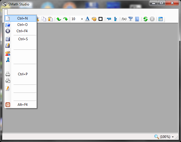

Did anyone experience this Unhandled exception when just trying to change the language interface. When ignoring it, then SMath appeared quite strange - see the picture. Also, see the video on this link changing languages problem (~5min long)

#11 Posted: 7/11/2014 9:28:48 AM
1,443 likes in 2,936 posts.
mhhh... I can't replicate your issue, I've tried with a lot of languages. Have you customized some units xml file?
#12 Posted: 7/11/2014 10:33:00 AM

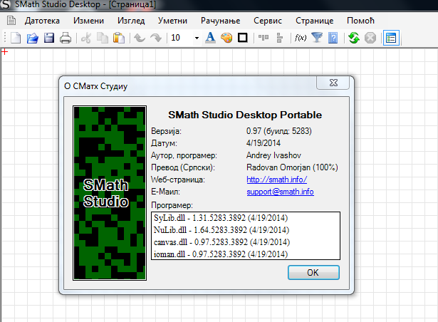

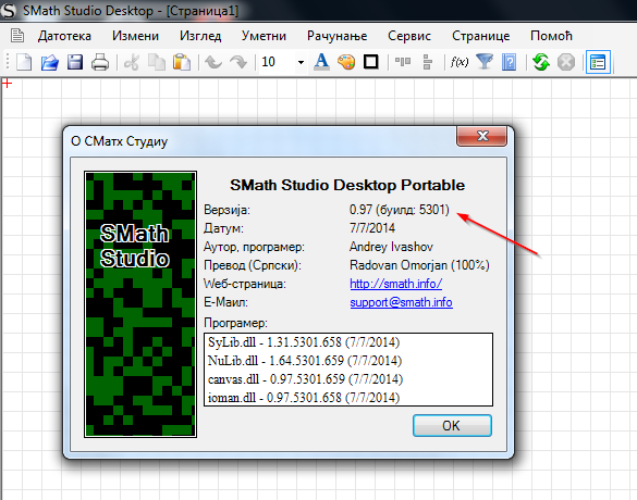

No, I did not do anything like this. Strange, but it happened to my home computer as well (x86 win7) and this nightly build. This happened when you I choose my languages (). It puzzled my more when I managed to use other languages but mine . On the other hand, I have no notification of the changes will have affect after restarting SMath when changing to Srpski or Српски contrary to other languages when I have this notification
Just to note, SMath portable by Martin (2014 06 21 SMath and Maxima) had no problems at all - see the picture.

Seems I found a problem. Radovan, please try to delete lang folder from C:\Users\[YOURPROFILE]\AppData\Roaming\SMath\extensions\.
Looks like it caused because this folder is not empty. I will handle it in next version.
Regards.
#18 Posted: 7/11/2014 2:18:07 PM
It seems you are right Andrey. The lang folder existed in Desktop extensions folder (guess which two files resisted there ) but not in the Portable extension one. I deleted the lang folder as you proposed and now it is all right . I might have figured out earlier, but I use Portable version more often.
