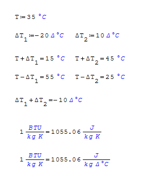

#3 Опубликовано: 07.07.2014 12:13:26
Igor Skarine
Igor Skarine
14 сообщений из 97 понравились пользователям.
Hi Andrey,
I just tried my worksheet which has been working very well with version 097.5283, it doesn't work any more.
The reason is: MathcadEFI plugin from uni is now broken.
Igor
#4 Опубликовано: 07.07.2014 17:46:07
Hi Andrey,
Igor
Wait for an appropriate version appearing here and use that as executable instead of what the installer supplied.
Igor Skarine 07.07.2014 19:32:00
#5 Опубликовано: 07.07.2014 17:53:05
Finally we can use temperature changes now.
We could use temperature changes in the past as well ;-) if we decided to stick to what is physically correct: use absolute units for them.
The new Delta units are good in that they suggest the more sloppy users that there might be a difference to care about.
Yet a major source of errors with offset-temperature units remains: the surprisingly low priority of the unary minus operator.
Radovan Omorjan 08.07.2014 02:40:00

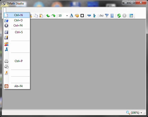

#10 Опубликовано: 11.07.2014 09:11:11
Did anyone experience this Unhandled exception when just trying to change the language interface. When ignoring it, then SMath appeared quite strange - see the picture. Also, see the video on this link changing languages problem (~5min long)
Here are the messages accompanied with this Unhandled Exception:
(x64 Win7)
Показать спойлер

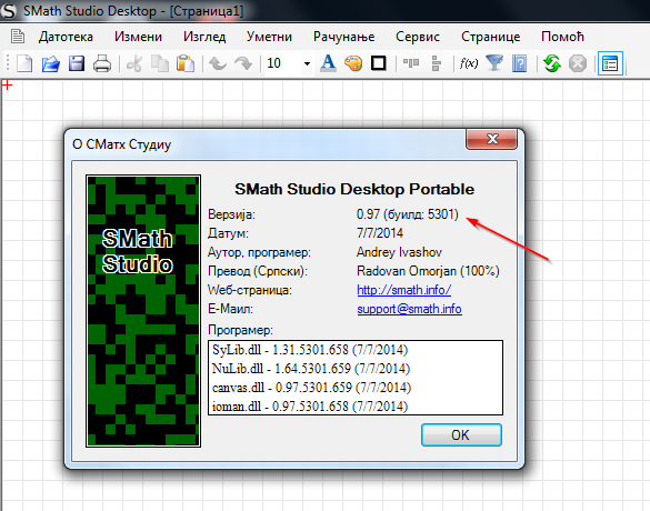

#11 Опубликовано: 11.07.2014 09:28:48
mhhh... I can't replicate your issue, I've tried with a lot of languages. Have you customized some units xml file?
#12 Опубликовано: 11.07.2014 10:33:00
No, I did not do anything like this. Strange, but it happened to my home computer as well (x86 win7) and this nightly build. This happened when you I choose my languages (). It puzzled my more when I managed to use other languages but mine . On the other hand, I have no notification of the changes will have affect after restarting SMath when changing to Srpski or Српски contrary to other languages when I have this notification
Just to note, SMath portable by Martin (2014 06 21 SMath and Maxima) had no problems at all - see the picture.
Here is the Unhandled exception messages from my home computer.
Показать спойлер

Группа: Super Administrator
Seems I found a problem. Radovan, please try to delete lang folder from C:\Users\[YOURPROFILE]\AppData\Roaming\SMath\extensions\.
Looks like it caused because this folder is not empty. I will handle it in next version.
Regards.
#18 Опубликовано: 11.07.2014 14:18:07
It seems you are right Andrey. The lang folder existed in Desktop extensions folder (guess which two files resisted there ) but not in the Portable extension one. I deleted the lang folder as you proposed and now it is all right . I might have figured out earlier, but I use Portable version more often.
Thank you,
