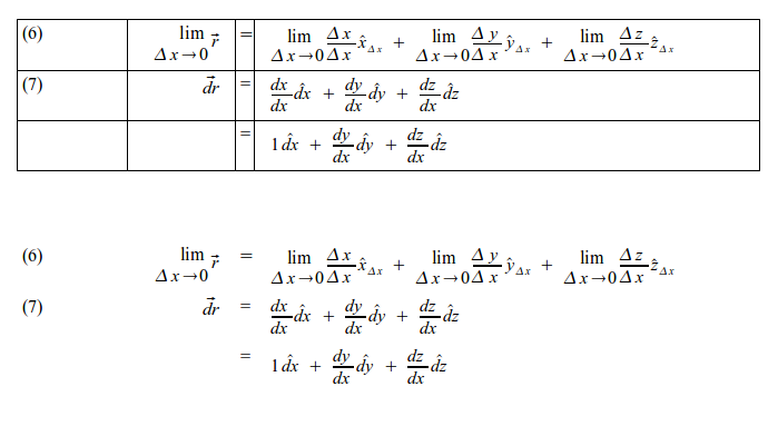

#42 Posted: 2013/1/22 15:24:03
xyonx
xyonx
0 likes in 10 posts.
hi DC,
save as ODT's amazing plugin
more work needed to get document look likes a textbook
UserPostedImage
i usually using repetitive tedious works, add manually ""phantom{...} to hiding, so document become readable and not making eyes victim
just wondering, is this possible to do automatically formating by default? since OOo/LO hard and maybe can not access find and replace for embeded formula
thx u s much
#43 Posted: 2013/1/23 16:20:24
1,443 likes in 2,935 posts.
hi DC,
thx u s much
Hi xyonx,
I think it's possible, I'll try to see what can be done
IMHO your multiline approach it's a very interesting way to represents results and could be an useful solution for Andrey to implement the "Display values with definition" request of SMath users.
best regards,
w3b5urf3r
P.S. the MS Word compatibility of ODT documents containing formulas was reached; with regard to the alignments of the functions I haven't found a way to force MS Word to do it.
#44 Posted: 2013/1/24 17:21:05
Rising Eagle
Rising Eagle
15 likes in 23 posts.
Websurfer,
Very impressed with your projects.
Don't know if this is relevant or how sophisticated you want to be about reformatting stuff, but this thought may be of use. MS word has a facility (as does LO) called tables. When tables are created, each area in the grid is like a mini-page on its own and can be formatted independently of all the others. To align equations, make a 4 column table, put the equals sign (=) in the third column, and narrow the column width to the minimum needed to leave the equals sign visible. Then place equation numbers in the first column, and the LHS and RHS expressions in the second and far right columns. Align the LHS to the right and the RHS to the left. All equals signs and RHS expressions to follow on subsequent lines will be aligned properly.
In the LO file below, tables are used with mathml formula objects in the second and far right columns. Text is used in the first and third columns. This table formatting works in MS office as well. I adjusted the font size of the equals sign until it looked right.
Btw, how does one make math expressions (is it latex?) in these forum posts?

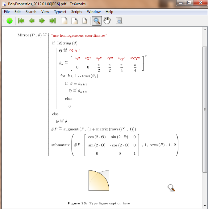

#45 Posted: 2013/1/25 11:51:44
PLUGIN UPDATED
  • added "Save as... > LaTeX Text Document";
  • ODT saving:
    - ouptut ODTs now are compatible with MS word (brackets looks better than saving the file from libreoffice)
    - added options on ODT saving (Save text as images/Save formulas as images/evaluate equations)
    - "Print Area Regions" settings from "Page Setup..."
    - SMath texts on multiple lines now are shown on multiple lines even in the output file.
    - minor changes
  • ODF saving: each evaluation (input formula/symbolic/numeric) written on a different line of code;
  • Embedded languages: ENGLISH/ITALIAN/RUSSIAN
best regards,
w3b5urf3r
5 users liked this post
Mike Kaganski 2013/1/25 18:34:00, Radovan Omorjan 2013/1/25 12:39:00, sergio 2013/1/25 14:52:00, Oscar Campo 2013/1/29 15:45:00, Martin Kraska 2013/1/25 17:17:00
#46 Posted: 2013/1/25 17:16:29
1,355 likes in 2,271 posts.
Hello w3bsurf3r,
thanks for updating the plugin. The Latex-export looks great (not yet tested, but your preview looks promising).
Just a small remark:
default export path is not defined by where the current sm file is but by the current directory. If you first launch SMath, then the current directory for the entire session regardless which files are opened afterwards is where the executable is.
As plugins need to be used with the msi-Installer version, the executable path is normally read only and example execution fails. Anyway you do not want to clutter the install dir by accidental export data.
When you just launch a sm file in the file manager, then current dir is equal to sm file dir.
If you have any chance to determine the sm file path name independently from the current dir, then I would recommend to use this and thereby be consistent to what your docs and examples say. This is would make the target dir more predictable and independent of how the file was opened. Otherwise the comments in the examples might need correction.
Martin

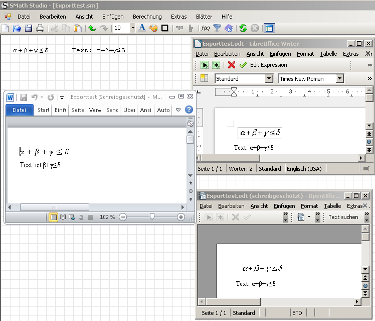

#55 Posted: 2013/1/28 04:07:00
xyonx
xyonx
hi DC, thanx for updating plugins
try using plugins, save as ODF/ODT all symbols did not display (except for Pi) since it contains "i" at beginning symbol code in OOo math
and here's display result,
please consider, is this crucial for math? thx u
#56 Posted: 2013/1/28 08:32:04
I cannot reproduce the problem, see image.
#57 Posted: 2013/1/28 10:13:26
Mike Kaganski
Mike Kaganski
184 likes in 434 posts.
It seems like xyonx have removed the standard content of the LO/OOO Math Collection. My system gives the same for %ivartheta.
Generally I prefer to use greek characters themselves (plus usual Math decoration) and avoid using the collection names. This makes greek to look consistent with other text, no need to use special font for greek since most modern unicode fonts support it, and it enables to use several "styles" of formulas (if using collection, I would need to define a full new set for each style). Maybe it's worth it to use unicode greek char codes instead of the %igreeknames?
However, there may be some pitfalls that I haven't met at my setup...
С уважением, Михаил Каганский

btw, i did not find any %i.. code to write symbol in OOo/LO user guide (English version),
just seeking and i found this topics in LO UG German version (p.12)
i'm not really understand but it's look like the %i.. code required to emphasize italic font in math formula
just asking why the ODF/ODT standard did not consistent in displaying formula content?
#59 Posted: 2013/1/28 17:12:56
Thank you, I'll fix it ASAP! [DONE]

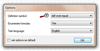

- provide choices (if possible with adjustable default settings) for
-- assignment operator (:= vs def over =)
-- equation numbering (starred or unstarred equation environment)
[DONE] (can memorize settings)
