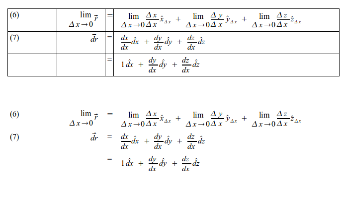

Don't know if this is relevant or how sophisticated you want to be about reformatting stuff, but this thought may be of use. MS word has a facility (as does LO) called tables. When tables are created, each area in the grid is like a mini-page on its own and can be formatted independently of all the others. To align equations, make a 4 column table, put the equals sign (=) in the third column, and narrow the column width to the minimum needed to leave the equals sign visible. Then place equation numbers in the first column, and the LHS and RHS expressions in the second and far right columns. Align the LHS to the right and the RHS to the left. All equals signs and RHS expressions to follow on subsequent lines will be aligned properly.
In the LO file below, tables are used with mathml formula objects in the second and far right columns. Text is used in the first and third columns. This table formatting works in MS office as well. I adjusted the font size of the equals sign until it looked right.
Btw, how does one make math expressions (is it latex?) in these forum posts?

Hi rising eagle, It's a good idea but quite complicated to generate undefined levels of nested equations/statements (but I've done something similare for LaTeX, where tables and formulas can be mixed easily).

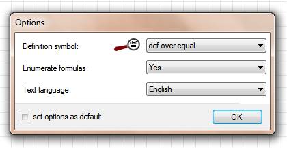

I admit that these proposals were just matter of comfort. The trade between user comfort and coding effort is of course your decision.
Perhaps, an alternative could be to have sort of template in some sensible place (somewhere in install dir or in a system user dir). The default then would be what you currently have.
I bet there is no chance to design a single template such that it works in any language environment. In my case, the german umlauts fail to compile, even if I use my input- and fontencoding from the handbook source. Perhaps there is just too much side effects and dependencies between the packages (I never used some of the ones in the latex export).
However, this feature is of course much lower on my wish list than the automatic area region to file export feature (much desired for automated doc/handbook updates with new program versions).
Martin
#51 Опубликовано: 27.01.2013 15:00:06
As for languages issues, my idea was to export the worksheet as a XeLaTeX document with XITS Math fonts and Linux Libertine fonts... it supports accented letters, german umlauts and cyrillic script...

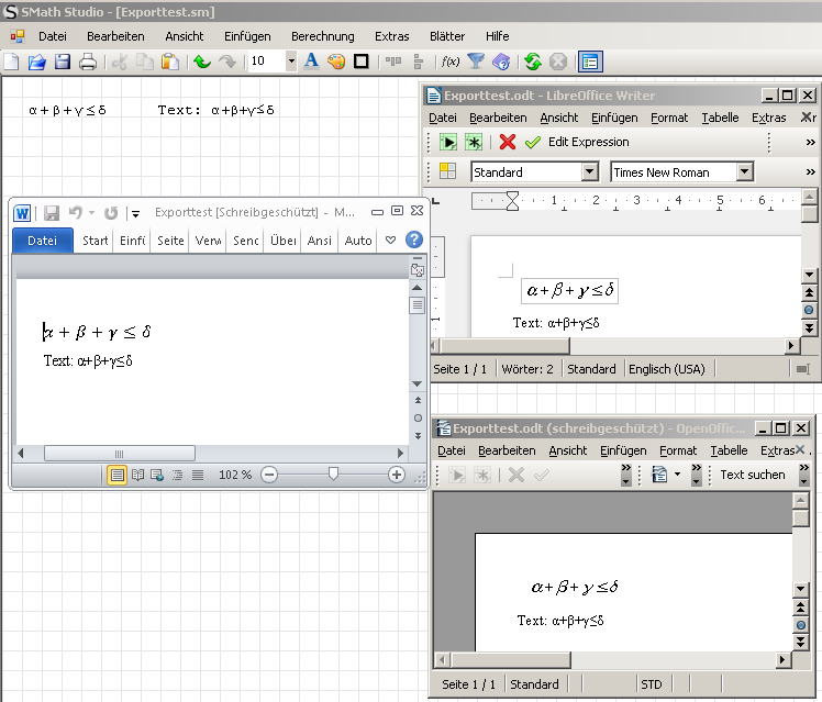

hi DC, thanx for updating plugins
try using plugins, save as ODF/ODT all symbols did not display (except for Pi) since it contains "i" at beginning symbol code in OOo math
and here's display result,
please consider, is this crucial for math? thx u
#56 Опубликовано: 28.01.2013 08:32:04
I cannot reproduce the problem, see image.

It seems like xyonx have removed the standard content of the LO/OOO Math Collection. My system gives the same for %ivartheta.
Generally I prefer to use greek characters themselves (plus usual Math decoration) and avoid using the collection names. This makes greek to look consistent with other text, no need to use special font for greek since most modern unicode fonts support it, and it enables to use several "styles" of formulas (if using collection, I would need to define a full new set for each style). Maybe it's worth it to use unicode greek char codes instead of the %igreeknames?
However, there may be some pitfalls that I haven't met at my setup...

i'm not really understand but it's look like the %i.. code required to emphasize italic font in math formula
just asking why the ODF/ODT standard did not consistent in displaying formula content?
#59 Опубликовано: 28.01.2013 17:12:56

Sorry for bothering you again with a matter of comfort
Martin
Yes, it's possible... [DONE]
- provide choices (if possible with adjustable default settings) for
-- assignment operator (:= vs def over =)
-- equation numbering (starred or unstarred equation environment)
[DONE] (can memorize settings)
