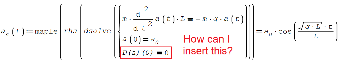

#2 Posted: 2023/12/5 13:38:18
1,554 likes in 1,864 posts.
Ctrl+Shift+K.

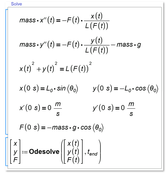

Can we solve this task with SMath + Mathcad
#4 Posted: 2023/12/6 00:05:11
Можно попробовать, если будет доступен оригинальный документ Mathcad.
Pendulum-Spring.xmcd (159.03 KiB) downloaded 1266 time(s).
#6 Posted: 2023/12/6 03:09:08
1,355 likes in 2,271 posts.
The definition of l(t) must be inside or above the Mathcad block
Federpendel-block.sm (39.22 KiB) downloaded 1277 time(s).

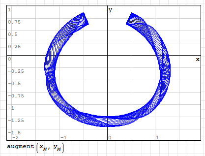

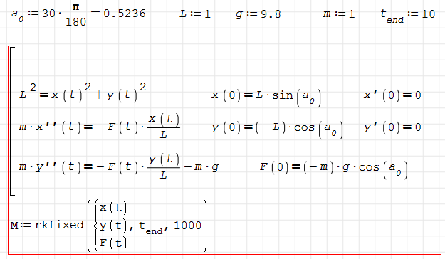

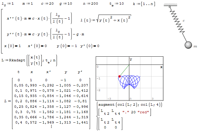

#9 Posted: 2023/12/6 07:57:07
Simple pendulum + animation.
ODE Pendulum Copy.sm (103.31 KiB) downloaded 1280 time(s).

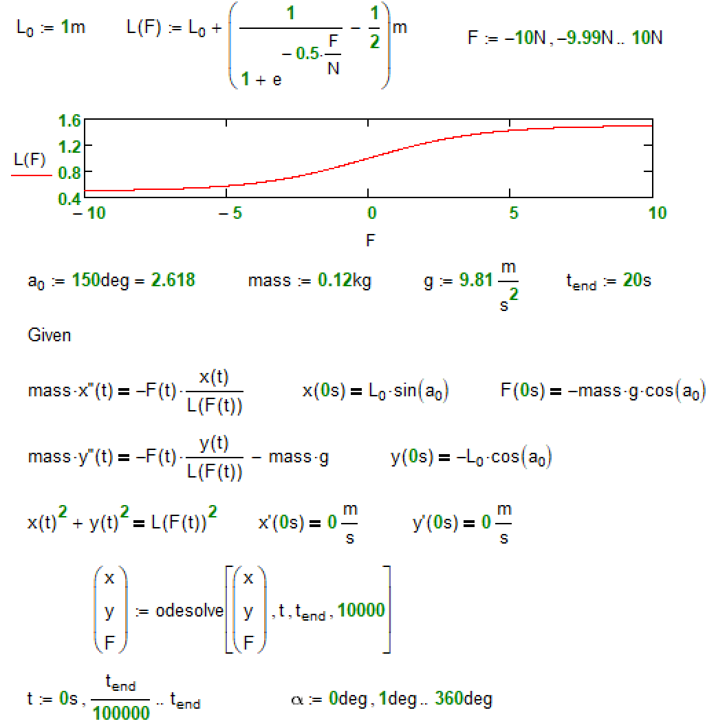

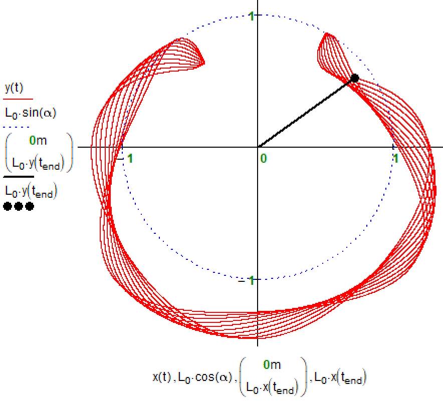

#10 Posted: 2023/12/6 12:49:26
1,123 likes in 1,795 posts.
Comparing with the usual elastic pendulum.
Click to enlarge
Ochkov elastic pendulum.sm (32.17 KiB) downloaded 1249 time(s).

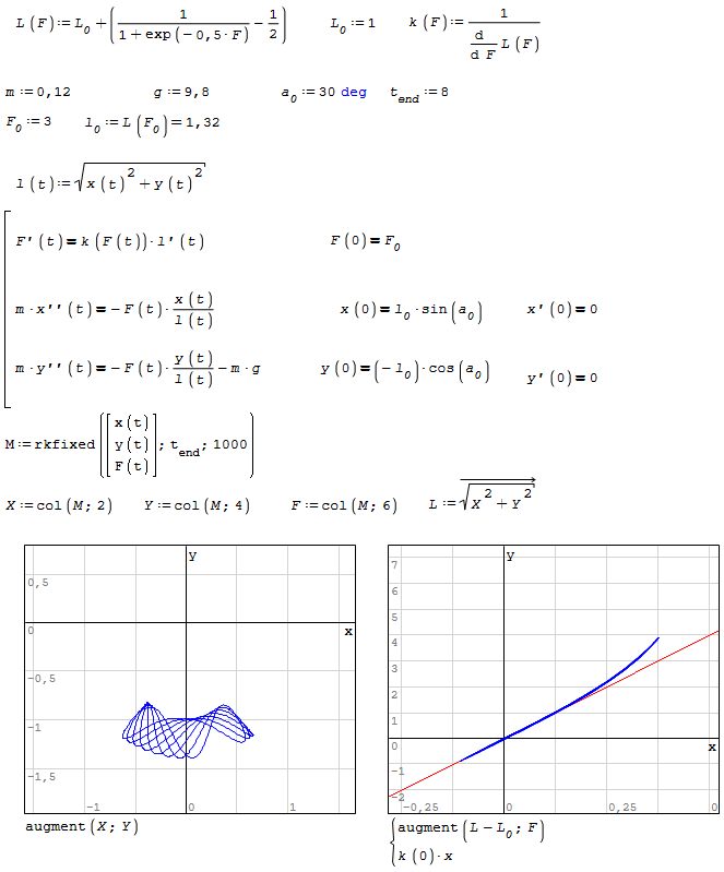

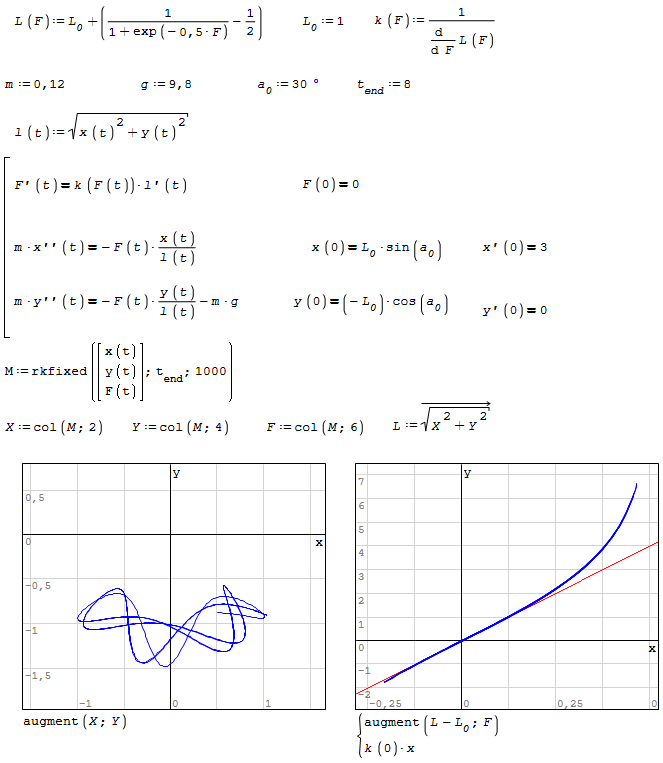

#14 Posted: 2023/12/7 06:47:42
If F(t) is requested as result, you have to specify F'(t). k(F) is the tangential stiffness of the spring, the inverse of the tangential compliance.
Federpendel-NL.sm (13.71 KiB) downloaded 1273 time(s).

#16 Posted: 2023/12/7 15:59:36
In this version you can specify the initial force in the spring. The initial conditions for x and y are adjusted appropriately.
Federpendel-NL.sm (15.06 KiB) downloaded 1299 time(s).

#19 Posted: 2023/12/8 07:54:19
In this version you can specify the initial force in the spring. The initial conditions for x and y are adjusted appropriately. ...
A comparison between Martin's solution and that given by the equations of motion obtained from the Lagrangian. Spoiler: both give the same result.
I'd like to point out how incredibly complicated this problem actually is, and what a series of brilliant implementations Martin makes. For example, where the hell does he get the time derivative of the force on an elastic bar when he is given only the length of the bar as a function of the force? Obviously, it is not enough to apply the theorem of the derivative of the inverse function, but you also have to have a deep knowledge of the mechanics of the system to remember something called tangential stiffness, and although it uses k to represent it, we forgive it because It's German and they are well known to use their own abbreviations. Well, actually I don't know what letter to use, because I don't remember ever using that magnitude for any practical purpose, but in Spanish literature it is quite common to use k for its inverse, which is the constant that appears in Hooke's law. Or at least I think so, because the existence of elastic bodies is actually a complication, they should all be rigid better.
Another notable thing about this example is that I would like someone to please explain to me how the hell the Viacheslav plugin manages to handle l'(t) within the equations, because I honestly didn't expect it.
Federpendel-NL - Lagrangian.sm (257.87 KiB) downloaded 1400 time(s).
Valery Ochkov 2023/12/8 08:10:00, Martin Kraska 2023/12/8 15:04:00, Вячеслав Мезенцев 2023/12/8 15:35:00
