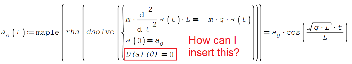

Derivative in Maple
Derivative in Maple - How insert - Messages
#1 Posted: 12/5/2023 12:53:18 PM

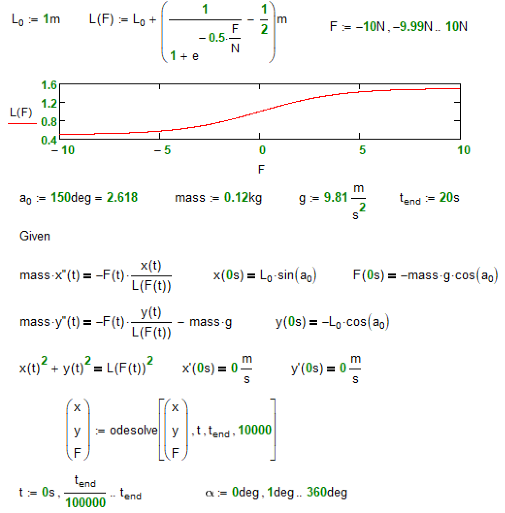

#5 Posted: 12/6/2023 12:55:01 AM
Valery Ochkov
Valery Ochkov
67 likes in 713 posts.
Можно попробовать, если будет доступен оригинальный документ Mathcad.
Pendulum-Spring.xmcd (159.03 KiB) downloaded 1490 time(s).

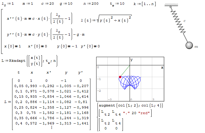

Simple pendulum + animation.
ODE Pendulum Copy.sm (103.31 KiB) downloaded 1466 time(s).

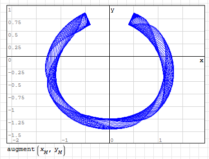

#10 Posted: 12/6/2023 12:49:26 PM
1,139 likes in 1,805 posts.
Comparing with the usual elastic pendulum.
Click to enlarge
Ochkov elastic pendulum.sm (32.17 KiB) downloaded 1429 time(s).
Вячеслав Мезенцев 12/6/2023 2:10:00 PM, Valery Ochkov 12/6/2023 2:34:00 PM

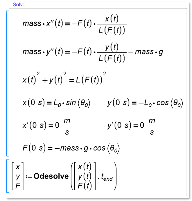

#11 Posted: 12/6/2023 2:38:55 PM
Valery Ochkov
Valery Ochkov
See please the Fig. 4.10 here
http://twt.mpei.ac.ru/ochkov/Ochkov-V-F-Engineering-Calc.pdf
Now I would like to rewrite this Russian-English book with SMath. Help me please!

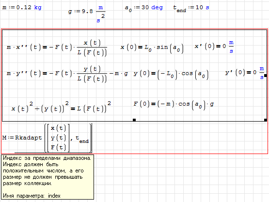

#12 Posted: 12/6/2023 8:02:42 PM
Valery Ochkov
Valery Ochkov
Why I have an error in this task? Help please!
Pund-Spring.sm (15.02 KiB) downloaded 1475 time(s).

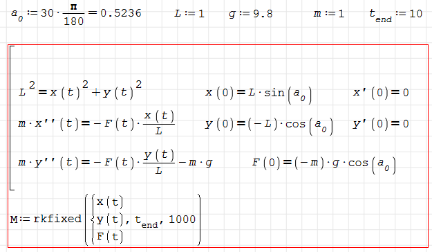

#13 Posted: 12/6/2023 9:27:58 PM
Valery Ochkov
Valery Ochkov
More simple task
Pund.sm (11.53 KiB) downloaded 1494 time(s).

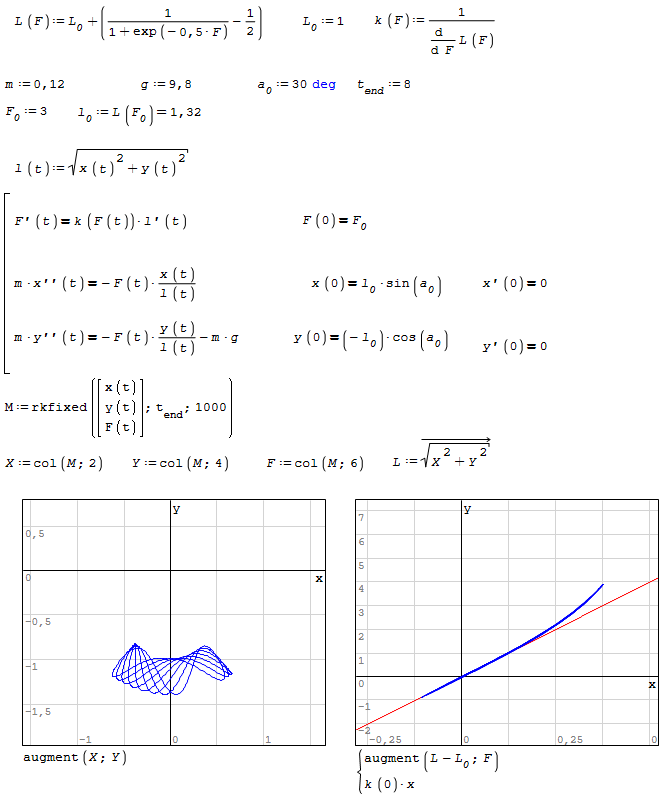

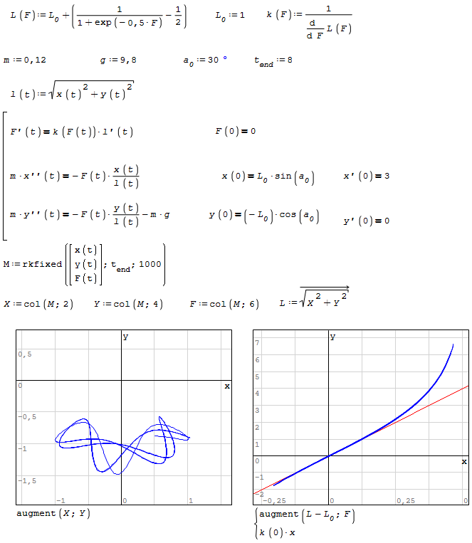

#14 Posted: 12/7/2023 6:47:42 AM
1,361 likes in 2,275 posts.
If F(t) is requested as result, you have to specify F'(t). k(F) is the tangential stiffness of the spring, the inverse of the tangential compliance.
Federpendel-NL.sm (13.71 KiB) downloaded 1472 time(s).
Valery Ochkov 12/7/2023 1:02:00 PM, Alvaro 12/7/2023 12:22:00 PM

#16 Posted: 12/7/2023 3:59:36 PM
In this version you can specify the initial force in the spring. The initial conditions for x and y are adjusted appropriately.
Federpendel-NL.sm (15.06 KiB) downloaded 1487 time(s).
Alvaro 12/8/2023 5:03:00 AM, Valery Ochkov 12/8/2023 8:11:00 AM

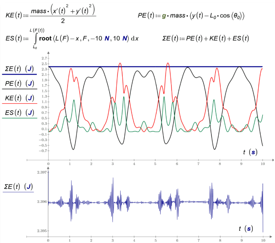

#18 Posted: 12/8/2023 5:06:15 AM
The equations of motion, using Lagrange dynamics, from this post:
ElasticPendulum.sm (244.53 KiB) downloaded 1459 time(s).
Valery Ochkov 12/8/2023 8:10:00 AM, sergio 12/8/2023 11:03:00 PM
In this version you can specify the initial force in the spring. The initial conditions for x and y are adjusted appropriately. ...
A comparison between Martin's solution and that given by the equations of motion obtained from the Lagrangian. Spoiler: both give the same result.
I'd like to point out how incredibly complicated this problem actually is, and what a series of brilliant implementations Martin makes. For example, where the hell does he get the time derivative of the force on an elastic bar when he is given only the length of the bar as a function of the force? Obviously, it is not enough to apply the theorem of the derivative of the inverse function, but you also have to have a deep knowledge of the mechanics of the system to remember something called tangential stiffness, and although it uses k to represent it, we forgive it because It's German and they are well known to use their own abbreviations. Well, actually I don't know what letter to use, because I don't remember ever using that magnitude for any practical purpose, but in Spanish literature it is quite common to use k for its inverse, which is the constant that appears in Hooke's law. Or at least I think so, because the existence of elastic bodies is actually a complication, they should all be rigid better.
Another notable thing about this example is that I would like someone to please explain to me how the hell the Viacheslav plugin manages to handle l'(t) within the equations, because I honestly didn't expect it.
Federpendel-NL - Lagrangian.sm (257.87 KiB) downloaded 1596 time(s).
Valery Ochkov 12/8/2023 8:10:00 AM, Martin Kraska 12/8/2023 3:04:00 PM, Вячеслав Мезенцев 12/8/2023 3:35:00 PM

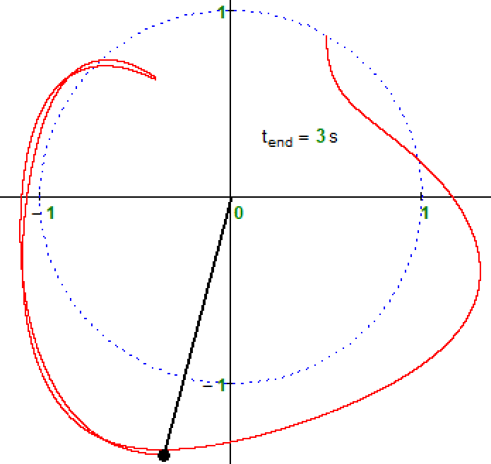

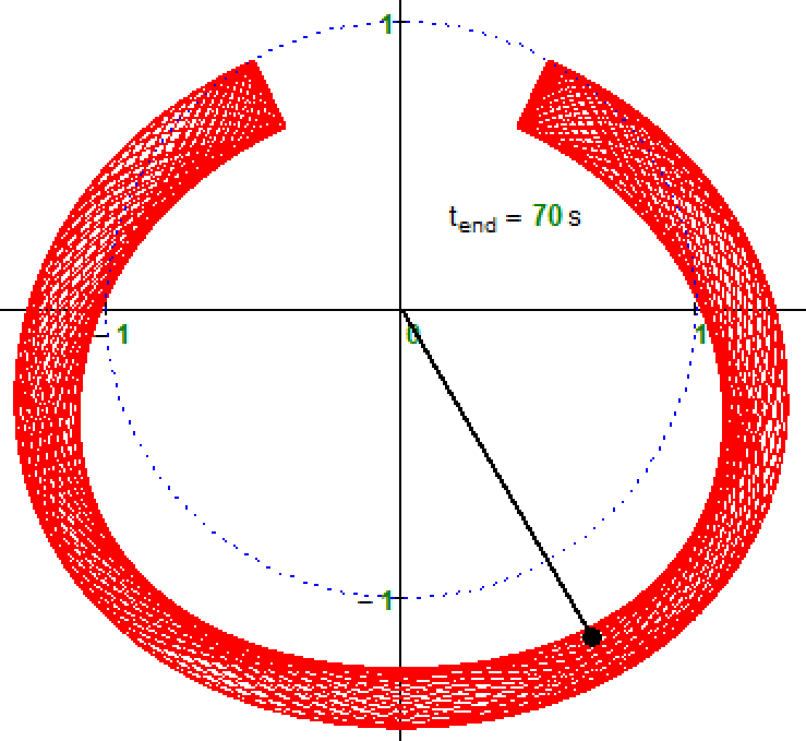

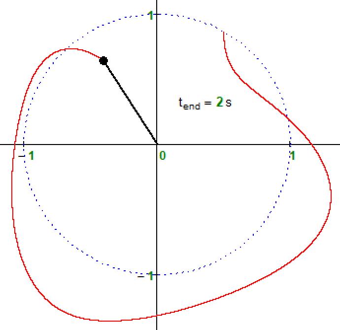

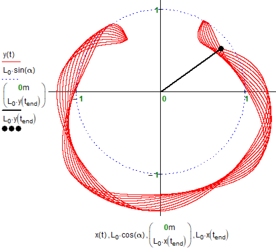

#20 Posted: 12/8/2023 1:00:10 PM
Valery Ochkov
Valery Ochkov
Have you seen this plot
