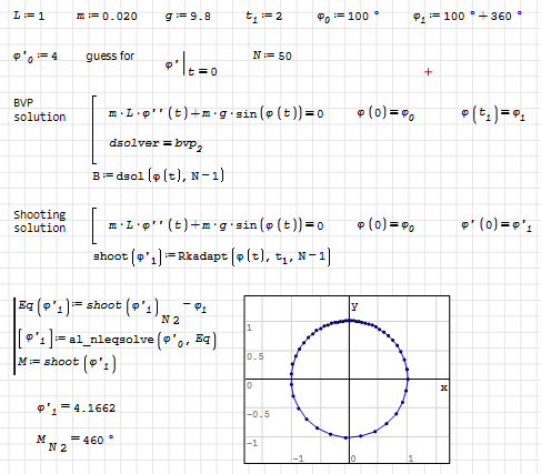

Trying to solve a boundary value problem (posed by Valery): find the required angular velocity at an given angular position such that after a given time the pendulum is at a specified angular position
Here we try to get from 100° to 100° in two seconds. It turns out that we have to give an initial velocity of approx. 4 rad/s. The pendulum approaches north pole and comes back just in time. There are infinitely many solutions, if you allow for additional full rotations before the target is reached.
Most of the time I spent on finding a way to embed the numerical solution of the nonlinear differential equation into a numerical solver.
Unfortunately most of the solvers are "special needs" solvers. It is unclear why something can be plotted but not solved. And hardly any good error message. Exception is al_nleqsolve, which gives particularly helpful messages.
Any improvements or insights welcome.
Pendel NL RWP.sm (25.26 KiB) downloaded 816 time(s).

Hi Martin. I guess that your issue is that the end angle is 460 degrees, not 100. You can also see this post.
bvp2-pend.sm (145.59 KiB) downloaded 823 time(s).
WroteHi Martin. I guess that your issue is that the end angle is 460 degrees, not 100. You can also see this post.
Thanks a lot for the hints. In fact, my issue was how to handle the problem with the other solvers. Yet, you seem to prefer al_nleqsolve(), obviously for good reason.
Your bvp-procedure is impressive, it should go to the kernel or at least to a plugin.
