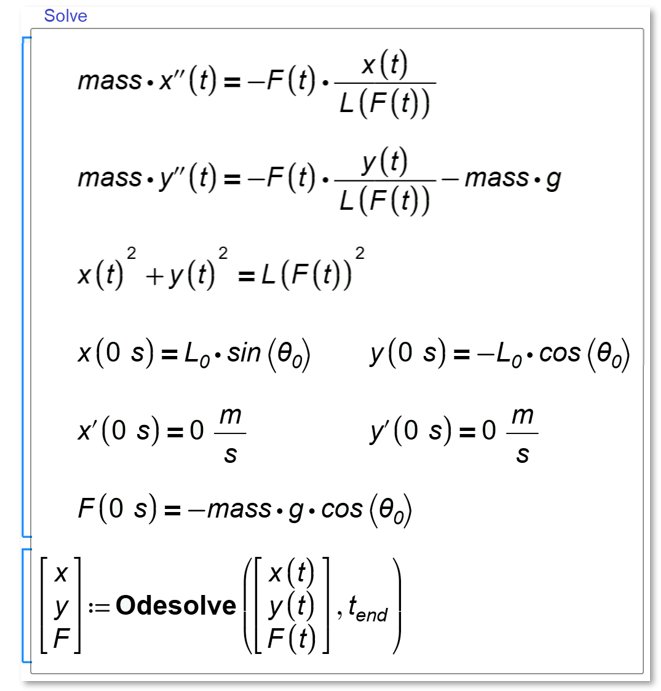

The definition of l(t) must be inside or above the Mathcad block
Federpendel-block.sm (39,22 КиБ) скачан 1462 раз(а).

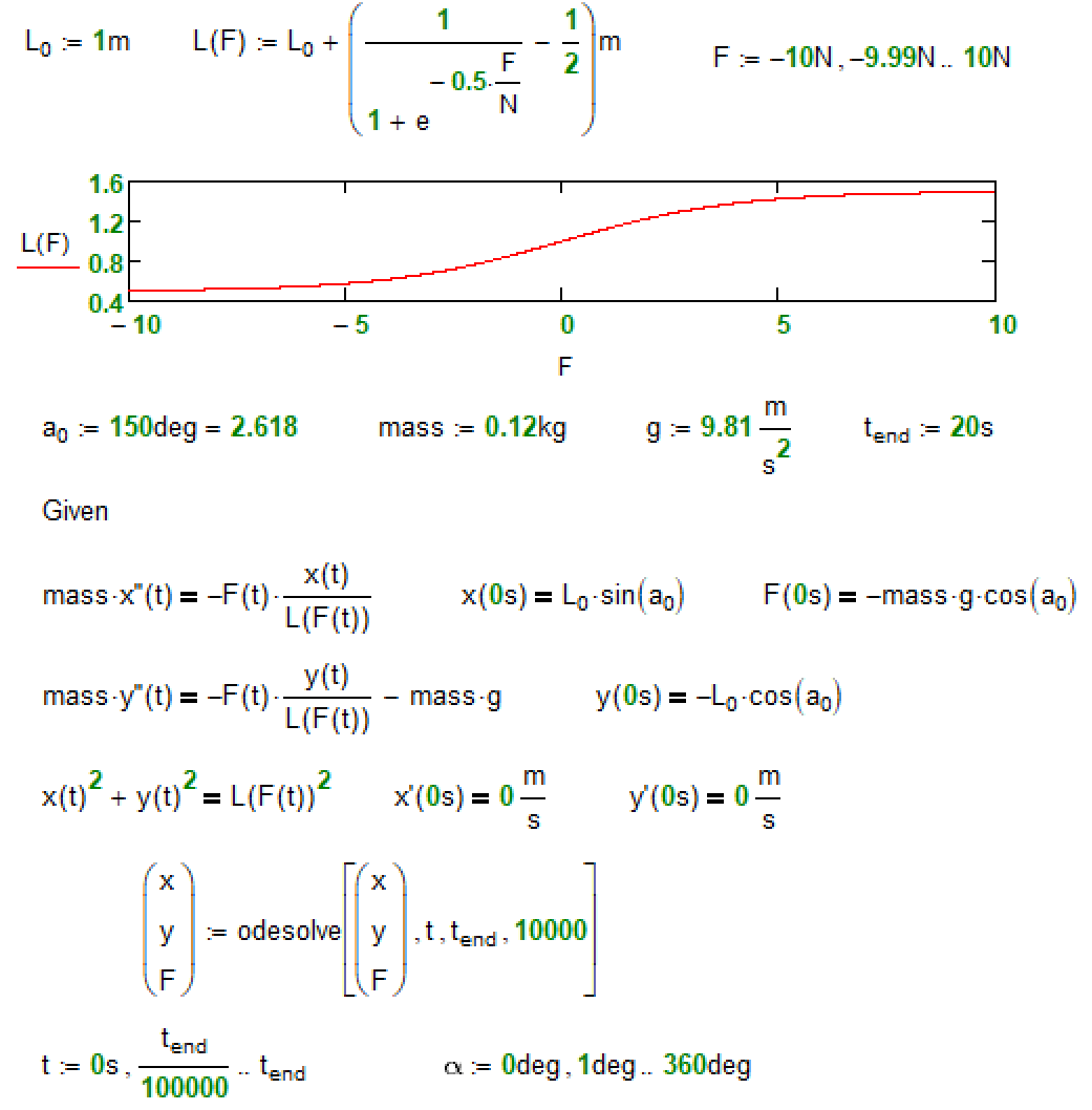

My solution
Pendulum-Spring.xmcd (82,56 КиБ) скачан 1500 раз(а).

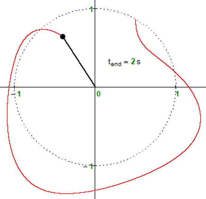

#9 Опубликовано: 06.12.2023 07:57:07
Simple pendulum + animation.
ODE Pendulum Copy.sm (103,31 КиБ) скачан 1466 раз(а).

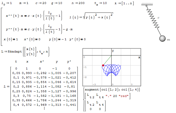

#10 Опубликовано: 06.12.2023 12:49:26
Comparing with the usual elastic pendulum.
Click to enlarge
Ochkov elastic pendulum.sm (32,17 КиБ) скачан 1429 раз(а).

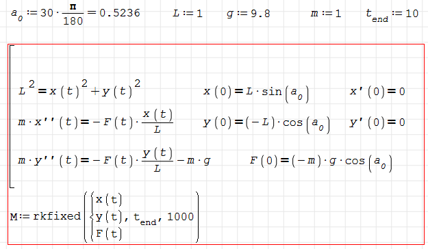

More simple task
Pund.sm (11,53 КиБ) скачан 1494 раз(а).

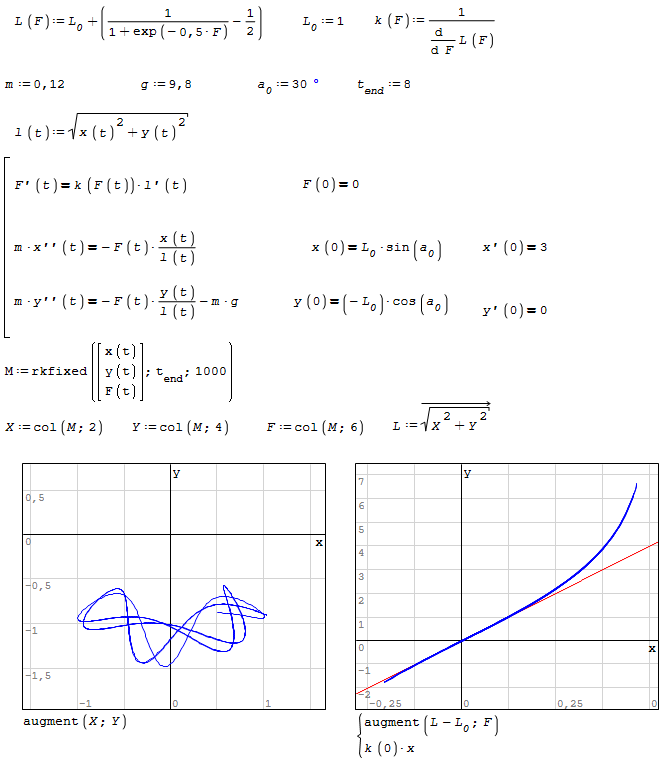

#14 Опубликовано: 07.12.2023 06:47:42

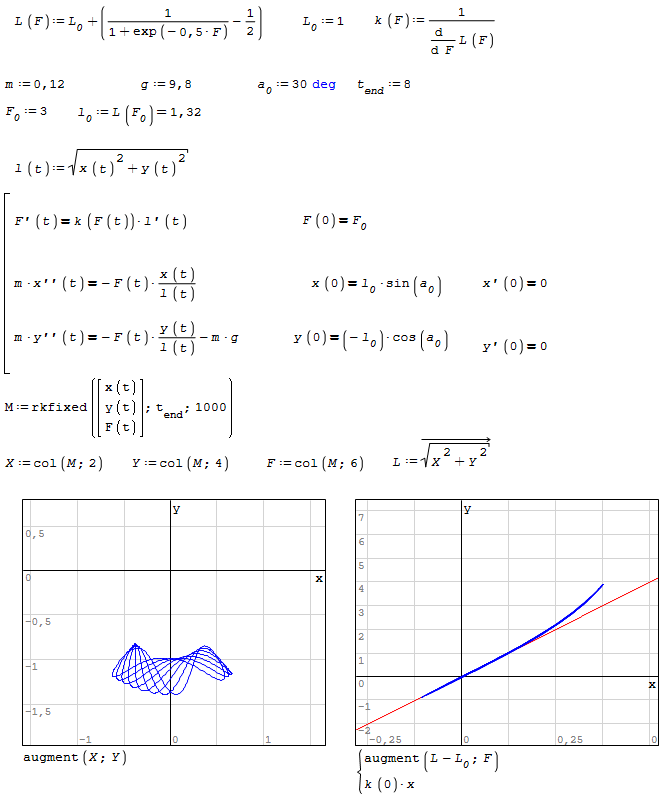

If F(t) is requested as result, you have to specify F'(t). k(F) is the tangential stiffness of the spring, the inverse of the tangential compliance.
Federpendel-NL.sm (13,71 КиБ) скачан 1472 раз(а).

#16 Опубликовано: 07.12.2023 15:59:36
In this version you can specify the initial force in the spring. The initial conditions for x and y are adjusted appropriately.
Federpendel-NL.sm (15,06 КиБ) скачан 1487 раз(а).

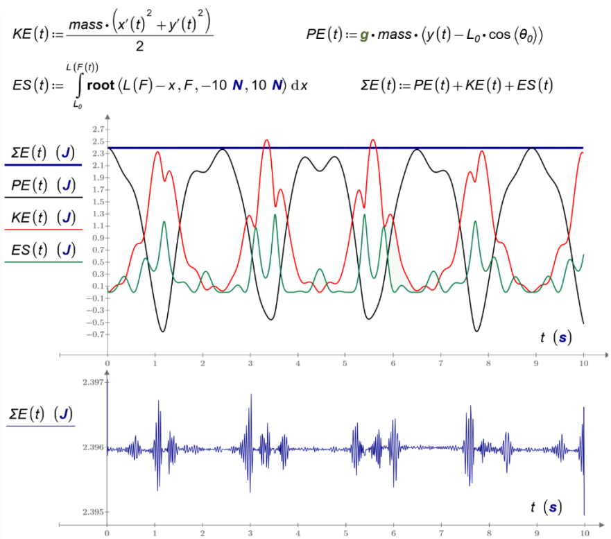

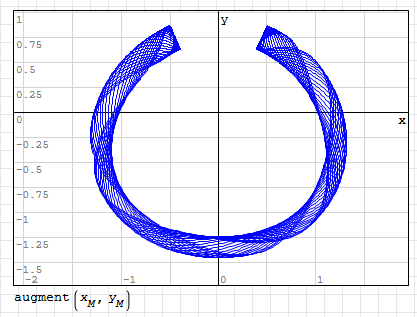

#20 Опубликовано: 08.12.2023 13:00:10
Valery Ochkov
Valery Ochkov
67 сообщений из 713 понравились пользователям.
Have you seen this plot
