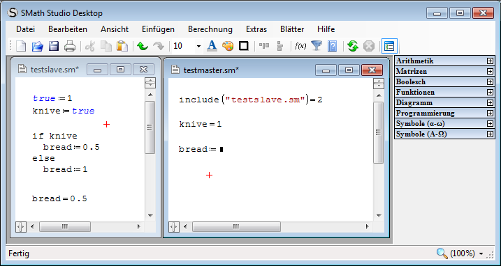

A lot of discussion has taken place here so I post my bug report here too. Or shall I use the bugtracker system instead?
Include does not work for variables defined in programming environment like if or for, see the example below, bread is not accessible in testmaster.sm
You can do this like on the picture below.

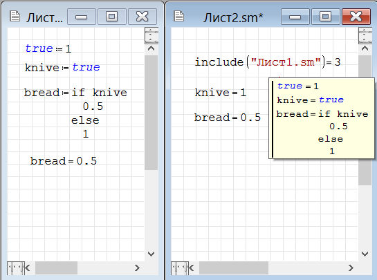

include() works with static global definitions (:=) only (static defs you can read directly from the sm-file, but for dynamic you must evaluate it first). I can't do that you want because this is too complicated. You may ask Andrey to add include() function in SMath Studio. He can do that.
