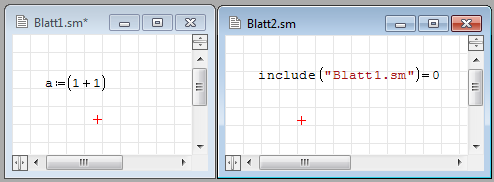

  1. open a new sheet, type a:=1
  2. save it as b.sm
  3. open another sheet, type include("b.sm" )
  4. save it as c.sm
  5. now include() should get a black frame but it remains framed red, error
  6. switch back to b.sm. Despite you have saved it and made no change, you will see an asterisk in the title bar which indicates a change. Save the file again
  7. Now switch back to c.sm and you should see a result.
This is time consuming and not logical.

This is strange behavior. Your example works fine for me. Are you using the latest version (include - 0.1.5406.38586 and SMath Studio - 0.97.5346)?

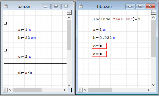

I am finally able to create a minimal example that reproduces the bug, see attachment. Include() seems not to work with brackets.
#51 Опубликовано: 28.10.2014 07:10:24
Updated. Bug fixed. Brackets now supported.

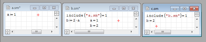

I would like to use cascading dependencies. See the attached example. In file c.sm I cannot access all the variables I have in b.sm. Nevertheless I have the influence of a.sm in c.sm through the variable b. This is strange to me. Is it a wanted behavior? Why?
Of course I could include a.sm in c.sm again. But I could also include another file d.sm in c.sm which contains a:=2. I would then end up with a=2 and b=2 despite b being defined as 2*a...
I think there are two ways of implementing this properly:
  1. You can acess all the variables like a class. I.e c:=include( "a.sm" ) ... c.a=1
  2. Or the variables are universally accessible in all files directly, resulting in a=1 in c.sm

Updated. Fixed bug with cascading dependencies.

It looks like there is a bug if you include Areas in the source file.
If your data is included in more than 2 Areas, the plugin will send only the content of the first one.

We found the problem. This issue is related to saving the file. Andrey will make the correction in the next build.
