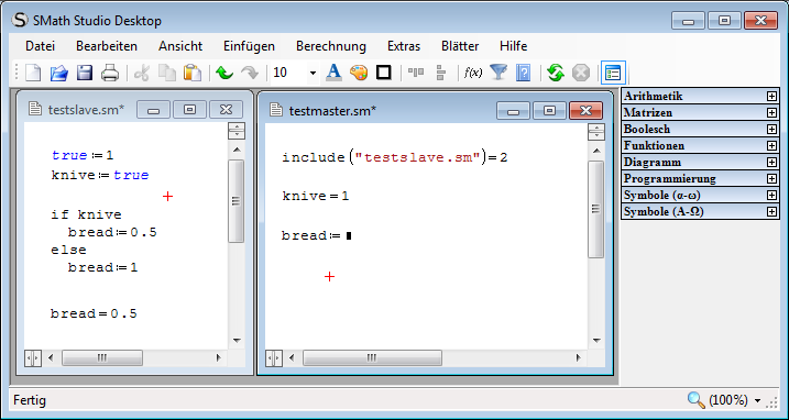

A lot of discussion has taken place here so I post my bug report here too. Or shall I use the bugtracker system instead?
Include does not work for variables defined in programming environment like if or for, see the example below, bread is not accessible in testmaster.sm

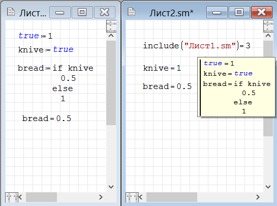

#39 Posted: 10/17/2014 4:39:18 AM
1,558 likes in 1,868 posts.
Quote
You can do this like on the picture below.
include() works with static global definitions (:=) only (static defs you can read directly from the sm-file, but for dynamic you must evaluate it first). I can't do that you want because this is too complicated. You may ask Andrey to add include() function in SMath Studio. He can do that.

#40 Posted: 10/17/2014 10:18:25 AM
brotjob
brotjob
7 likes in 71 posts.
This is a very elegant way for the above example. Thanks for showing me this. In cases where you have complex conditions and you want to define many variables in if statements it would not work. Also it does not work for loops for, while. That's why I will ask Andrey to implement this.
see feature request To implement an include() function able to handle dynamic definitions. Please vote!
