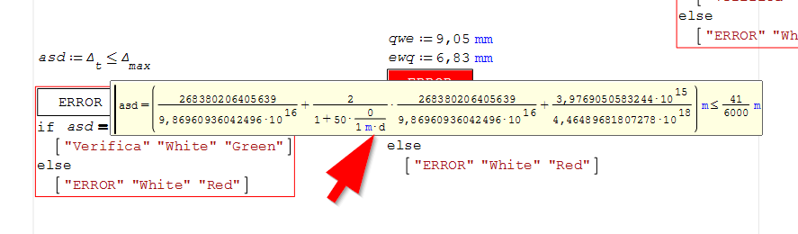

#85 Posted: 2023/1/17 11:20:05
1,443 likes in 2,935 posts.
If you hover over the asd definition you can see that there is an unsolved "d" dependancy that triggers the error.
The same happens if you try to force a numerical evaluation using eval()
#86 Posted: 2023/1/17 12:05:21
German
German
0 likes in 8 posts.
That is it!
As allways thanks!!
But still don't understand why Jean files fails.

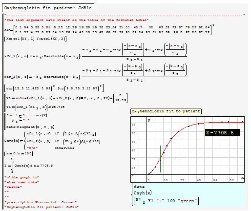

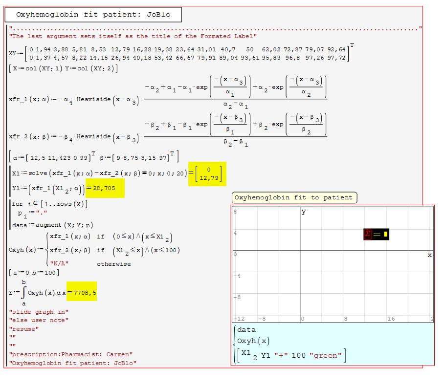

#87 Posted: 2023/1/17 12:12:05
SMath Studio Desktop 64-bit
Version: 1.0(build: 8348)
Date: 9/11/2022
Slide left the Formatted Label
Side right the graph, remove the Σ no definido
You should see the plot.
#88 Posted: 2023/1/17 12:15:52
That is it!
As allways thanks!!
You're welcome!
There is an excel data import at the begin of the file, is not related to the issue however so it doesn't matter. nevermind I was looking at your file.
If you remove the 3 inline evaluations it will work.
2023-01-17 16_28_05-SMath Solver - [Image Formated LABEL [Oxyhemoglobin] FORUM.sm].png
#89 Posted: 2023/1/17 12:39:57
German
German
0 likes in 8 posts.
My file can be an example of things NOT to do.

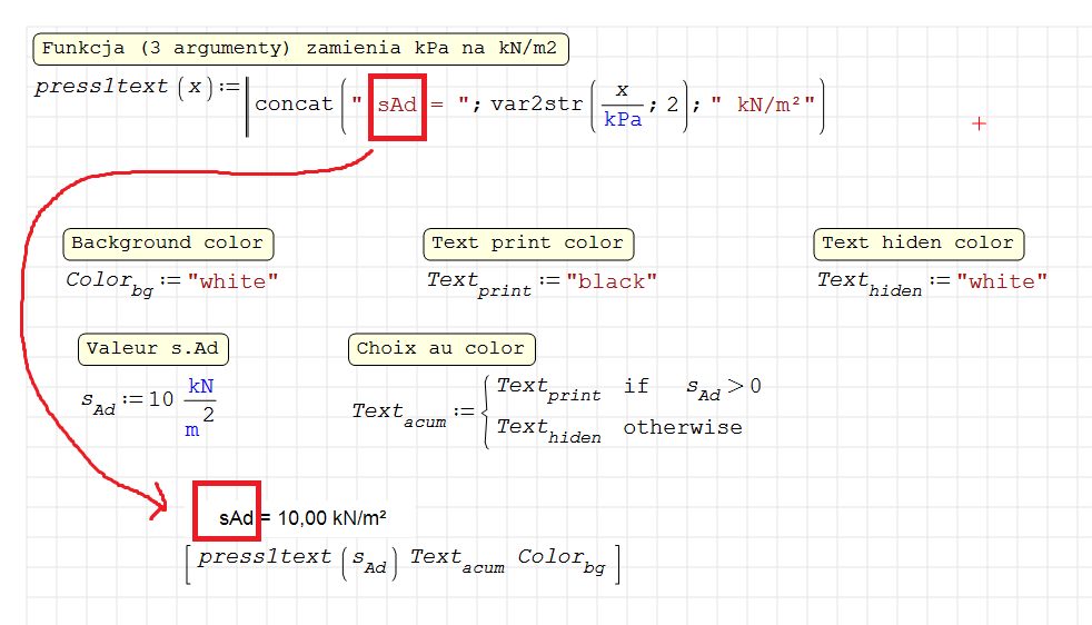

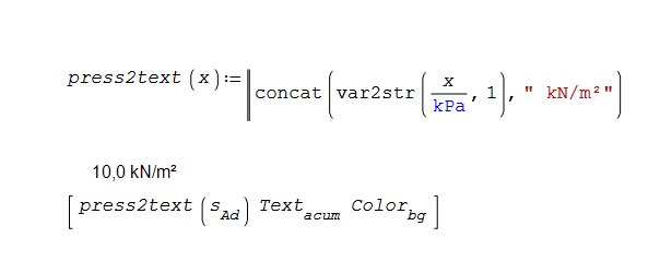

Can we manage the units that are displayed?
I have a load in kN/m2 and the result appears as kg/(m*s2).
The idea is to present only positive values (with the appropriate unit).
kind regards

#91 Posted: 2023/10/14 23:52:58
The easier way might be something like this
2023-10-14 18_53_23-SMath Solver - [Conditionally Formatted Labels_unity.sm_].png
press2text(x):line(concat(var2str(x/'kPa,1),"\0020\kN\002F\m\00B2\",1,1)

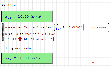

I'm looking for a way to represent the letter D as a subscript
You can subscribe whatever.
mysystem dot HelloGrandMa
#95 Posted: 2023/10/17 01:32:30
Rogalski
Rogalski
0 likes in 7 posts.
thanks for the information, but I'm not sure if I expressed myself correctly. I mean the subscripts in the "phrases" that I marked in the drawing.
Davide sent the function shown above in which I need to use subscripts.
#96 Posted: 2023/10/17 02:13:46
Oscar Campo
Oscar Campo
135 likes in 309 posts.
Davide used superscript unicode character for write: "kN\002F\m\00B2\" wich renders as "kN/m²" so, you can use unicode characters...but not all characters have subscript version.
Please check here: https://www.compart.com/en/unicode/search?q=subscript#characters
Oscar
#97 Posted: 2023/10/17 13:30:37
1,123 likes in 1,795 posts.
Hi Karol. This could be a workaround, using the SMath Plot region.
label.sm (6.22 KiB) downloaded 1649 time(s).
Oscar Campo 2023/10/17 16:52:00
