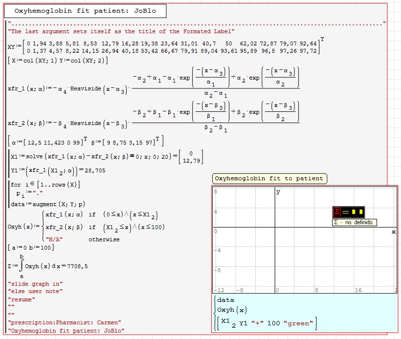

Here it is.
losa-forum.sm (862,11 КиБ) скачан 1920 раз(а).
Sorry Jean but i don't understand what i'm supposed to see. I also get "data - not defined".

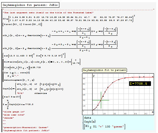

#83 Опубликовано: 17.01.2023 10:55:42
Here it is.
Document does not open ... incorrect format

#85 Опубликовано: 17.01.2023 11:20:05

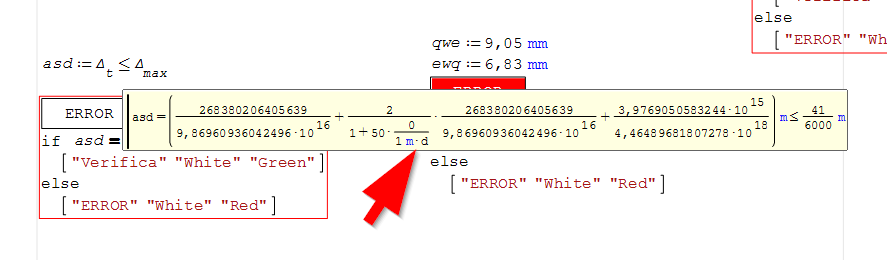

If you hover over the asd definition you can see that there is an unsolved "d" dependancy that triggers the error.
The same happens if you try to force a numerical evaluation using eval()
That is it!
As allways thanks!!
But still don't understand why Jean files fails.
#87 Опубликовано: 17.01.2023 12:12:05
SMath Studio Desktop 64-bit
Version: 1.0(build: 8348)
Date: 9/11/2022

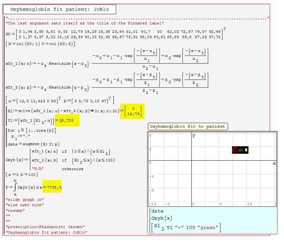

Slide left the Formatted Label
Side right the graph, remove the Σ no definido
You should see the plot.
#88 Опубликовано: 17.01.2023 12:15:52
That is it!
As allways thanks!!
You're welcome!
There is an excel data import at the begin of the file, is not related to the issue however so it doesn't matter. nevermind I was looking at your file.
If you remove the 3 inline evaluations it will work.
2023-01-17 16_28_05-SMath Solver - [Image Formated LABEL [Oxyhemoglobin] FORUM.sm].png
#89 Опубликовано: 17.01.2023 12:39:57
German
German
My file can be an example of things NOT to do.

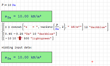

Can we manage the units that are displayed?
I have a load in kN/m2 and the result appears as kg/(m*s2).
The idea is to present only positive values (with the appropriate unit).
kind regards

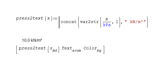

The easier way might be something like this
2023-10-14 18_53_23-SMath Solver - [Conditionally Formatted Labels_unity.sm_].png
press2text(x):line(concat(var2str(x/'kPa,1),"\0020\kN\002F\m\00B2\",1,1)

Thank you very much.
This is exactly what I needed.

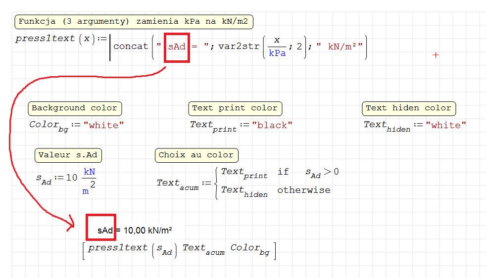

I'm looking for a way to represent the letter D as a subscript. Unfortunately, Unicode doesn't seem to provide this option...
Is there any possibility to parameterize individual characters that will be presented?

thanks for the information, but I'm not sure if I expressed myself correctly. I mean the subscripts in the "phrases" that I marked in the drawing.
Davide sent the function shown above in which I need to use subscripts.

Davide used superscript unicode character for write: "kN\002F\m\00B2\" wich renders as "kN/m²" so, you can use unicode characters...but not all characters have subscript version.
Please check here: https://www.compart.com/en/unicode/search?q=subscript#characters
