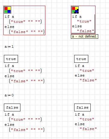

The new version disabled the feature if a ("true" "" "") ("false" "" "") I thought this is practical, why remove it? Now I have to use if a>0 ...
Also, when I modify a sheet that was created with an older version of the plugin that uses the old style syntax and I adopt it to the new syntax, Smath Studio crashes. I will try without automatic recalculation now but my data is lost.
#31 Posted: 2014/9/26 03:26:38
1,443 likes in 2,935 posts.
Hello brotjob,
I cannot reproduce (or I've misinterpreted the issue)
I see what is shown in the screenshot

First of all it's nice that you don't need the matrices anymore. Is there some kind of documentation of the plugin?
I tried your above left example in a new worksheet->works perfectly. I change a to 1m ->label becomes red. I change if a to if a>0 ->smath crashes
#33 Posted: 2014/9/26 07:42:31
Is a recent feature
The official documentation is attached in the first post, moreover the Activebook of Martin Kraska contains a section for this plugin. Both should be updated, I'll do ASAP.
This is because the if statement doesn't support units as result of the condition argument. This is not in my hands.
I can't reproduce this issue, I'll investigate...
