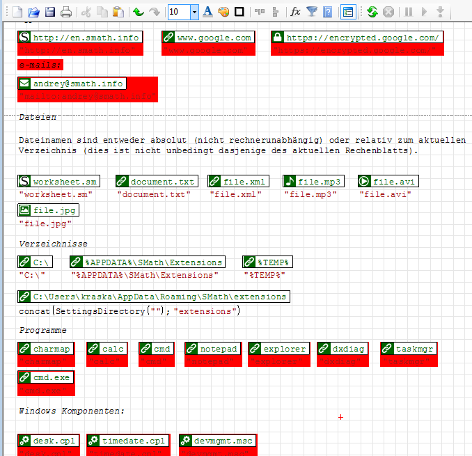

Davide, I experience strange problems with hyperlinks with SMath 0.98.6179 and a fresh hyperlink region plugin.
The links in your docs (from post #1) work fine.
If I copy them to my handbook page, I get "System can't find the file" messages for the links marked with red background, both documents in the same instance of SMath. No matter if portable or installed distribution...
There must be something wrong with my document...

#43 Опубликовано: 02.01.2017 12:35:03
Try now, it should be fixed.

#44 Опубликовано: 02.01.2017 13:10:41
Confired, thank you.
BTW, due to the current plugin loading policy (long startup time), I'd prefer links to smath files being opened in the currently running instance.
For the interactive handbook, the writer region can't be used by this reason (also, because you need to activate the region before you can click links, i.e. thus doubling the required clicks).
