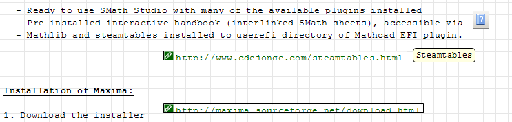

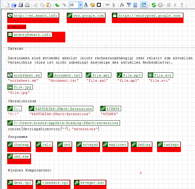

Davide, I experience strange problems with hyperlinks with SMath 0.98.6179 and a fresh hyperlink region plugin.
The links in your docs (from post #1) work fine.
If I copy them to my handbook page, I get "System can't find the file" messages for the links marked with red background, both documents in the same instance of SMath. No matter if portable or installed distribution...
There must be something wrong with my document...
Try now, it should be fixed.
