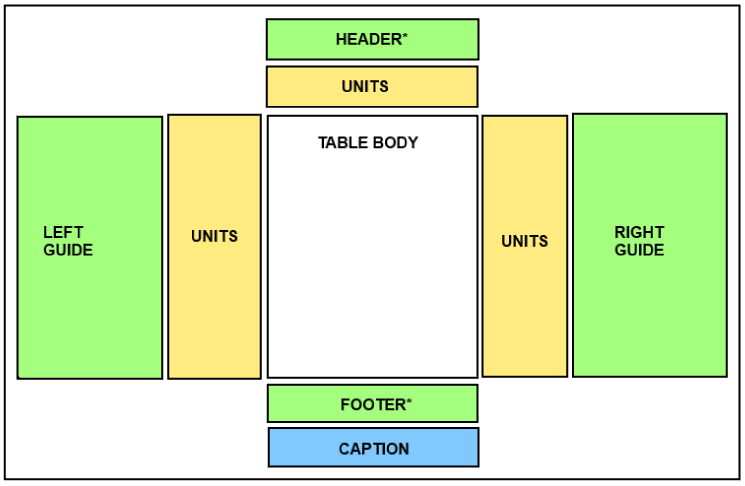

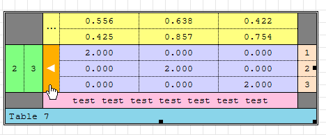

Is a region that show a SMath Studio numerical variable as written in a table; basically is an image, the look is customizable using the context menu (a cell editor like excel is too complicated to make for me); as for now there's only the body, I'll try to add other things (those shown in the dialog above and schematized below (colored boxes are all "optionals", as general idea); the hardest thing will be surely unit's handling ...

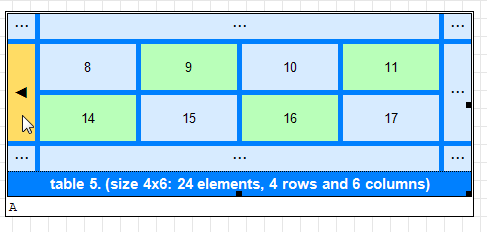

By the way, I did not figure out if there is a default table size. For instance, if the table is 30x30 then not to presented it in full size in the first place, in order to shrink it then for the presentation in the worksheet - but to represent only say 10x10 first rows and columns.

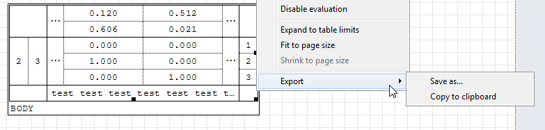

As for now the default size is the entire table (this is driven by the change of the data size - rows or columns); I've thinked to add an optional restriction on the page size but actually it's not easy (the plugin code need some improvements); your idea seems much more easy to implement
