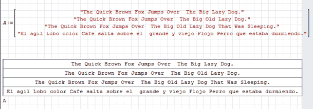

Thanks for the work with this plugin, it has proven to be a very useful and much needed feature.
I am however having one small issue. My table displays fine within SMath, but when I print, depending on how many characters there are, the table cuts off.
This is only when I print.
Is there something in the settings I am missing?
All settings are default in the attached example.
Thank you!
Confirmed. Unfortunately string scaling is driven internally by the .NET framework (here the ssue is how letters are spaced), so there aren't easy fixes. I'll think if I can do something however, thank you for reporting.

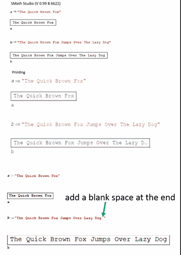

#84 Posted: 10/25/2018 8:13:30 PM
CBG
CBG
78 likes in 312 posts.
adding a blank space at the end of the sentence solves the problem
Carlos

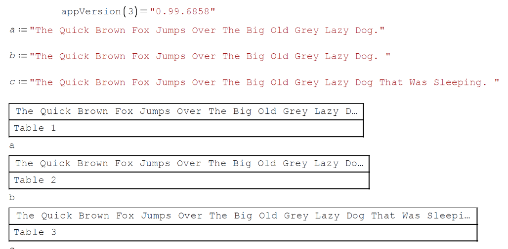

#85 Posted: 10/25/2018 8:34:44 PM
26 likes in 155 posts.
Carlos,
I wish it where that easy. Unfortunately, as previously discussed, as the number of characters increases, the more blank spaces you need to add in order to display the full text. In my particular situation, I am dealing with thousands of different lengths, having to figure out exactly how many spaces to add to the end hardly seems like a "solution," but rather a work around... which was also previously discussed.
Here is an example of what I mean. "a" has no space, while both "b" and "c" have each one space. As you can see "b" has 3 missing characters counting the blank space on the end, while "c" has 4 missing characters.
Perhaps there can be a way of counting the characters in a string and then having some concatenating function add the spaces automatically depending on the length?? Just a thought...

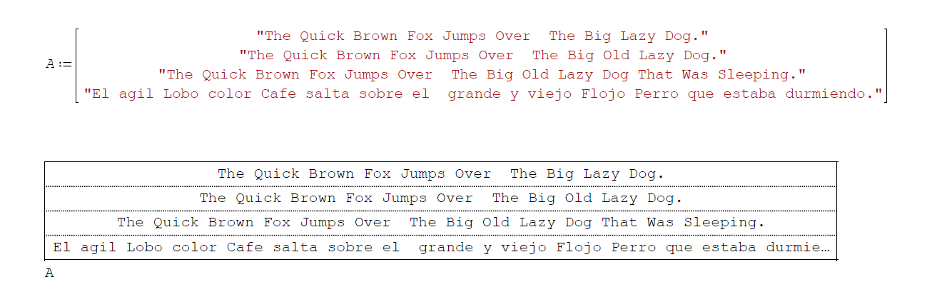

#90 Posted: 10/25/2018 11:33:18 PM
Thank you!
Carlos,
My original post describes my objective, but maybe it wasn't very clear? Typically I read through an entire topic so that I know what is going on, but that's just me. Not trying to be rude in any way, it just seems like I'm beating a broken drum when I have to explain the issue to every poster.
As you can see below in your example, when I PRINT, the table is cut off. All i did was download your sample and print it. As Davide said, this was an issue with the .NET framework. In any case, I appreciate the efforts to help. Thank you all very much. Hopefully Davide can eventually come up with something. In the mean time, I have used the concat() function to automatically add 4 spaces to any string i wish to display in a table. 4 spaces (as shown in a previous post) seems to cover most any length I will use.

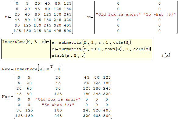

Hi, Davide!
I'm trying to use UNICODE symbols in tables, but they just don't work. I get \numbers\ instead of the actual symbol.
Is there another comprehensible set of symbols I could use inside this region?
Thanks!

Is there another comprehensible set of symbols I could use inside this region ?
In the mean time: from Win Charmap.
sergio 8/24/2020 9:48:00 AM
