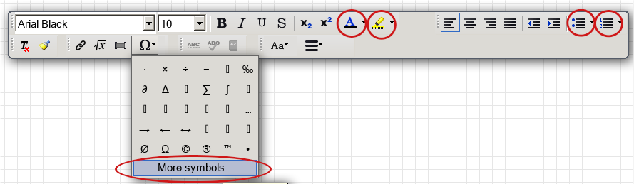

Circled buttons force crash smath on linux.
Bug occurs if I click on little triangles next to items.
I don't know if every linux distro has this bug.

I remember that was tested in Mint and Ubuntu...
If you start the program from Terminal you are able to collect some more info about the exceptions?

This is the error message:
