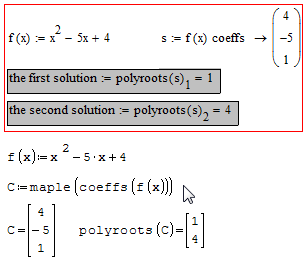

Thank you Jean Giraud for the indications of solving the second degree polynomial equation. But the issue that bothers me is that of variable assignment: "the first solution" & "the second solution". So how do this assignment in SMath?

You can only without spaces in the variable name

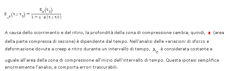

Lately I have encountered the following problem. When a previously saved file is reopened without any apparent inconvenience, some Math objects appear lost (in their place the red square). Everything seems random because other math objects in the same file and in the same wrirer region are correct. Does it happen to you too?
Smath Ver 0.99 build 6671 on Win7 64bit
Davide Carpi 2018/8/22 07:20:00
#98 Posted: 2018/8/22 07:19:50
1,443 likes in 2,935 posts.
Reproduced, thank you Sergio (problem appears to be about the serialization of subscripts).
