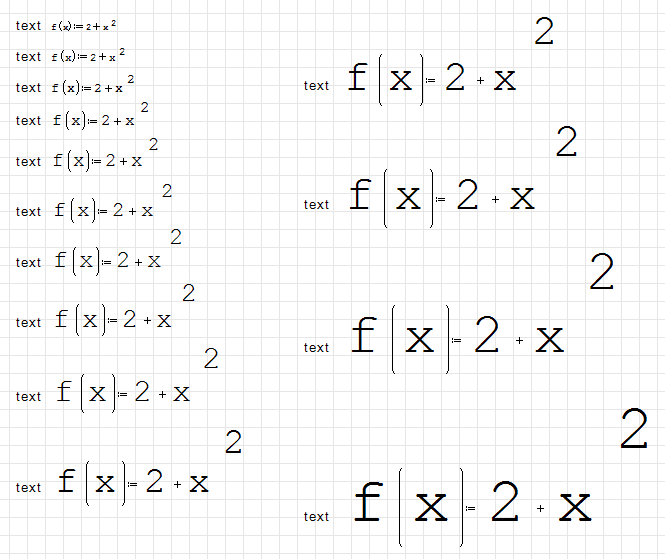

Is there any way to make the writer region line up horizontally with a math region?
What is a "writer region" ???
#52 Posted: 2016/5/2 18:47:08
... you may have noticed in "Courrier" [Smath default font]
capitals have same height than numbers, thus text align horizontally.
A region to have rich text in the worksheet
Show Spoiler
Yes I know. Unfortunately .NET doesn't help at all in precise text measuring, and math regions are based on the parameter "middle line" (that is wonderful in math regions, close to magic, but doesn't helps here). As for now, I've solved with the dumb way... I've measured the distances with Paint.NET, tabulated the results, provided the scaling for different DPI settings (this affects only the mutual vertical alignment between the two regions, if requested from the user, or the math alignment inside the region itself, if math regions are used inside the writer region).
Show Spoiler
