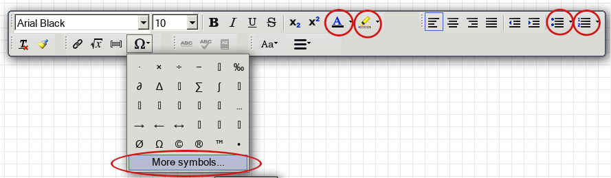

Circled buttons force crash smath on linux.
Bug occurs if I click on little triangles next to items.
I don't know if every linux distro has this bug.
#124 Posted: 11/17/2021 8:30:09 AM
1,443 likes in 2,936 posts.
I remember that was tested in Mint and Ubuntu...
If you start the program from Terminal you are able to collect some more info about the exceptions?
#125 Posted: 11/17/2021 8:43:48 AM
600 likes in 1,381 posts.
This is the error message:

[smath]$ System.NullReferenceException: Object reference not set to an instance of an object
  at System.Windows.Forms.ToolStripSplitStackLayout.LayoutVerticalToolStrip (System.Windows.Forms.ToolStrip ts, System.Drawing.Rectangle bounds) [0x0015d] in <391b318e46af443ab4360466631816f9>:0
  at System.Windows.Forms.ToolStripSplitStackLayout.Layout (System.Object container, System.Windows.Forms.LayoutEventArgs args) [0x0003b] in <391b318e46af443ab4360466631816f9>:0
  at System.Windows.Forms.Control.OnLayout (System.Windows.Forms.LayoutEventArgs levent) [0x0002e] in <391b318e46af443ab4360466631816f9>:0
  at System.Windows.Forms.ScrollableControl.OnLayout (System.Windows.Forms.LayoutEventArgs levent) [0x00013] in <391b318e46af443ab4360466631816f9>:0
  at System.Windows.Forms.ToolStrip.OnLayout (System.Windows.Forms.LayoutEventArgs e) [0x00000] in <391b318e46af443ab4360466631816f9>:0
  at System.Windows.Forms.ToolStripDropDown.OnLayout (System.Windows.Forms.LayoutEventArgs e) [0x00019] in <391b318e46af443ab4360466631816f9>:0
  at System.Windows.Forms.Control.PerformLayout (System.ComponentModel.IComponent affectedComponent, System.String affectedProperty) [0x0004c] in <391b318e46af443ab4360466631816f9>:0
  at System.Windows.Forms.Control.PerformLayout (System.Windows.Forms.Control affectedControl, System.String affectedProperty) [0x00019] in <391b318e46af443ab4360466631816f9>:0
  at System.Windows.Forms.ScrollableControl.OnVisibleChanged (System.EventArgs e) [0x0000e] in <391b318e46af443ab4360466631816f9>:0
  at System.Windows.Forms.ToolStrip.OnVisibleChanged (System.EventArgs e) [0x0000f] in <391b318e46af443ab4360466631816f9>:0
  at System.Windows.Forms.ToolStripDropDown.OnVisibleChanged (System.EventArgs e) [0x00000] in <391b318e46af443ab4360466631816f9>:0
  at System.Windows.Forms.Control.SetVisibleCore (System.Boolean value) [0x0018f] in <391b318e46af443ab4360466631816f9>:0
  at System.Windows.Forms.ToolStrip.SetVisibleCore (System.Boolean visible) [0x00000] in <391b318e46af443ab4360466631816f9>:0
  at System.Windows.Forms.ToolStripDropDown.SetVisibleCore (System.Boolean visible) [0x00000] in <391b318e46af443ab4360466631816f9>:0
  at System.Windows.Forms.Control.set_Visible (System.Boolean value) [0x00009] in <391b318e46af443ab4360466631816f9>:0
  at System.Windows.Forms.Control.Show () [0x00000] in <391b318e46af443ab4360466631816f9>:0
  at System.Windows.Forms.ToolStripDropDown.Show (System.Drawing.Point position, System.Windows.Forms.ToolStripDropDownDirection direction) [0x00367] in <391b318e46af443ab4360466631816f9>:0
  at System.Windows.Forms.ToolStripDropDown.Show (System.Drawing.Point screenLocation) [0x0000f] in <391b318e46af443ab4360466631816f9>:0
  at (wrapper remoting-invoke-with-check) System.Windows.Forms.ToolStripDropDown.Show(System.Drawing.Point)
  at System.Windows.Forms.ToolStripDropDownItem.ShowDropDown () [0x00034] in <391b318e46af443ab4360466631816f9>:0
  at System.Windows.Forms.ToolStripSplitButton.OnMouseDown (System.Windows.Forms.MouseEventArgs e) [0x00057] in <391b318e46af443ab4360466631816f9>:0
  at System.Windows.Forms.ToolStripItem.FireEvent (System.EventArgs e, System.Windows.Forms.ToolStripItemEventType met) [0x00067] in <391b318e46af443ab4360466631816f9>:0
  at (wrapper remoting-invoke-with-check) System.Windows.Forms.ToolStripItem.FireEvent(System.EventArgs,System.Windows.Forms.ToolStripItemEventType)
  at System.Windows.Forms.ToolStrip.OnMouseDown (System.Windows.Forms.MouseEventArgs mea) [0x00045] in <391b318e46af443ab4360466631816f9>:0
  at System.Windows.Forms.Control.WmLButtonDown (System.Windows.Forms.Message& m) [0x0008b] in <391b318e46af443ab4360466631816f9>:0
  at System.Windows.Forms.Control.WndProc (System.Windows.Forms.Message& m) [0x001bc] in <391b318e46af443ab4360466631816f9>:0
  at System.Windows.Forms.ScrollableControl.WndProc (System.Windows.Forms.Message& m) [0x00000] in <391b318e46af443ab4360466631816f9>:0
  at System.Windows.Forms.ToolStrip.WndProc (System.Windows.Forms.Message& m) [0x00000] in <391b318e46af443ab4360466631816f9>:0
  at WriterManager.Controls.ToolStripEx.WndProc (System.Windows.Forms.Message& m) [0x00000] in <9beb2ac845f44580a150e00b00d4abeb>:0
  at System.Windows.Forms.Control+ControlWindowTarget.OnMessage (System.Windows.Forms.Message& m) [0x00000] in <391b318e46af443ab4360466631816f9>:0
  at System.Windows.Forms.Control+ControlNativeWindow.WndProc (System.Windows.Forms.Message& m) [0x0000b] in <391b318e46af443ab4360466631816f9>:0
  at System.Windows.Forms.NativeWindow.WndProc (System.IntPtr hWnd, System.Windows.Forms.Msg msg, System.IntPtr wParam, System.IntPtr lParam) [0x00085] in <391b318e46af443ab4360466631816f9>:0
