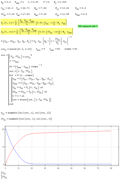

#45 Опубликовано: 30.11.2020 14:33:17
Hi. Thanks Viacheslav for your answer. In the attached, the usual setup for the system of two equations with two unknowns, showing that uni's solution it's the same than the given by Rkadapt. I also can setup a good solution for a 4x4 ode system, but the r's coeffs must to be recalculated before the concentration of O & CO. If not we get a nonsense solution, and guess that this issue is why it's hard to setup a system with more variables, as efus comment that is required. So probably he must to study in which order the updates must to be evaluated for the physical situation.
But what's more impressive to me, it's the Viacheslav intuition for the magistral setup that he do for solve the problem with a runge kutta method with ... one as the step!. Ok, he's the author of the solver plugin, maybe he know what it's talking about.

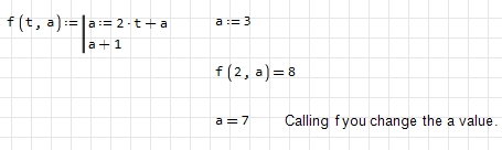

... The solvers also support optional parameters after t and x. You can enter both variables r1 and r2: D( t,x,r1,r2 ). This will make the calculation of derivative values clearer.
I did not know this feature of your plugin. Here, in case that this setup it's ok, it fails, I guess for the order in the updates too.

The ancestor of all these solvers is Euler [Fortran 1970], print stars instead of line.
Your two system DE's can you make them Euler style ?
ODE Euler Multitask.sm (129,12 КиБ) скачан 1072 раз(а).
This was mentioned here.

This is an optional feature. Everything works without explicitly specifying variables, but this is not always clear.
Hi uni. I forgot this feature because I always thinks that it was the same as the matlab parameter placeholder, just to avoid to declare global variables for the local ones that usually appear in the m-script for define the function D. This could be more or less useless in SMath but here I think that you have an actual example of a mandatory use for this feature, because if not the RK procedure gives a bad solution if you don't pay attention to the order of the updates inside the D procedure, as first issue. I guess that there are more.
I bad implement this feature in my example, and you show how to implement it well. Just as comment, for no pass parameters as global values at all, this is a minor modification:

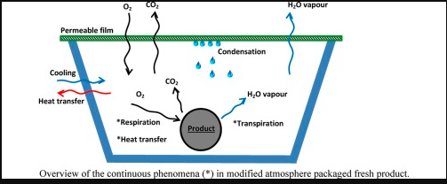

Thanks efus for this drawing describing the physical situation.

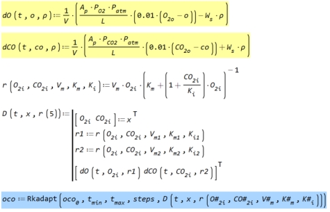

Ok, starting from an example from Viacheslav (Thx really a lot for all your work) I was able to use lsoda for the two and the result is quite good, so I will try to work another little on this road and we will see if I will be able also to add the others pieces.
Edit.
Ok, probably how the system is written isn't the most elegant thing to see, but the loss of weight due to respiration seems to be well represented (green line). The effect of the humidity isn't, at the moment, represented, but with a little bit of work I think it will do.
lsoda MAP.sm (43,15 КиБ) скачан 1067 раз(а).
:d Ah google come in my help for the pictures, but yes, it describes exactly what happened in the package.

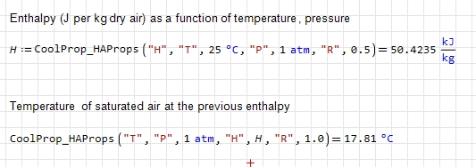

Hi efus. Maybe you could be interested in the coolprop plugin.
Help for humid air: http://www.coolprop.org/fluid_properties/HumidAir.html
Collprop for SMath: https://en.smath.com/forum/yaf_postst7398_CoolProp-Wrapper.aspx
Also, I see your loda implementation, it's ok, and I don't know if the fact that you redefine the parameter "y" in the body of D() have any implication, but you must to know that in SMath if you pass parameters in that way "things happens":
The plugin is for sure interesting! I have intention in the future to face some problem related to respiration with a pure thermodynamic approach, so for sure it will be handy!
