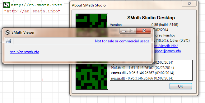

UPDATED
- command-line options
syntax: 'ProcessToStart'[space]Flags
[edit] - Graphical adjustements

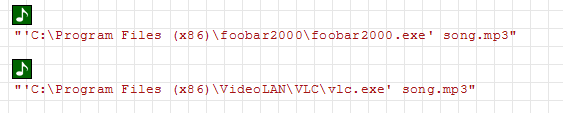

lets say i wanted to open up a file with a specific program, what would i type into the hyperlink?
for example, lets say i wanted to open up
song.mp3
with the executable
C:\foobar\foobar.exe
#27 Опубликовано: 11.09.2013 15:13:36
song.mp3
with the executable
You might try the approach shown in post23.
Use "'C:\foobar\foobar.exe' song.mp3". It is essential to quote the executable path with ', otherwise windows takes the space as part of the prog name.
#28 Опубликовано: 11.09.2013 17:50:46
Exactly
with foobar, if your song contains some spaces use wildcards (*) instead of spaces (f.e. this doesn't work in vlc; I'll think to another approach or another solution to fix this - maybe a double single quotation to have a double quotation or a context menu dialog...)
regards,
Davide

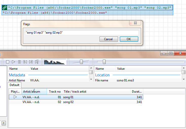

#30 Опубликовано: 06.10.2013 20:09:31
UPDATED
- Flags input moved from the placeholder to a dedicated context menu item.
This solve double quotes issues involving flags and SMath strings.
- PASTE feature works also with the new input way.
(TEMPORARY feature) To update worksheets containing the old syntax ("'process' flags"):
- open the worksheet
- save the worksheet
- close and open again the worksheet
- delete all except the process name from the input placeholder
regards
Davide
