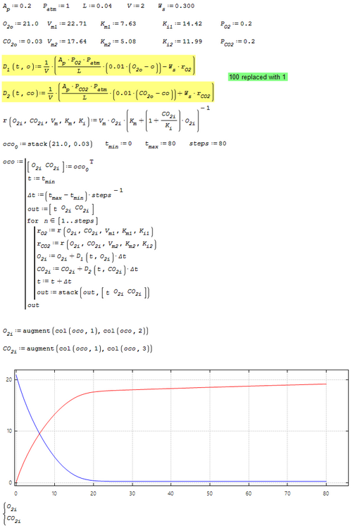

Hi. Thanks Viacheslav for your answer. In the attached, the usual setup for the system of two equations with two unknowns, showing that uni's solution it's the same than the given by Rkadapt. I also can setup a good solution for a 4x4 ode system, but the r's coeffs must to be recalculated before the concentration of O & CO. If not we get a nonsense solution, and guess that this issue is why it's hard to setup a system with more variables, as efus comment that is required. So probably he must to study in which order the updates must to be evaluated for the physical situation.
But what's more impressive to me, it's the Viacheslav intuition for the magistral setup that he do for solve the problem with a runge kutta method with ... one as the step!. Ok, he's the author of the solver plugin, maybe he know what it's talking about.
Modeling respiration-transpiration in a modified atmosphere packaging system containing blueberry 2 (uni).sm (23.38 KiB) downloaded 1170 time(s).

I wanted a compact and scalable algorithm. You, Alvaro, did it better. It should be remembered that the values of the variables r1 and r2 are implicitly passed to the expressions for derivatives. The solvers also support optional parameters after t and x. You can enter both variables r1 and r2: D( t,x,r1,r2 ). This will make the calculation of derivative values clearer.
For those who are not familiar with numerical methods, it is difficult to describe the problem for the solver. I still can't finish a new solver, where the system can be written in a natural form, like a set of equations. This would make things easier for most typical cases.

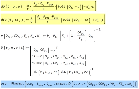

... The solvers also support optional parameters after t and x. You can enter both variables r1 and r2: D( t,x,r1,r2 ). This will make the calculation of derivative values clearer.
I did not know this feature of your plugin. Here, in case that this setup it's ok, it fails, I guess for the order in the updates too.
This was mentioned here.
Modeling respiration-transpiration in a modified atmosphere packaging system containing blueberry 3 (uni).sm (18.72 KiB) downloaded 1149 time(s).
Modeling respiration-transpiration in a modified atmosphere packaging system containing blueberry 3 (uni).pdf (79.39 KiB) downloaded 650 time(s).
Modeling respiration-transpiration in a modified atmosphere packaging system containing blueberry 4 (uni).sm (18.56 KiB) downloaded 1193 time(s).
Modeling respiration-transpiration in a modified atmosphere packaging system containing blueberry 4 (uni).pdf (77.83 KiB) downloaded 669 time(s).
This is an optional feature. Everything works without explicitly specifying variables, but this is not always clear.
Hi uni. I forgot this feature because I always thinks that it was the same as the matlab parameter placeholder, just to avoid to declare global variables for the local ones that usually appear in the m-script for define the function D. This could be more or less useless in SMath but here I think that you have an actual example of a mandatory use for this feature, because if not the RK procedure gives a bad solution if you don't pay attention to the order of the updates inside the D procedure, as first issue. I guess that there are more.
I bad implement this feature in my example, and you show how to implement it well. Just as comment, for no pass parameters as global values at all, this is a minor modification:

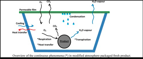

Thanks efus for this drawing describing the physical situation.
:d Ah google come in my help for the pictures, but yes, it describes exactly what happened in the package.

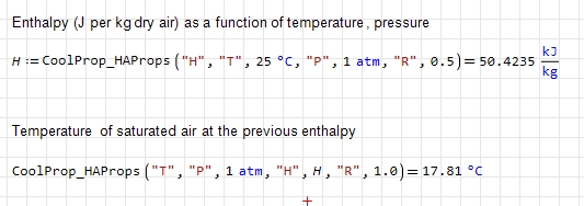

Hi efus. Maybe you could be interested in the coolprop plugin.
Help for humid air: http://www.coolprop.org/fluid_properties/HumidAir.html
Collprop for SMath: https://en.smath.com/forum/yaf_postst7398_CoolProp-Wrapper.aspx
Also, I see your loda implementation, it's ok, and I don't know if the fact that you redefine the parameter "y" in the body of D() have any implication, but you must to know that in SMath if you pass parameters in that way "things happens":
