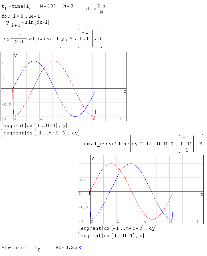

Didn't find an explicit alglib topic, thus I post this here:
It seems that the convolution function from the alglib plugin does not care for the second and fourth arguments (problem size in alglib ). I guess that the problem size is nothing else than the size of the 1st and 3rd arguments, thus they are obsolete.
If that is correct than I suggest to provide a convr1d(2) function.
BTW, a real symmetric eigensolver would be fine...

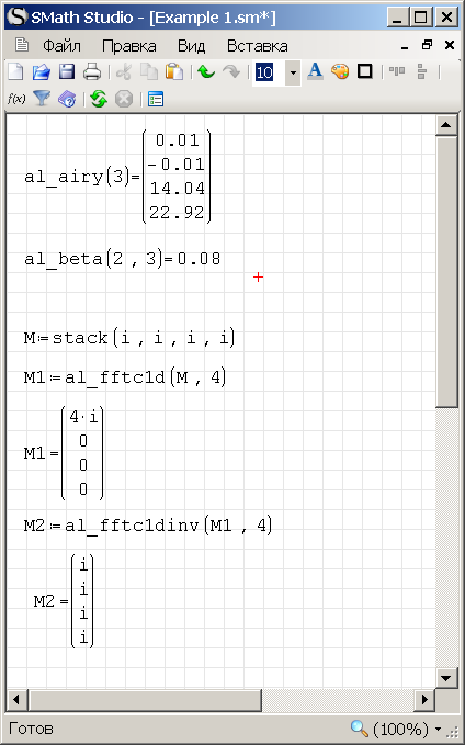

Functions list: al_airy(), al_beta(), al_convr1d(), al_convr1dinv(), al_fftc1d(), al_fftc1dinv(), al_nleqsolve(), al_rkckadapt(), al_polyroots().
AlgLib_screen0.png AlgLib_screen1.png AlgLib_screen3.png 2018-12-20_16-48-12.png 2019-01-27_18-56-56.png

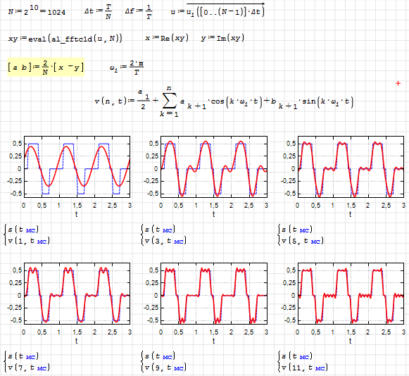

Fourier series coefficients.sm (28.46 KiB) downloaded 1913 time(s).
Fourier series coefficients.pdf (170.26 KiB) downloaded 1213 time(s).

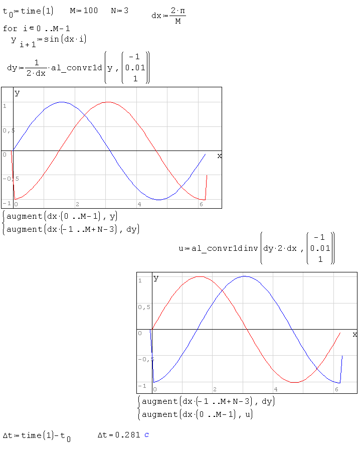

I think it's best to follow the description in the source code (see doc.pdf). I corrected the behavior of the function and added an inverse function convr1dinv().
#4 Posted: 4/28/2013 2:34:59 AM
1,361 likes in 2,275 posts.
Uni, thanks for the update. Now the function convr1d seems to insist on providing the correct vector sizes as arguments. This is not really an improvement unless values differing from the actual length can be provided for some magic purpose. I did not find any such hint in the doc. Thus, in order to keep the argument list lean, I would recommend to have
[MATH]convr1d(f;g)[/MATH] and let the interface determine the sizes as in the previous version.
However, I do not want to distract you from progress in the xyplot-plugin!
Martin
#5 Posted: 4/28/2013 6:24:22 AM
1,558 likes in 1,868 posts.
Ok, I'll add this too. It seems to me that I need to follow the documentation to describe the interfaces of functions.
Thanks for considering the change. This would perhaps apply to the other integral transforms as well. When providing sort of convr1d(2), then you could add a hint to the doc string that the size parameters in alglib are determined from the actual size).

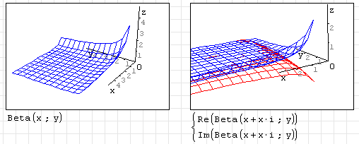

The alglib version of the Beta function seems o return values if one argument is negative despite of the docs limiting the range to posive arguments. Also, in contrast to the implementation in the StatisticalTools Plugin, the function cannot handle complex numbers.

Updated. al_convr1d(2), al_convr1dinv(2) added.
Thanks for implementing the proposal.
On my system, Example 2.sm fails to run correctly. If I replace the al_convr1dinv(4) by al_convr1dinv(2) then it is ok. My handbook examples show the same effect, on top of that, in conv.sm, there is an xy-plot-region throwiing an critical error. It does not recover, even if I fix the convolution problem with the new (2)-call. conv1.sm is the fixed version.
conv1.sm (11.32 KiB) downloaded 1700 time(s).

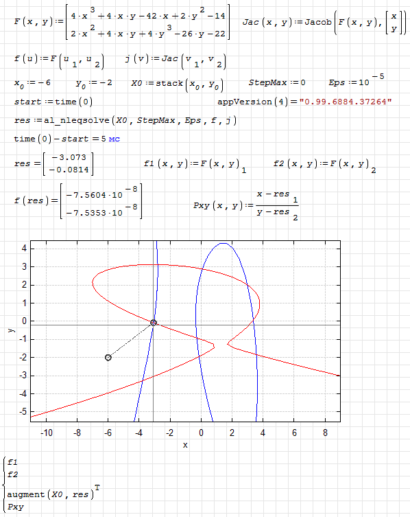

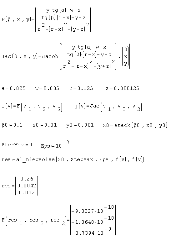

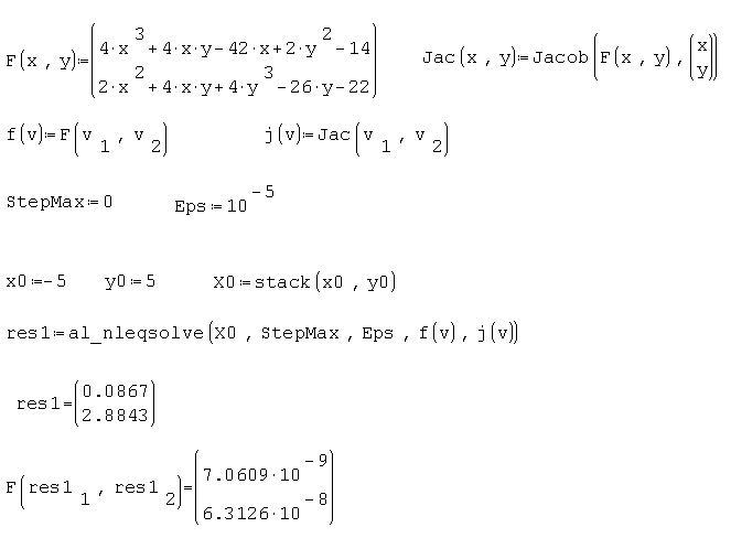

Updated. al_nleqsolve() function added (Levenberg-Marquardt-like nonlinear solver).

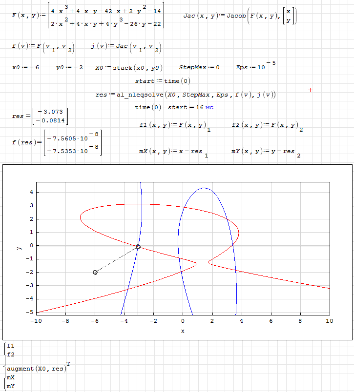

This algorithm solves system of nonlinear equations F(x).
Parameters:
X0 - starting point.
StepMax - maximum step length, >=0. Set StpMax to 0.0,  if you don't want to limit step length.
Eps - >=0. The subroutine finishes  its work if on k+1-th iteration the condition ||F||<=EpsF is satisfied.
Radovan Omorjan 5/8/2013 2:18:00 PM
#10 Posted: 5/8/2013 2:22:45 PM
Thank you uni for this one
I could see that al_nleqsolve() will not work with
[MATH=eng]f(v):eval(F(el(v,1),el(v,2),el(v,3)))[/MATH]
[MATH=eng]j(v):eval(Jac(el(v,1),el(v,2),el(v,3)))[/MATH]
Is there any way to make this possible?
#11 Posted: 5/8/2013 2:37:08 PM

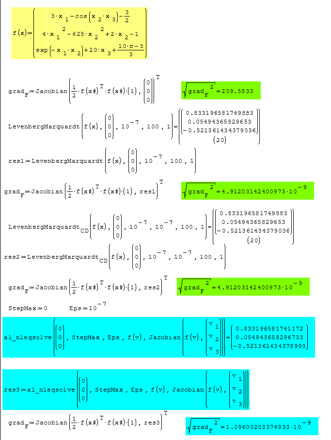

I think it is not necessary, since the function within itself already performs this. I need more examples. Try this solver at work.
#12 Posted: 5/8/2013 4:17:40 PM
I just have some frustrating experience when the Jacobian is involved, and would rather appreciated some "derivative free" algorithms of this kind.
Here is just a playing with the NonlinearSolver plugin which includes Levenberg-Marquard algorithm and this one in AlgLib. For this particular example all performed quite well.
Вячеслав Мезенцев 5/8/2013 4:32:00 PM
#13 Posted: 5/8/2013 4:38:49 PM
Thank you, Radovan. Unfortunately, this interface is defined by the function.

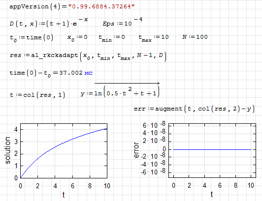

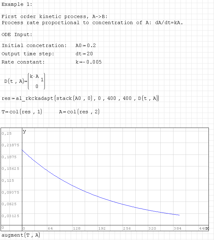

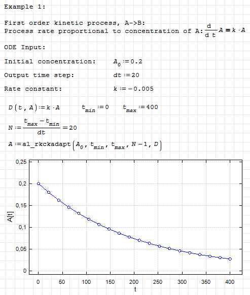

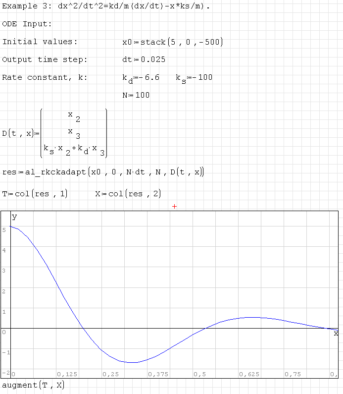

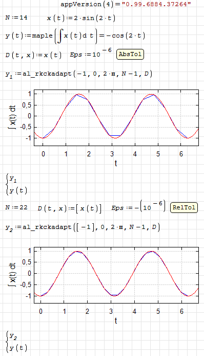

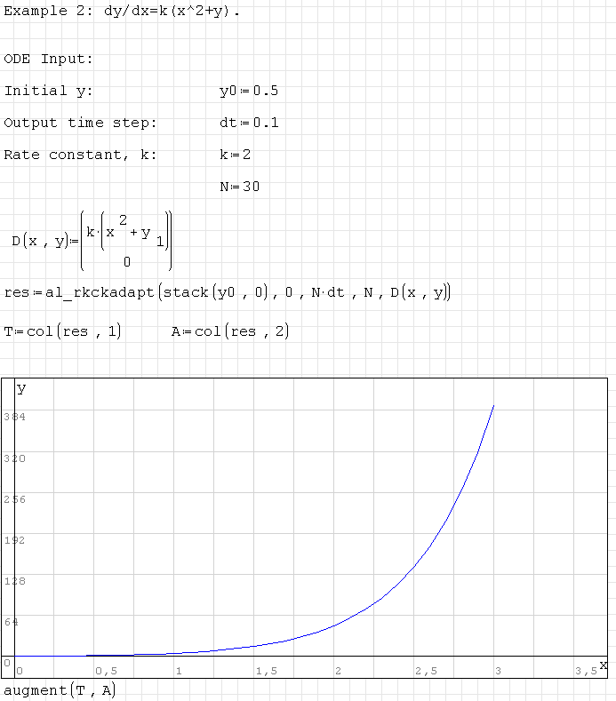

Updated. al_rkckadapt() function added (Runge-Kutta-Cash-Karp adaptive ODE solver).
You can compare with the examples from here: Using the AlgLib ODE (Runge-Kutta) Solver with Excel.

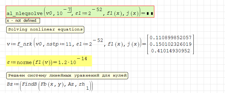

Igor Skarine
Igor Skarine
14 likes in 97 posts.
Some problem in the latest plugin. Another solver f_nrk(...) works fine.
x is formal parameter, how I can define it ? Optimization is numerical, the same for both solvers.
#19 Posted: 7/9/2018 4:33:54 AM
I need a complete example.
#20 Posted: 7/9/2018 10:54:22 AM
Igor Skarine
Igor Skarine
Hello uni,
Unfortunately I can't provide complete example, but if I pass to solver copy-pasted copies of the equations, it works.
See it below. The problem is that plugin can't read correct result of symbolic calculations, but solver written in Smath does it right.
