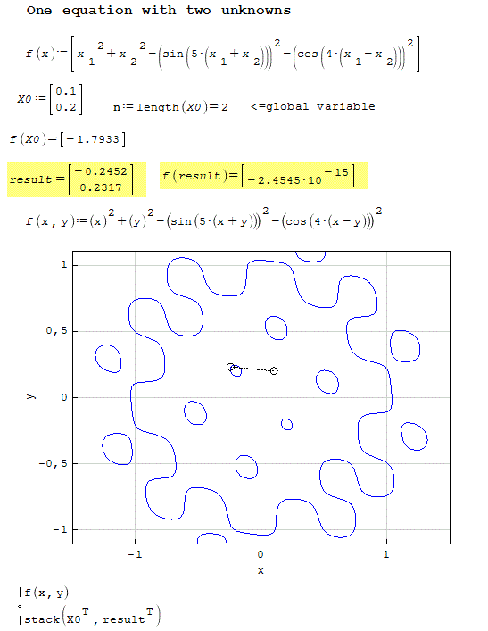

#23 Posted: 7/18/2018 5:40:48 AM
One example of V. Mezentsev (Uni)
Primer Uni.sm (13.49 KiB) downloaded 1668 time(s).
Fortunately, I was wrong. We could use it with different number of equations and unknowns.
I just use the Ber7 example and change it with n as a global variable. No need for zeros as non-existing functions.
Primer%20Uni-mod.sm (13.3 KiB) downloaded 1728 time(s).

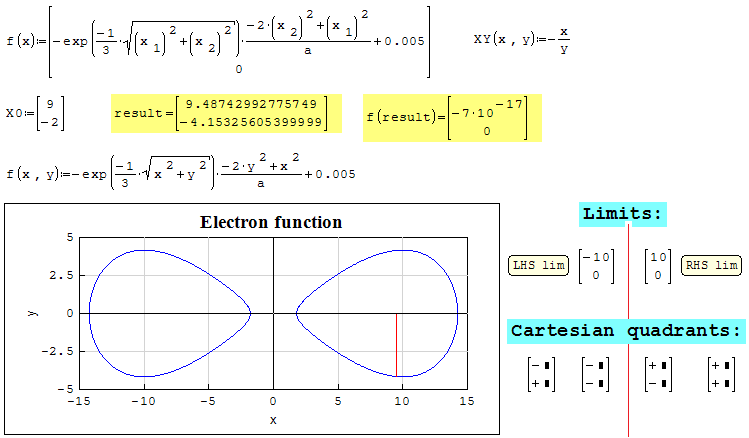

#25 Posted: 7/18/2018 3:19:47 PM
But for some reason simple Newton-Raphson with variable step usually
works better than al_nleqsolve.
Can you demonstrate for this application ?
Solve al_nleqsolve-Electron.sm (18.41 KiB) downloaded 1635 time(s).

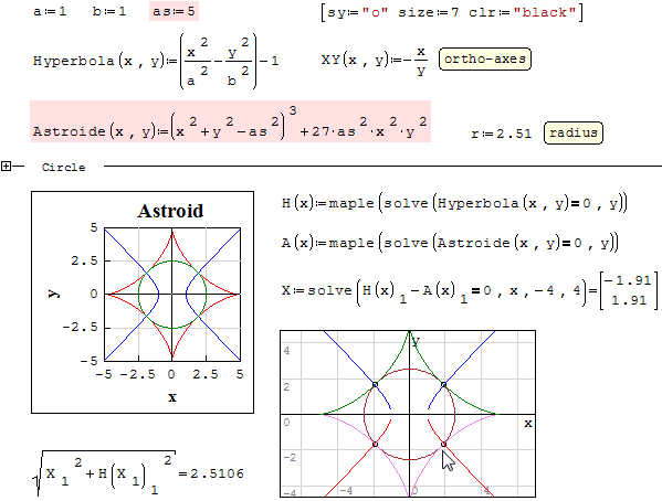

#34 Posted: 8/23/2018 10:57:07 AM
... thanks Ber7
Contour SOLVE AstroidHyperbola.sm (20.85 KiB) downloaded 1689 time(s).

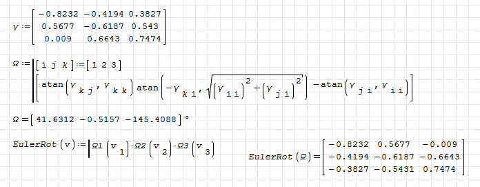

#37 Posted: 10/8/2018 3:23:09 AM
1,139 likes in 1,805 posts.
Hi. The same, but without plugins.
SphereSMath.sm (75.21 KiB) downloaded 1587 time(s).
PD: Do you know the angles for your rotation matrix gamma? I get this, but can't put the matrix elements in the correct order nor sign:
Actually, as I know, the minus in the last atan is a mistake, but at least give the same absolute values.
Fridel Selitsky 10/8/2018 3:35:00 AM, NDTM Amarasekera 10/8/2018 4:19:00 AM
#38 Posted: 10/9/2018 11:42:42 AM
Fridel Selitsky
Fridel Selitsky
520 likes in 451 posts.
Hi, Alvaro.
Unfortunately, I have never done reverse transformations (gamma-omega).
Your error may be caused by the use of the left coordinate system in Smath- graphs.
I selected the angles for the axial matrices empirically in order to get a good perspective ,using the gamma matrix.perspective.
Alvaro 10/9/2018 9:14:00 PM
#39 Posted: 10/10/2018 12:40:38 AM
Mathcad solves the Euler angles from a given γ [gamma matrix].
Smath does not immediately, it complains: Try to use a more specific algorithm.
There are 24 [4!] possible ways to define a 3D system [Mathematica].
The most common is Euler though Mathcad Mathcad ≠ Mathematica.
For common use to define some pleasant views, especially in Smath:
1. Euler [ 3 trig angles]
2. Parametric [X,Y,Z,t] very easy to manage.
3. Quaternion only two coefficients that Quaternion solves for the 3D γ matrix
Rotate Horn.sm (15.07 KiB) downloaded 1623 time(s).
Solve Euler Fails.sm (22.54 KiB) downloaded 1668 time(s).
Rotate Breather [Euler].sm (37.2 KiB) downloaded 1432 time(s).
Rotate_0 Euler, xyz(t), Quaternion.sm (275.27 KiB) downloaded 1660 time(s).

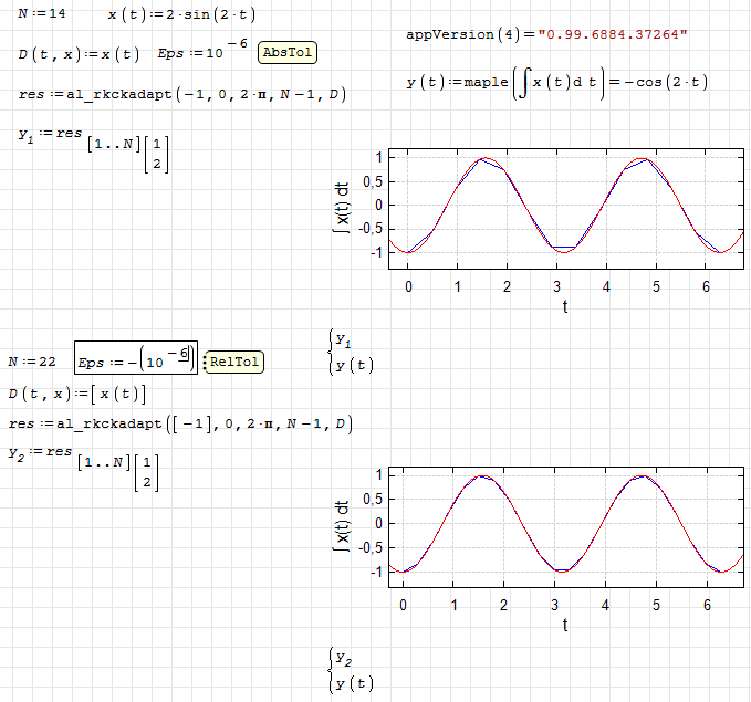

#40 Posted: 12/12/2018 12:57:19 PM
1,558 likes in 1,868 posts.
Updated.
Changes for al_rkckadapt():
- zero point issue fixed;
- added support for the simple D(t,x) definition.
frapuano 12/12/2018 2:31:00 PM, sergio 12/12/2018 1:54:00 PM
