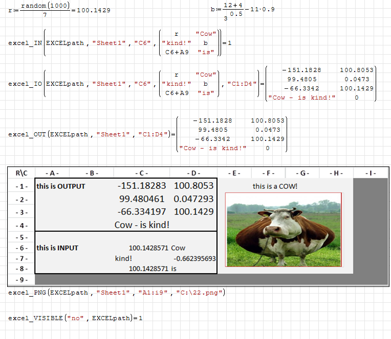

Functions:
excel_IN - export to excel (xlsx or xls) (with or without saving the file)
excel_OUT - import from excel (xlsx or xls)
excel_IO - in memory real-time data exchange with EXCEL - can be replaced by separate excel_IN and excel_OUT functions
excel_PNG - exports excel range to PNG file (together with row/column headers, formatting, charts, etc.) - can be used together with Image region.
Function excel_PNG() was modified to take 5th argument – the font size of excel range table headers (set to 0 if none). The PNG export speed was increased to about 0.08sec per screenshot. Functions excel_PNGv0 and excel_PNGv2 are obsolete, however kept for the sake of backward compatibility
excel_PNGv0 - exports excel range to PNG file (together with formatting, charts, etc.) - can be used together with Image region. Function is executed on each SMath recalculation (slow, but twice as fast as excel_PNG).
excel_PNGv2 - exports excel range to PNG file (together with row/column headers, formatting, charts, etc.) - can be used together with Image region. Function is executed only if content of excel range have changed (fast).
excel_VISIBLE - makes background excel process visible in case you would like to take a look at / modify the file
excel_QUIT - will shut down currently running excel process (use with care - does not save data, will close ALL open excel files)
Plugin does not continuously open/close workbooks (unless excel_QUIT is used), once workbook is open it remains in memory and plugin "connects" to it for data exchange or to save it if desired.
Presently plugin works with EXCEL 2003+. If someone is willing to test plugin for earlier EXCEL versions I can provide a different build.
One of the ways to use plugin:
1. Insert image region into SMath workbook for visual confirmation of SMath <-> EXCEL interaction. Use excel_PNGv2 as an argument of the image region, point it to the range you would like to modify in your xls file. NOW YOUR EXCEL WORKBOOK IS OPEN IN BACKGROUND (this step is optional, however handy to visualize your input)
2. Once you visually see the screenshot of your excel file (together with row/column headers) you can use excel_IN to modify particular cells of the file.
3. Insert image region into SMath workbook that refers to your desired output range in xls file (similar to 1, this step is optional, however handy to visualize your output)
4. Use excel_OUT to point to particular cells/ranges in xls file (once you visually identify them from image region).

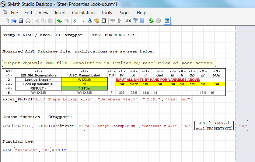

Example that writes rows of data (in my case just one cell) recursively. The concept is that you have an elaborate formula that takes input and provides output. Each line of output is written to a new row in Excel worksheet.

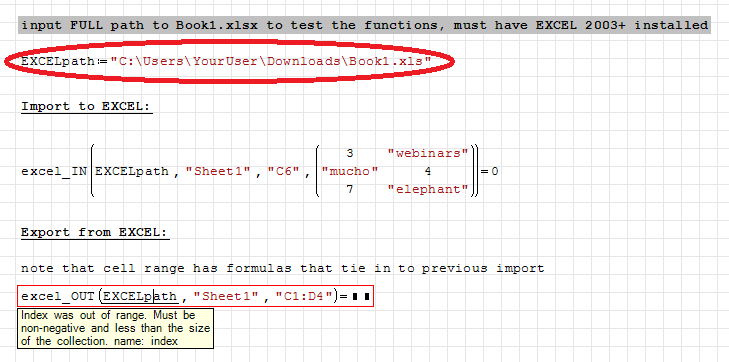

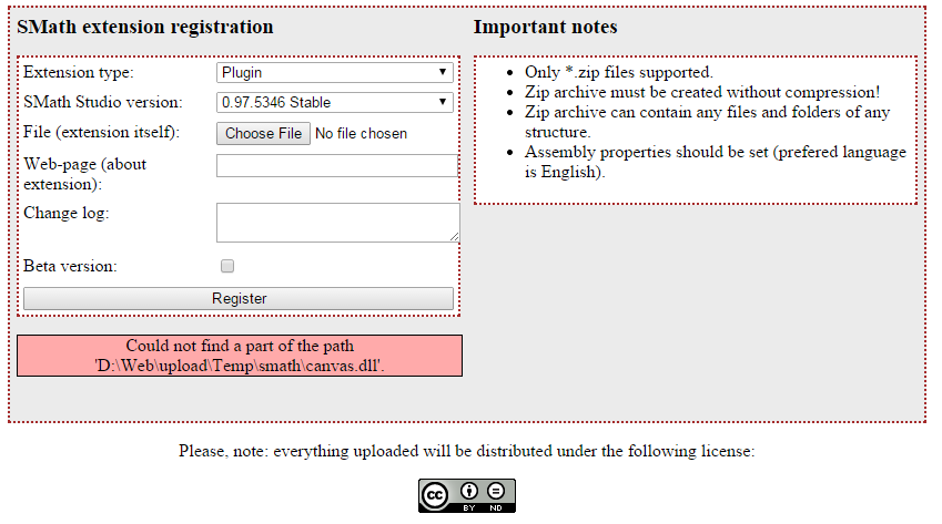

And... There is an error. Screenshot is attached.
#4 Опубликовано: 16.04.2015 06:14:15

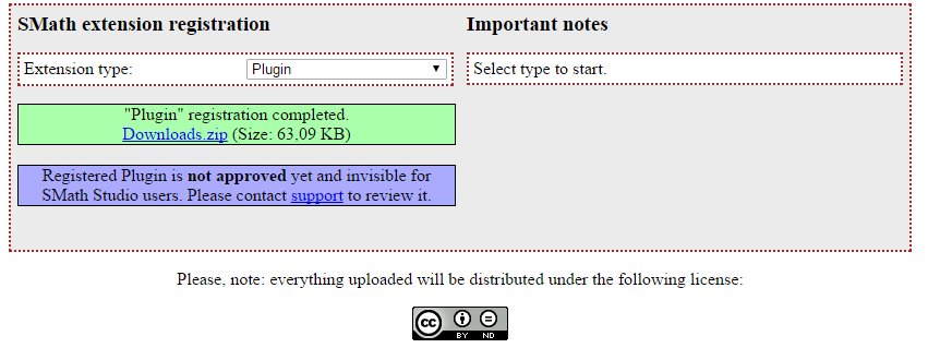

Tried today with Excel 2010, i get an "index out of range" exception with excel_OUT and excel_IO (no issues with excel_PNG and excel_IN)

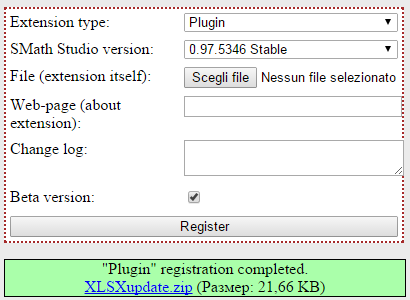

About the registration of the plugin, I've tried and I haven't noticed issues (used just the dll in an uncompresed archive)

Could you please confirm that "index out of range" error is due to file not being specified correctly? Circled is generic path that needs to be changed. I will update the plugin so correct exception is shown.
Will try uploading myself again. Did you include in archive only two plugin files .dll and .pdb?
Thanks!

Could you help me to debug the error (given it is non reproducible on my end).
I have compiled a plugin .dll that will help to pin point what section of code throws the exception - could you please run it using Smath workbook, xls file and plugin attached and let me know the results?
Thanks!
Test ExcelOUT.zip (912,57 КиБ) скачан 676 раз(а).
#8 Опубликовано: 17.04.2015 05:01:04
Thanks!
Done! the error message now is "check input 3 "
If you put the plug-in files in the SMatht plugins directory, you receive this message:
You have to use the plugin in the latest stable version (I use a portable version to test it)

#10 Опубликовано: 17.04.2015 13:42:12
Now the error is "check input 8 ..."
More: I've tried changing system settings, the issue seems in localization stuff because if I use '.' as decimal separator all it works fine.

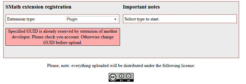

Davide, could you please remove your version of my plugin, i get following error:

#14 Опубликовано: 17.04.2015 20:51:55
Группа: Super Administrator
All references to uploaded by Davide extension removed. Please try to register extension again by yourself.

I have successfully uploaded my plugin to extension manager.
Davide, Andrey - thank you for your help!
P.S.: Andrey, I believe you will need to review / approve it.

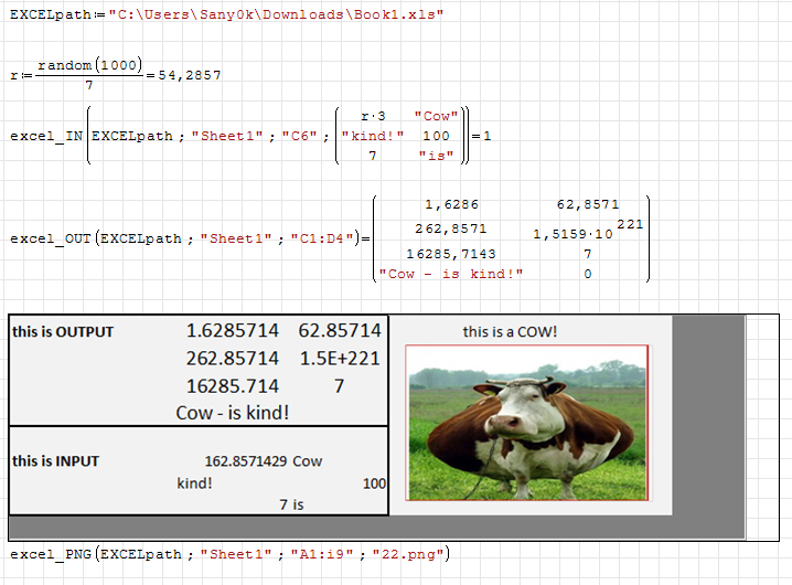

Plugin is updated as you suggested. Do you have ideas about a way to replicate the error on my side? I would really like this resolved.
Thank you for testing!
It works!
Tested mixing various SMath and system settings
To test it yourself go to the "control panel" > "region and language" and then change the system decimal separator (no needs to restart the system)
You can use also this shortcut from the search box of the start button
C:\Windows\System32\rundll32.exe shell32.dll,Control_RunDLL intl.cpl,,0
Approved OK with one comment: please don't include auto generated *.pdb and *.xml files into plug-in package next time.
Thank you!
