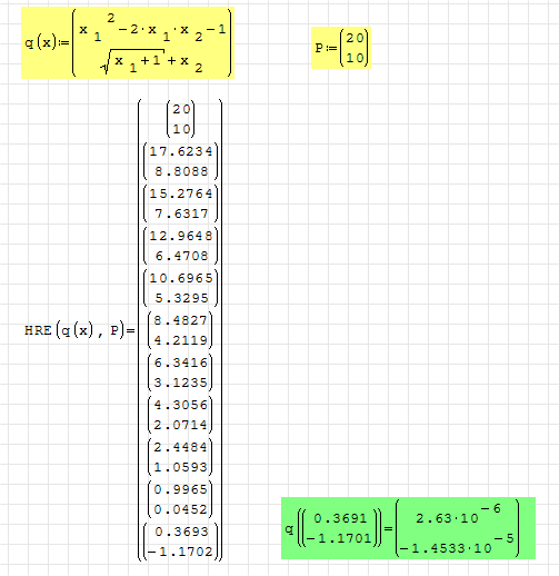

#34 Опубликовано: 12.09.2012 18:35:32
As for "homotopy continuation methods" I've found this mathematica code.
However I don't know if this method is interesting or too difficult to code, I read that works very well for polynomial systems as well.
EDIT:
More fortran and pseudocode about continuation methods on this pdf
little experiments in SMath with Homotopy... it's a very interesting and powerful tool b)

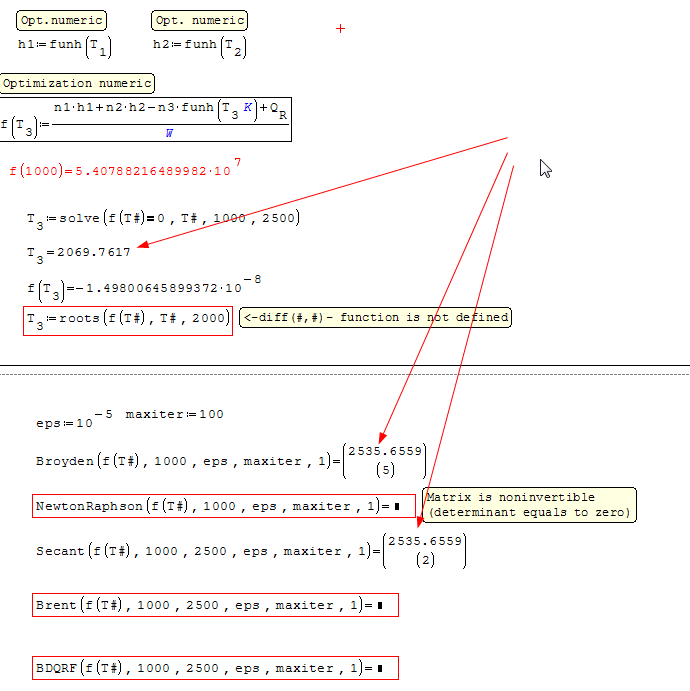

Some more testings and surprises. I attached one of my files and tried all the nonlinear solvers including the SMath solve, roots() and all of them made by w3b5urf3r up to now
I attached a part of my file (primer63w.sm). Here is another situation regarding SMath optimization. The first picture is when the Symbolic Optimization of the function is applied. Everything seems to be fine (although two functions failed - roots(),NewtonRaphosn()). Strangely, when the Optimization is none, numeric - all of them failed and just look at the second picture - now the result of f(1000) is a vector and not scalar as before. This is due to the situation where we have the product of two vector - the result should be a scalar (scalar product of two vectors). When we change some Optimization in the file we can even get the result as in the third picture - solve() gave the result but the other two solvers have different results than solve(). Something must be strange here because other solvers failed. The main problem here is that SMath sometimes returns scalar and sometimes vector depending on optimization applied (fourth and fifth picture on the next post). I think I made some mistakes but can not figure out what happened here.
Could someone take a look at this please.

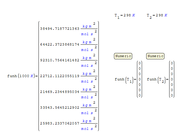

#36 Опубликовано: 13.09.2012 08:57:18
Continuing from the post above with two pictures - the result is scalar or vector of scalar product of two vectors - depending on optimization. Do not know why?.
#37 Опубликовано: 13.09.2012 14:12:44
Hi omorr
seems there are many little issues (see the attachment)...
if you use a line in the definition of funh(T), the behavior changes further
regards,
w3b5urf3r
Primer63w_debug.sm (102,24 КиБ) скачан 1591 раз(а).
#38 Опубликовано: 13.09.2012 14:42:58
Hello w3b5urf3r,
Thank you for checking this out . I can join you with "don't know why" statements about this. I am not sure but I think that has something to this Transpose-functions-bug
I hope that Andrey will have some time to check this out as well.
EDIT: I might be completely wrong here but I think if eval() could be used in funh():=eval(...) many of the numerical problems might be overcome.
#39 Опубликовано: 14.09.2012 06:25:16
Plugin updated.
added HRE(...) and HRE.B(...) (Homotopy root estimation using NewtonRaphson and Broyden, respectively);
fixed issues of internal variable parser with differentiations.
EDIT: Plugin reuploaded with support for unassigned variables named with apostrophe (f.e. x')

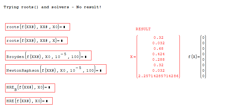

Hello w3bsurf3r,
Let's go again with testing
I attached a file where all solvers failed. Do not understand why. Could you take a look at it please.
