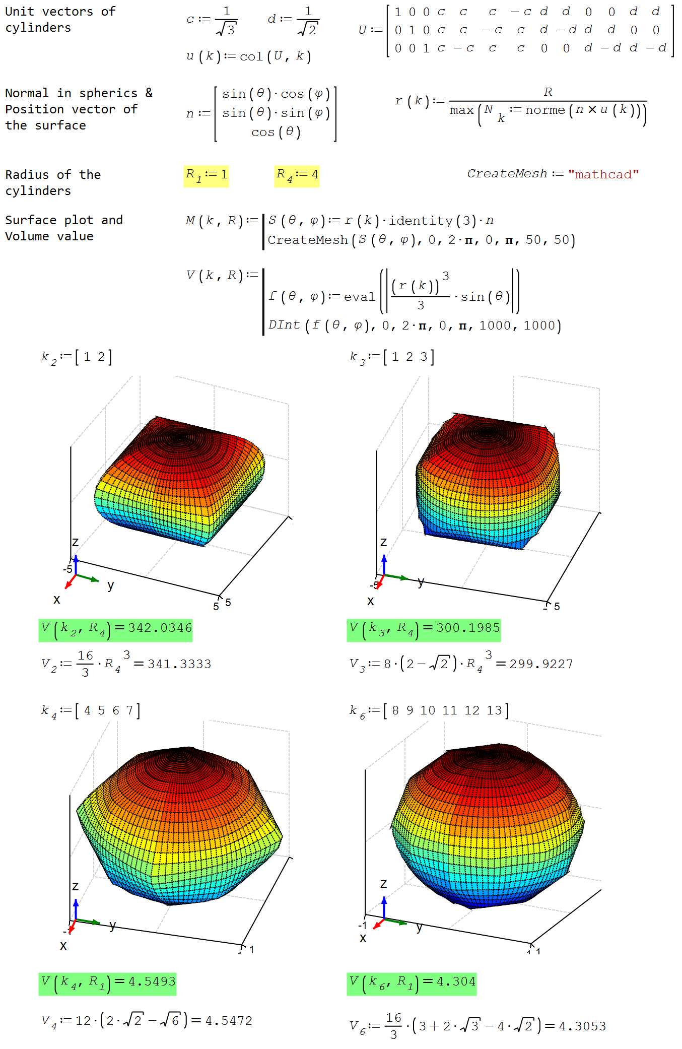

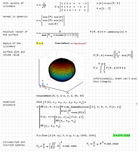

Hi. Maybe something like this
VolumeOfIntersection.sm (17.39 KiB) downloaded 3 time(s).
VolumeOfIntersection.pdf (442.78 KiB) downloaded 3 time(s).
Alvao
Alvao

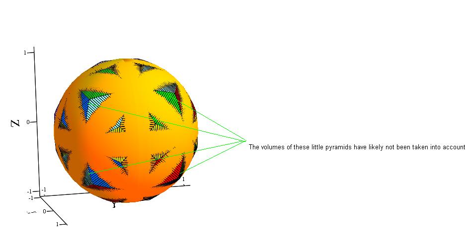

Alvaro, thank you. Unfortunately, your calculation method results in a 4.5 percent error relative to the true volume of the object.
(The layer thickness turned out to be a bit too small.

Hi Victor. The procedure looks good enough to me for the others cases.
Steinmetz Solid.pdf (2.79 MiB) downloaded 1 time(s).
Steinmetz Solid.sm (25.39 KiB) downloaded 2 time(s).
