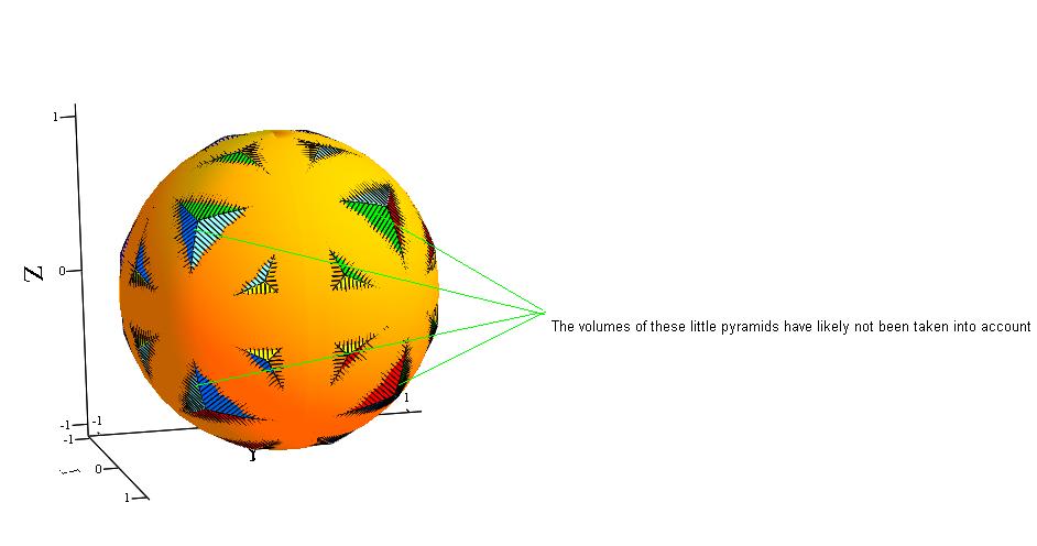

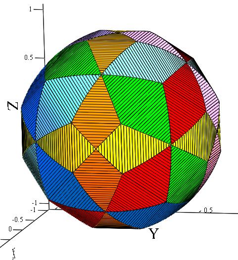

Consider a solid bounded by a surface formed by the intersection of seven cylinders of radius $R$. The axes of these cylinders all intersect at a single point; four of the axes are directed along the long diagonals of a cube, while the remaining three are perpendicular to the faces of the cube

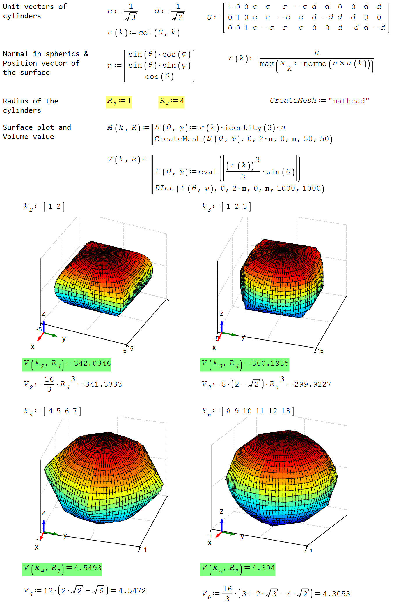

Hi. Maybe something like this
VolumeOfIntersection.sm (17,39 КиБ) скачан 4 раз(а).
VolumeOfIntersection.pdf (442,78 КиБ) скачан 4 раз(а).

Alvaro, the discussion concerned obtaining an exact formula. Look up "Steinmetz solid" on Wikipedia. Your approximate formula does not account for the volume of the parts cut off from the solid.

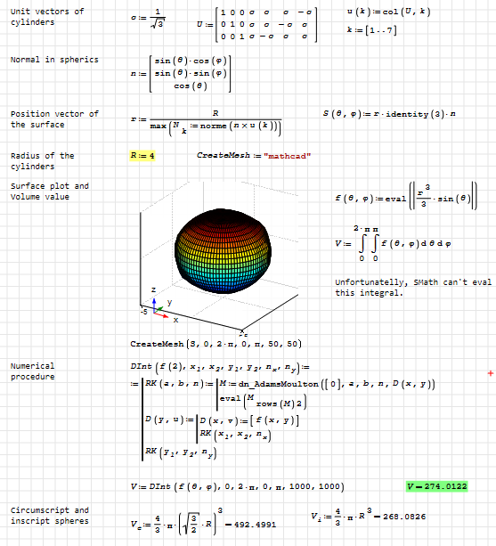

Hi Victor. The procedure looks good enough to me for the others cases.
Steinmetz Solid.pdf (2,79 МиБ) скачан 2 раз(а).
Steinmetz Solid.sm (25,39 КиБ) скачан 3 раз(а).
