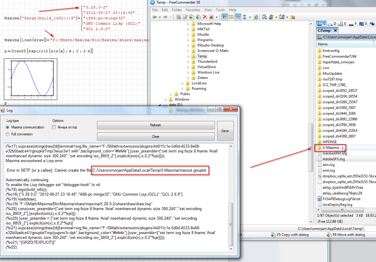

    Here it is. USB Stick is on F: . I started X-Maxima.exe few times (seen on the screenshot) and wxMaxima opened. I just closed it then. As I could see no plot when opening the test file, on the debug window was a message of unexisting X-Maxima temp folder. Just created it manually, and then it worked.
    Hmm..., should I run F:\SMath\Maxima\Bin\Maxima\bin\xmaxima.exe ? I run it, it does not help it.
    Look at this video please
    Anyway, I have to make X-Maxima folder manually.

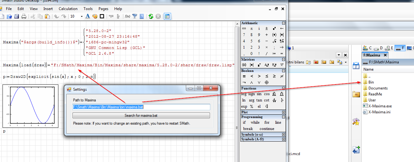

    Ha - it works . I've noted that X-Maxima temp folder was not needed anymore (I deleted it). I tried your sample file and could see that the temporary graphics files resides in th USB stick inside Maxima plugin temporary gnuplot.output foder. It disappears when SMath was closed.
    I also tried your Drw2D3D example. Unfortunately, there are some problems here. I've noted that the graphics files appear inside SMath install folder (not in the file folder - here F:\Temp) but they do not appear in the Worksheet. See the video please. I might missed something here of course.
    I also changed the path for Maxima - it is relative path inside maxima.xml now (you deleted the post about it, but I saw it before that )
    Maxima\Bin\Maxima\bin\maxima.bat
    One more thing. I just used maxima.xml from my regular install because I could not find it on the stick.
    EDIT: I updated the plugins from the the Gallery for USB Stick SMath+X-Maxima. The sample file is Ok, but there might be some mess because Draw2D3D file can not be opened with SMath from the stick - here is the error

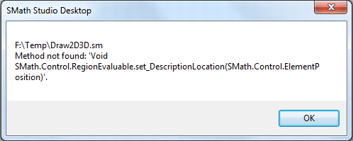

    It seems I figured out something. I used the USB version and wanted to get a plot with the previously saved graph file. It appeared that the formed graph files were saved in the SMath folder but there were no pictures in the SMath Worksheet. When I restarted Maxima, then plots appeared and the plot files in the same folder where the file SMath file resides. Now, after recalculation SVG is reloaded but PNG is not - that was strange. I am not sure this behavior is expected. Anyway, see this video file please. I hope you could see it because I used large portion of the screen.
    The same error with your Draw2D3D examples file and the USB version. I could not opened it here on my office computer (Win7 x64) and therefore could not produce Log file. I have the impression that for the moment this portable version on the stick is working quite good.

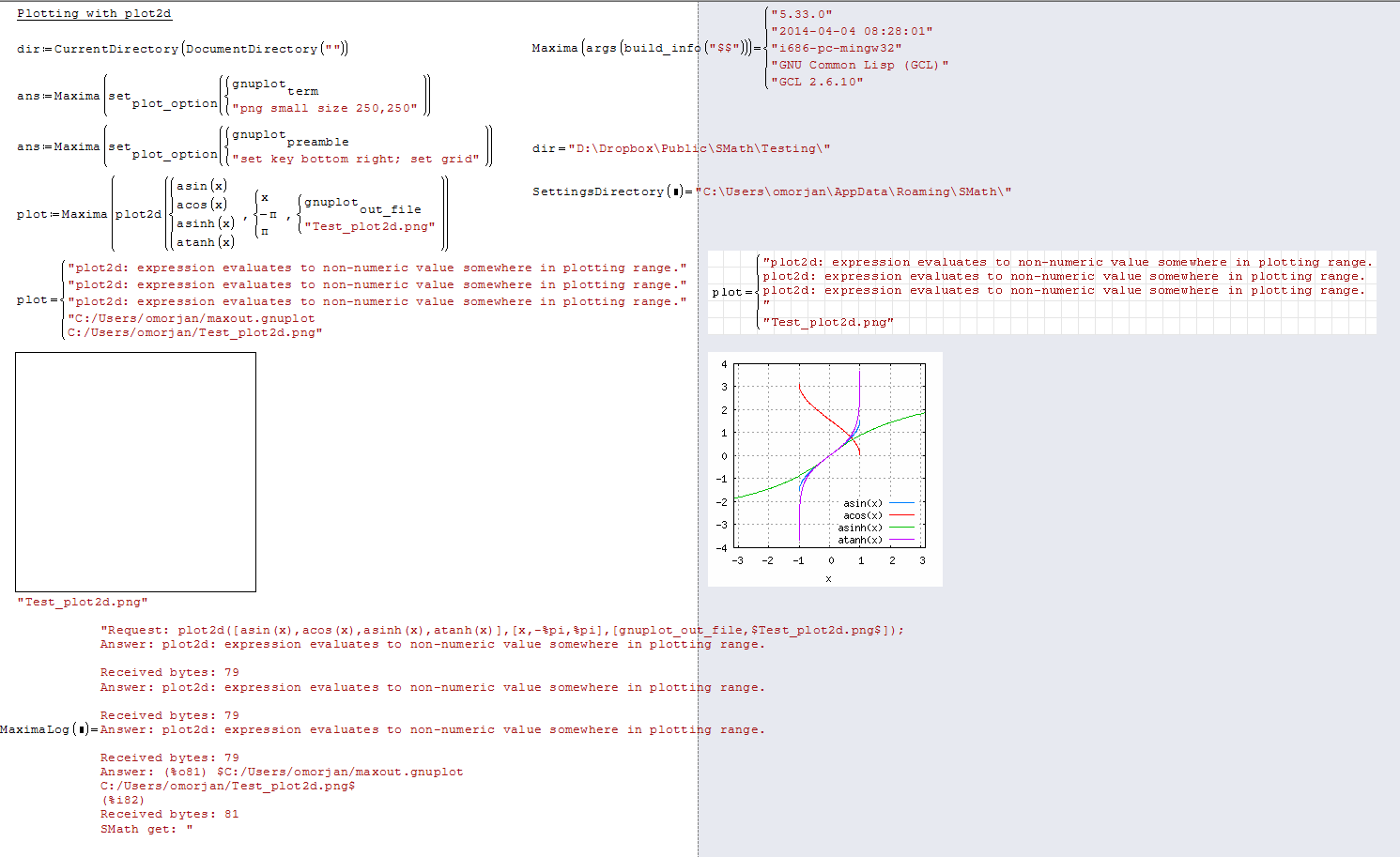

    Just opening the PluginMaximaTest.sm file. The plot2d was not presented.
    Everything else seems to be correct.

    That seems to be a path or current dir issue. Has the png file been generated at the location indicated by the plot command? Then, using this path for the image region should do the job.
    #98 Posted: 4/7/2014 4:30:46 PM

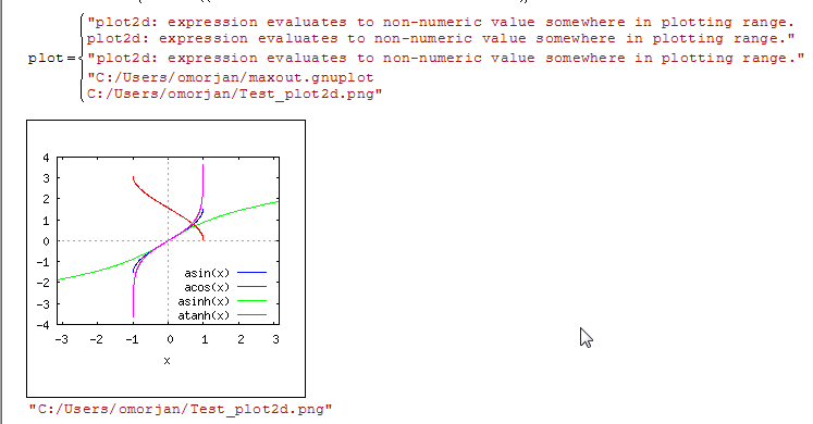

    You are right. I just used the full path and there is png files saved there. Should it be this way?
    #99 Posted: 4/7/2014 6:35:05 PM
    1,361 likes in 2,275 posts.
    Definitely not, because this is not portable. Send the sheet to someone else and it will fail. Somehow the current directories in SMath (where the image region acts) and Maxima (where the image is generated) do not match.
    Kay and me, we discussed the issue of how to match the paths in a reliable way and we decided to leave everyting that depends on current directory settings in the responsibility of the user. Thus, if you set a relative file name for the image, you must make sure yourself that you find the image.
    Normally I find using CurrentDirectory(DocumentDirectory()) or just opening the sheet by doubleclick in the file manager (thereby starting an SMath session with current dir where the file is and a clean new maxima session) being sufficient to avoid path problems.
    If you do not need the image as a separate product but just want to display it, then we offer the temporary storage in the plugin dir, using dynamically created absolute paths. If you still badly need matching current directories in SMath and Maxima, then you might file a feature request. However, this might not be easy going to implement.
