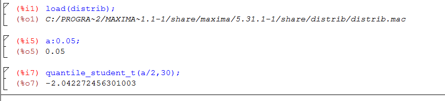

I can not figured out what is going on here by looking at the log file. Please look at the picture and the attached file. If I use numbers inside distrib package functions I have the result, but if I use variables - problems arise. Am I missing something here?
This is a distrib package issue. By whatever reason, some functions in distrib seem to insist on floating point values for some of their arguments in order to issue a numeric result. Otherwise they return the unevaluated function form, which you do not see due to numeric optimization of your result display regions.
[MATH lang=eng]Maxima(quantile_student_t(α/2,30))=quantile.student.t(1/40,30)[/MATH]
[MATH lang=eng]Maxima(quantile_student_t(α/2,30.0))=-2.0423[/MATH]

To me that looks strange as well. However, it is not the plugin to blame. Your wxMaxima example uses 5.31.1-1, whereas the plugin seems to use 5.33 in your previous post. There seem to be differences in the distrib package between these versions. I'll ask in the maxima list about the backgrounds.
Edit: All the problems are gone if you switch the definition of alpha from symbolic to numeric optimization. (As always ;-)
In wxMaxima, a is considered to be a float and so is a/2. In SMath, defining a as 0,05 with symbolic optimizaition, immediately changes that to 1/20, which is not a float anymore.

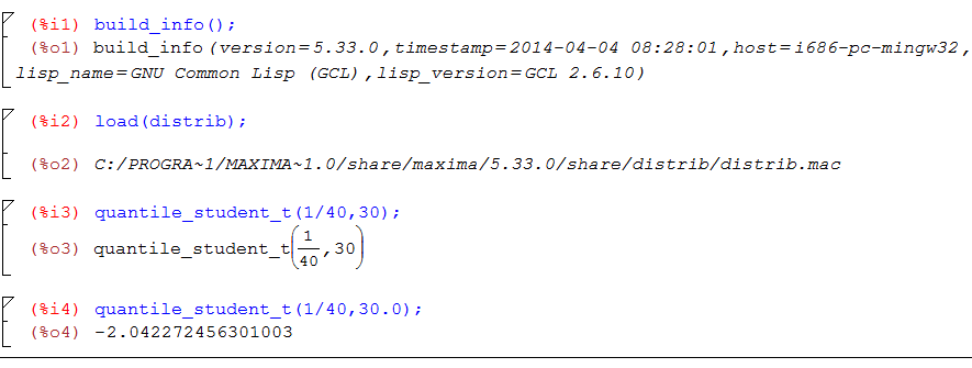

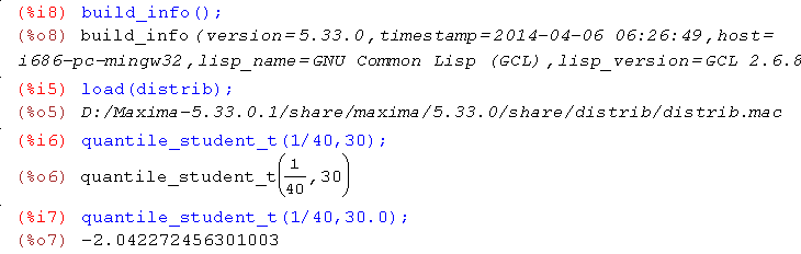

You are right about different in Maxima versions - but I am still puzzled. In my example I was using both SMath Desktop (Maxima 5.31.1-1) and SMath Portable (Maxima 53.3.0) and the behavior was the same in Smath - see the picture and the first line at the top Maxima(load( distrib )) distrib-float previous post. You are right that my wxMaxima was 5.31.1-1 - this post regularly installed on my office machine.
I tried your previous example at my home computer in wxMaxima (Maxima 53.3.0) and and it is the same problem with SMath and wxMaxima regarding floats and distrib package.
A bit confusing, . I'll check it tomorrow once more - I might made a mistake.
[EDIT]
I can not simply believe it . It happened again. If someone else would have had this problem, that would be the first thing I would suggest.

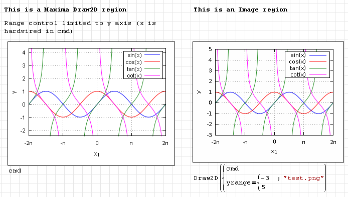

#130 Posted: 6/12/2014 12:27:30 PM
1,362 likes in 2,276 posts.

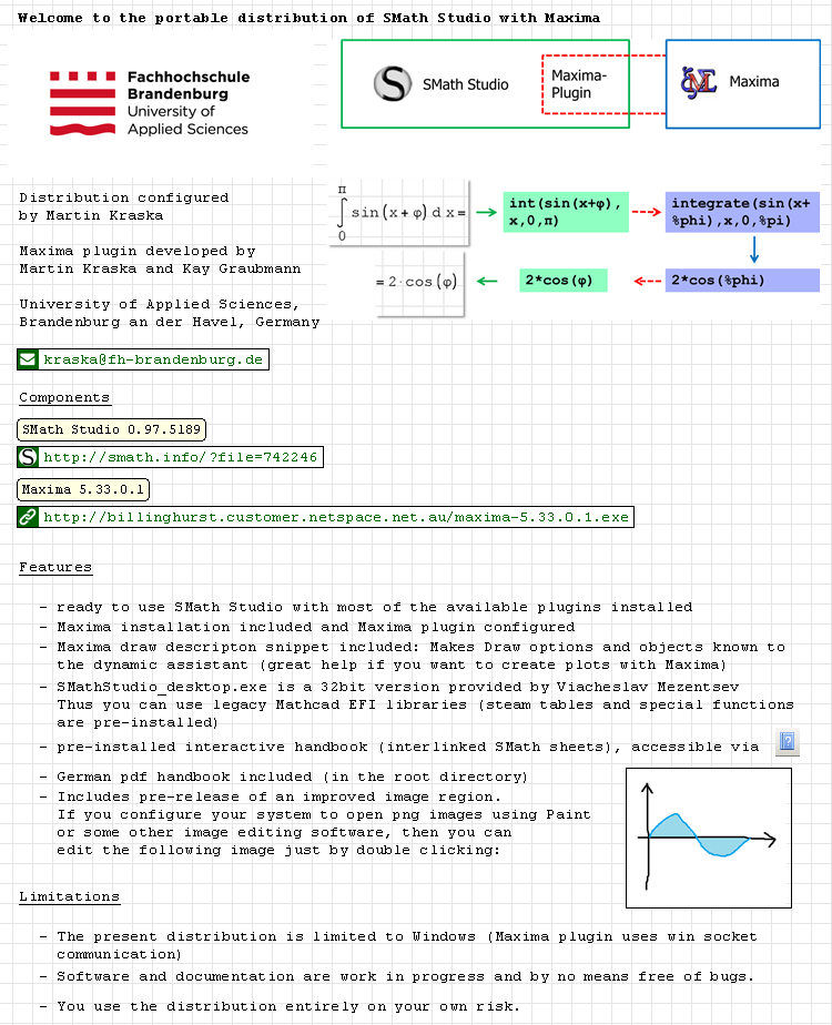

The Maxima plugin has come to a new level of usability:
A ready-to-use portable version including a full Maxima installation is available for download. The download is approx. 60 MB, extracted you get 160 MB, mainly due to Maxima, but also due to the documentation.
Basically, you can unzip the file wherever you want and launch SMathStudio_Desktop.exe.
More fun is gained if you link file extensions .sm to SMathStudio_Desktop.exe and png files to some image editor, say, Paint.
The attached screenshot is from welcome.sm in the root directory of the distribution.
There is a new Image Region included.
Try Insert> Image. You get an empty region with some text informing you about the options:
  • Double click to launch the image editor with an empty image - that's how you can create illustrations on the fly
  • Import an existing image via context menu
  • Specify a file name in the placeholder to dynamically display that file
  • Specify a matrix to dynamically display it's contents (just like with the original image region by uni
You can dynamically (with the mouse) resize the region and reset it to the original size via context menu.
The expression in the placeholder is evaluated by the region, thus you can place any commands generating file names or matrices just there. And hide the whole lot if you wish. No need for intermediate storage variables any more.
The image region is not yet in the online gallery of the extension manager. Kay and uni have to find a way how we can publish the region without irritating the user by two image regions.
When testing the distribution on my wife's notebook, I had to reset the screen font scaling to 100% in order to not spoil the formatting of the interactive handbook.
Please report any issue.

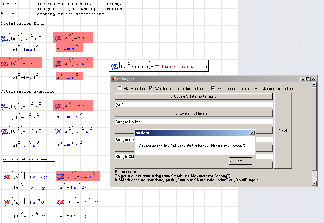

#131 Posted: 6/15/2014 5:43:12 PM
There is an extremly dangerous bug (can silently lead to wrong results) in the translation of expressions with powers to Maxima.
SS-159
This might be related to wrong results provided by Optimization None (SS-160). However, if at all, that can only be partial excuse, because for optimization symbolic or numeric the bug appears depending on what the variable name is.
EDIT: This problem is mitigated by switching to SMath release 0.97.5280 (SS-160 fixed)

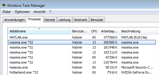

* more and more maxima-tasks are startet, so the system crashed (see the screenshot)
* eigenvalues in SMath can't be solved but maxima can (there
I tried to find out the reasens but i didn't.
Thanks for your help and best regards
Thanks for reporting the problem.
I can reproduce the problem with SMath 0.97.5301 and Maxima 5.33.0
However, I do not get a solution in Maxima (may be I did not wait long enough).
The handling of hanging maxima processes is poor in the plugin. I'll add the example to the bug tracking system.

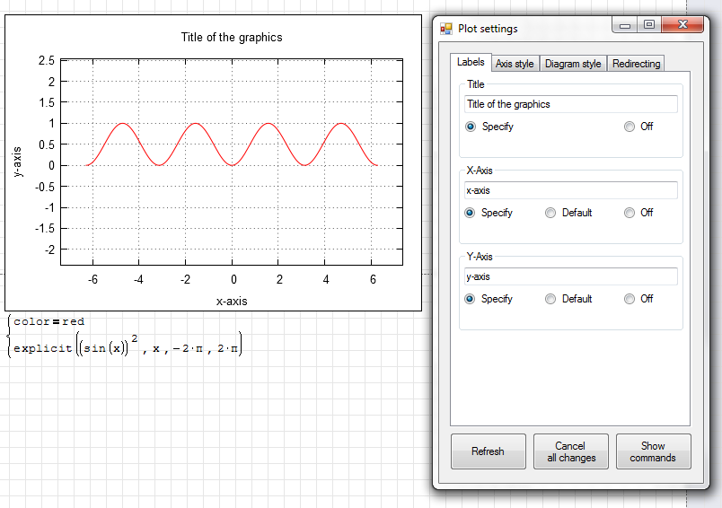

- New interactive Maxima Draw2D/3D regions
- Enhanced png Draw output

Of course, it is a bit unstable at the moment. Sometimes strange things happen. The part of the notebook moves into the Draw2D(), Draw3D() region and scrolling is inside that region. SMath crashes then. I can not reproduce this at the moment, sorry.
