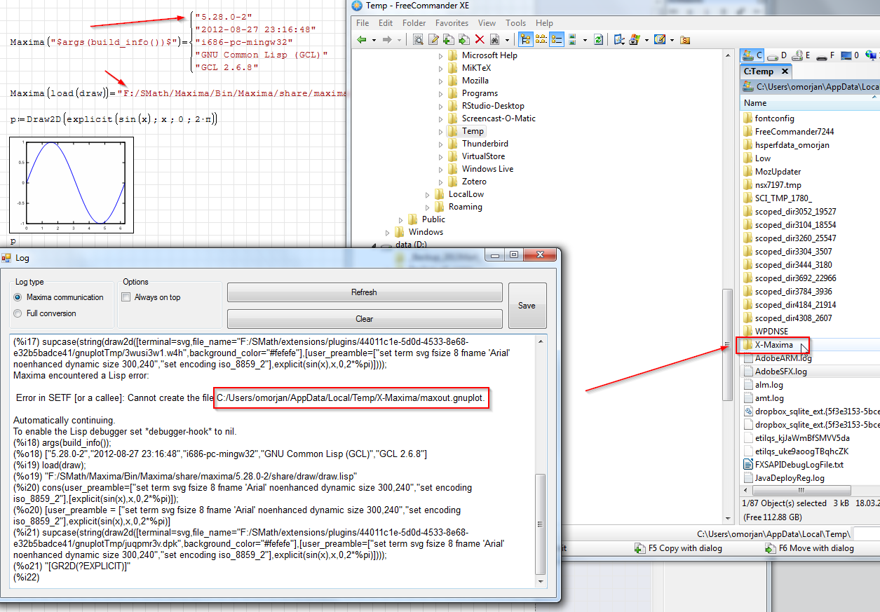

    Here it is. USB Stick is on F: . I started X-Maxima.exe few times (seen on the screenshot) and wxMaxima opened. I just closed it then. As I could see no plot when opening the test file, on the debug window was a message of unexisting X-Maxima temp folder. Just created it manually, and then it worked.
    Hmm..., should I run F:\SMath\Maxima\Bin\Maxima\bin\xmaxima.exe ? I run it, it does not help it.
    Look at this video please
    Anyway, I have to make X-Maxima folder manually.
    Martin Kraska 30.03.2014 12:51:00

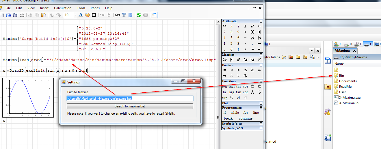

    Ha - it works . I've noted that X-Maxima temp folder was not needed anymore (I deleted it). I tried your sample file and could see that the temporary graphics files resides in th USB stick inside Maxima plugin temporary gnuplot.output foder. It disappears when SMath was closed.

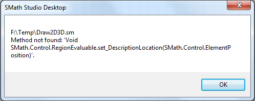

    I also tried your Drw2D3D example. Unfortunately, there are some problems here. I've noted that the graphics files appear inside SMath install folder (not in the file folder - here F:\Temp) but they do not appear in the Worksheet. See the video please. I might missed something here of course.
    I also changed the path for Maxima - it is relative path inside maxima.xml now (you deleted the post about it, but I saw it before that )
    Maxima\Bin\Maxima\bin\maxima.bat
    One more thing. I just used maxima.xml from my regular install because I could not find it on the stick.

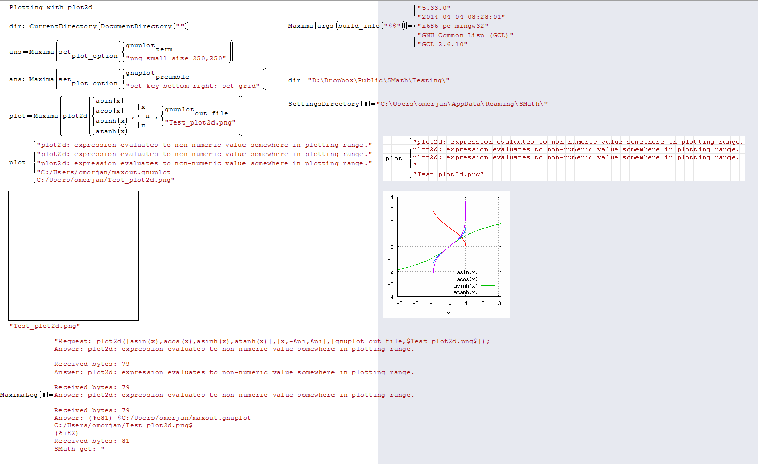

    #95 Опубликовано: 06.04.2014 17:05:21
    Just opening the PluginMaximaTest.sm file. The plot2d was not presented.
    Everything else seems to be correct.
    #96 Опубликовано: 06.04.2014 17:53:23
    it works for me (Maxima 5.30.0)
    Best regards,
    Davide
    #97 Опубликовано: 07.04.2014 15:33:27
    That seems to be a path or current dir issue. Has the png file been generated at the location indicated by the plot command? Then, using this path for the image region should do the job.

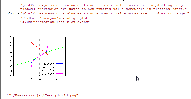

    #98 Опубликовано: 07.04.2014 16:30:46
    You are right. I just used the full path and there is png files saved there. Should it be this way?
