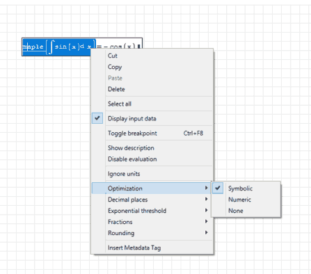

#284 Posted: 3/25/2020 12:32:16 AM
CBG
CBG
78 likes in 312 posts.
put the optimization to symbolic or none
Carlos
#285 Posted: 3/25/2020 6:04:40 AM
1,361 likes in 2,275 posts.
I have a portable version of Smath 0.99.7251. The Maxima is under D:\Program Files\Math Tools\SMath Studio\extensions\plugins\44011c1e-5d0d-4533-8e68-e32b5badce41\1.98.7100.23756\
I put the above path into insert->settings, but it show "Cannot find maxima.bat"
Did you install Maxima? If not, follow the link in my signature and see the instructions for installing and configuring Maxima. The plugin just provides the interface.
Thanks. I installed Maxima 5.42.2.
But still can't get result. SM file attached.
You have to set Optimization to Symbolic or None to display symbolic results. You can also press Ctrl+. instead of = to get symbolic results from an expression.

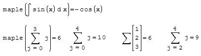

@Jean: maple isn't SMath native, you see that if you try it in the cloud version. Also, the legal/license status of the embedded maple executable has never been clarified. There might be people who care about this.
YES Martin. On the other hand, Maple is the former Macsyma
joint venture MIT/UT [University of Toronto].
Hard to legal/license to freeware Smath.
The very core Maple is largely due to Angot ancestor.
Thanks Martin ... Cheers/Jean

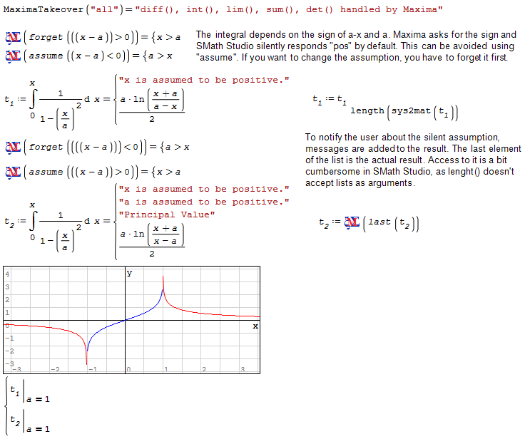

#287 Posted: 10/8/2020 7:00:15 AM
This is an example on how to control the assumptions used for symbolic integration in Maxima.
1-2-4 Widerstandskrafte.sm (12.13 KiB) downloaded 1700 time(s).

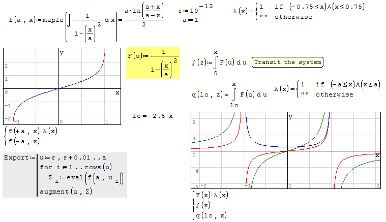

sergio 10/8/2020 3:45:00 PM, IVR 10/10/2020 12:24:00 PM
#288 Posted: 10/10/2020 8:52:49 PM
Get more from less ... typical.

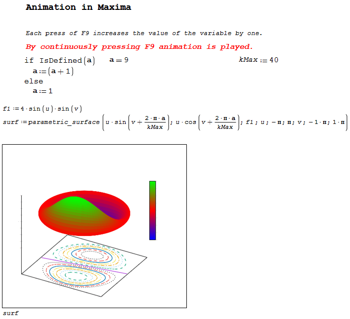

#289 Posted: 11/23/2020 4:28:27 PM
Fridel Selitsky
Fridel Selitsky
520 likes in 451 posts.
Animation in Maxima
Плагин Maxima не имеет встроенной возможности анимации.
Для создания анимации использовалась программа
https://en.smath.com/forum/yaf_postsm48012_Graph-animation.aspx#post48012
Для записи Gif файла использовалась программа GifCam.
povorot1.sm (74.29 KiB) downloaded 1679 time(s).
SpiralMaxima.sm (45.77 KiB) downloaded 1691 time(s).

#291 Posted: 11/23/2020 6:15:12 PM
Animation in Maxima
Very nice. Here is a version with absolute variables (names starting with ~, not easy to input with german keyboard) for execution counter. BTW, the original version reads temp storage before it is written. This throws an error similar to what would happen if I had not checked for a being undefined.
povorot1_kr.sm (75.16 KiB) downloaded 1718 time(s).

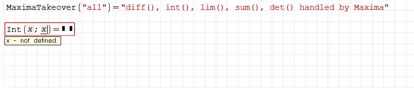

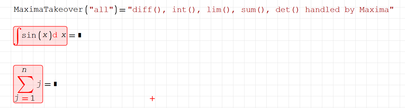

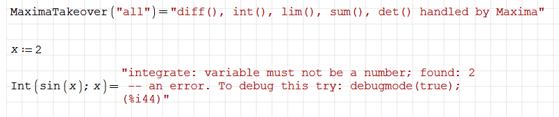

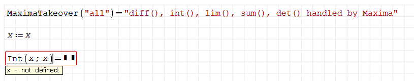

Hi Guys,
I'am using Smath for quite a while and already tried to use the Maxima plugin several times without any success.
I was able to do the setup as shown here: https://en.smath.com/forum/yaf_postst2078_Maxima-Plugin.aspx
But unfortunately in Smath the Int() function for symbolic integration never works. I'm pretty sure that I'm missing a little part. Can anyone help me please?
Example:
When I do define x I get the following error
And when I do assign something else than a number i get:
#299 Posted: 5/13/2021 5:05:17 PM

Example:
This is because you use numeric optimization (context menu). If you expect symbolic results, use symbolic optimization ("none" also works, it shows the result from Maxima without further processing by SMath).
The error message is correct. The integration variable must be unassigned.

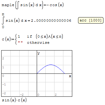

#300 Posted: 5/13/2021 8:03:57 PM
... but you have missed the best from Generous Smath Community.
1. Always/first plot the integrand.
2. You integrate over a ranged variate.
3. maple is delivered with native Smath.
