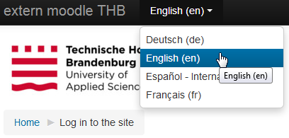

#202 Posted: 3/7/2017 8:49:31 PM
Alexander O. Melnik
Alexander O. Melnik
127 likes in 498 posts.
The download link in my signature for the portable version with maxima now works again.
I am being directed to this login page:
https://extmoodle.th-brandenburg.de/login/index.php

#204 Posted: 3/8/2017 6:04:58 AM
1,443 likes in 2,936 posts.
You must register before. On the page header you can change the language (BTW I've updated the link on the wiki to access using the english interface)

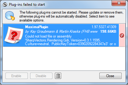

I have installed the regular Windows x64 version 0.98 (build: 6179) and have installed the Maxima Plug-in from the online gallery.
Upon opening SM I get the following warning:
I don't see how to remove or update the plug-in (CoolProps plug-in updated ok).
Maybe I have overlooked a step?
Tim
#210 Posted: 5/18/2017 3:52:35 PM
Brian Runagle
Brian Runagle
13 likes in 27 posts.
Confirmed for me also with 0.98 6179 and Windows 8 x64.
Brian
#211 Posted: 5/18/2017 6:05:51 PM
Click on "Close", here is Smath eager to run.
Same happened to me after few weeks of running fine
w/o this unexplained error message. It might be enough
to remove from the directory and re-download ?
#212 Posted: 5/18/2017 6:17:09 PM
1,361 likes in 2,275 posts.
Tim
What do you mean by "regular version"? Is it the portable version from my support page at THB?
The Maxima plugin isn't easy to configure, therefore I compiled the portable distribution (see link in the signature) which should run out of the box (from an usb stick or whatever directory where you dump the archive), including the interactive handbook (try the [?] button in the tool bar). It should work with Win7.
Problems with win10 have been reported. As I run just win7, there is not much I can do about it.
For full functionality of the maxima plugin, the 2014 version of the portable distribution should be used (at the cost of loosing great new SMath features). Basic problem is that in the meantime the integrate function has been protected against being taken over by 3rd party plugins. You can still use Maxima for integration but that involves workarounds and exceptions, see the interactive handbook for details.
Once the portable distribution is installed (unpacked) you can update the other plugins but don't touch SMath and the maxima plugin.
