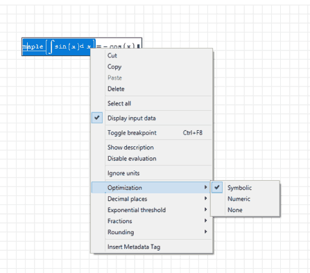

#284 Опубликовано: 25.03.2020 00:32:16
CBG
CBG
put the optimization to symbolic or none
Carlos
#285 Опубликовано: 25.03.2020 06:04:40
I have a portable version of Smath 0.99.7251. The Maxima is under D:\Program Files\Math Tools\SMath Studio\extensions\plugins\44011c1e-5d0d-4533-8e68-e32b5badce41\1.98.7100.23756\
I put the above path into insert->settings, but it show "Cannot find maxima.bat"
Did you install Maxima? If not, follow the link in my signature and see the instructions for installing and configuring Maxima. The plugin just provides the interface.
Thanks. I installed Maxima 5.42.2.
But still can't get result. SM file attached.
You have to set Optimization to Symbolic or None to display symbolic results. You can also press Ctrl+. instead of = to get symbolic results from an expression.

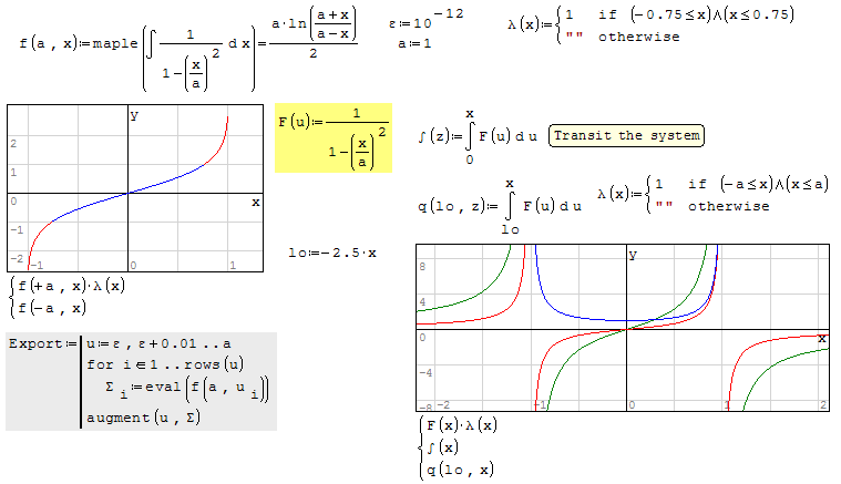

#287 Опубликовано: 08.10.2020 07:00:15

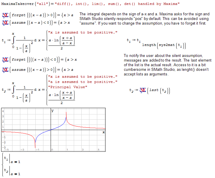

This is an example on how to control the assumptions used for symbolic integration in Maxima.

#288 Опубликовано: 10.10.2020 20:52:49
Get more from less ... typical.

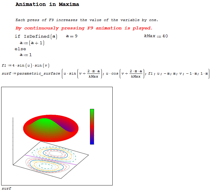

#289 Опубликовано: 23.11.2020 16:28:27
Fridel Selitsky
Fridel Selitsky
Animation in Maxima
Плагин Maxima не имеет встроенной возможности анимации.
Для создания анимации использовалась программа
https://en.smath.com/forum/yaf_postsm48012_Graph-animation.aspx#post48012
Для записи Gif файла использовалась программа GifCam.
povorot1.sm (74,29 КиБ) скачан 1679 раз(а).
SpiralMaxima.sm (45,77 КиБ) скачан 1691 раз(а).
Andrey Ivashov 23.11.2020 17:36:00, Martin Kraska 23.11.2020 18:06:00, IVR 25.11.2020 07:19:00

#291 Опубликовано: 23.11.2020 18:15:12
Animation in Maxima
Very nice. Here is a version with absolute variables (names starting with ~, not easy to input with german keyboard) for execution counter. BTW, the original version reads temp storage before it is written. This throws an error similar to what would happen if I had not checked for a being undefined.
povorot1_kr.sm (75,16 КиБ) скачан 1718 раз(а).
Fridel Selitsky 23.11.2020 19:10:00

#293 Опубликовано: 23.11.2020 19:10:35
Fridel Selitsky
Fridel Selitsky
Thanks a lot, Martin. Wonderful! I was not aware of the IsDefined function.

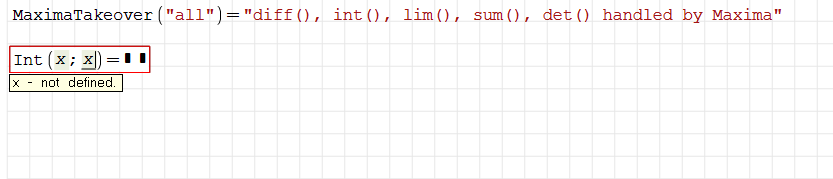

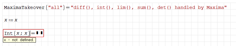

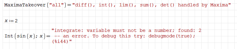

Hi Guys,
I'am using Smath for quite a while and already tried to use the Maxima plugin several times without any success.
I was able to do the setup as shown here: https://en.smath.com/forum/yaf_postst2078_Maxima-Plugin.aspx
But unfortunately in Smath the Int() function for symbolic integration never works. I'm pretty sure that I'm missing a little part. Can anyone help me please?

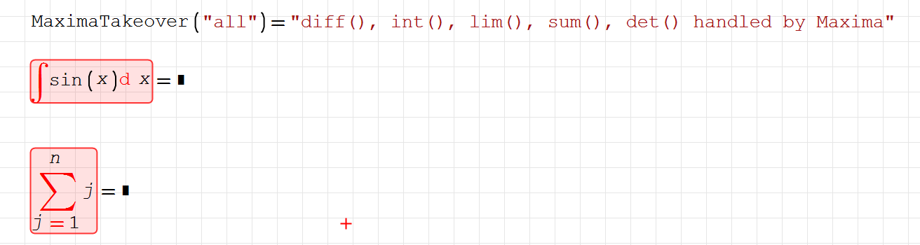

#299 Опубликовано: 13.05.2021 17:05:17
Hi Guys,
But unfortunately in Smath the Int() function for symbolic integration never works. I'am pretty sure that I'am missing a little part. Can anyone help me please?
Example:
This is because you use numeric optimization (context menu). If you expect symbolic results, use symbolic optimization ("none" also works, it shows the result from Maxima without further processing by SMath).
When I do define x I get the following error
The error message is correct. The integration variable must be unassigned.
#300 Опубликовано: 13.05.2021 20:03:57

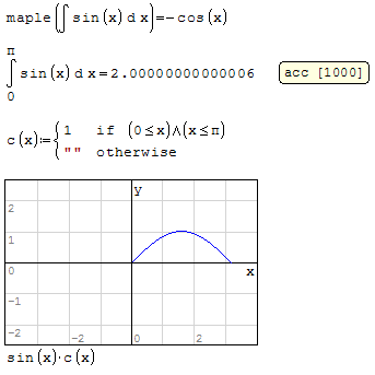

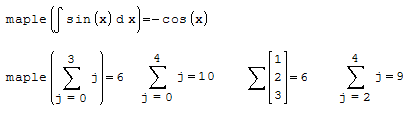

... but you have missed the best from Generous Smath Community.
1. Always/first plot the integrand.
2. You integrate over a ranged variate.
3. maple is delivered with native Smath.
