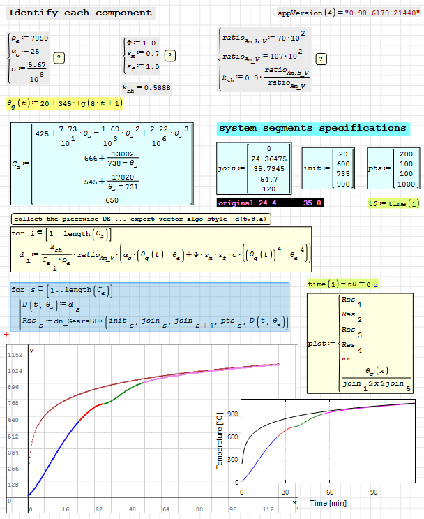

Do you mean something like "Steelfire" done/augmented a while ago ?
ODE Multiconditional [Steel fire].sm (63.85 KiB) downloaded 862 time(s).
#102 Posted: 11/7/2020 11:03:18 PM
... the compactum for loop counter is most shorter, slightly adapted.
ODE Multiconditional [Carlos Compactum].sm (26.5 KiB) downloaded 906 time(s).
Like this..
One of my memory cards decided to leave me hanging this weekend.. I guess I've spent too much time on SMath.
Cheers.
Steel_temperature_complete.sm (90.65 KiB) downloaded 1103 time(s).

#104 Posted: 11/9/2020 1:59:12 PM
Spare time to adapt your project around the more advanced ODE multi-condition.
Be careful about Bolean, sometimes tolerant but generally must be specified completely.
Mathcad was more tolerant Bolean, however had to be doctored many times in Collaboratory.
Naturally, your document is red top to bottom SS 6179.
It is so much over killed of useless, it should pass QA piecewise.
If you join visibly, no need for the TOL.
In short wrt your SS version, you must arrive at the exportable pieces.
Each piece for QA sanity check [Matlab, Mathcad ...]
ODE Multiconditional [Carlos Compactum] Copy.sm (80.79 KiB) downloaded 956 time(s).

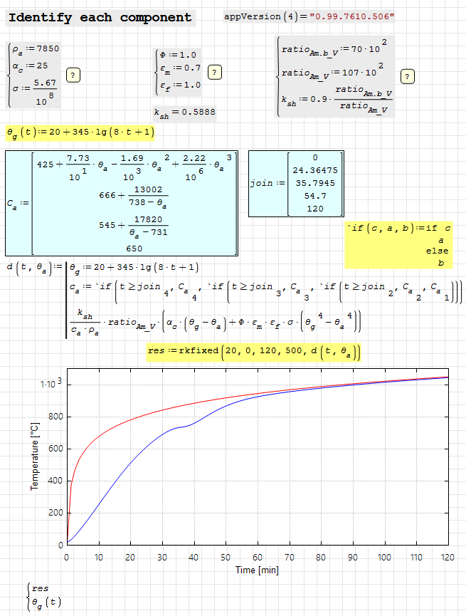

#106 Posted: 11/10/2020 9:13:21 AM
hanskl
hanskl
7 likes in 158 posts.
In the event this document generates red in your version,
no more help/doctoring is possible whereas SS version incompatibilities.
The document is indeed red top to bottom.
Anyway, although the document became less "techincal" after uniting all pieces in one single ODE using cases(), the project is now complete after some testing against a Excel spreadsheet I found online.
SMath community comes through once again!

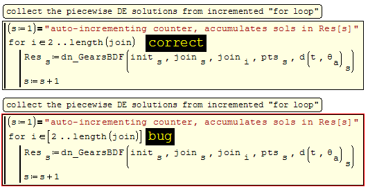

#110 Posted: 11/12/2020 12:00:04 PM
Jean, I just printed this PDF.
Thanks Hanski, that identifies the Smath bug.
Since which SS version, that bug exists ... ?
If you can't doctor as given, end of most Smath.
Of so many utilities that make Smath productive, the auto-increment for loop
is by large the most used and necessary. If I would update my 6179,
a great percentage of my 2500 documents would turn red hot.
Hope designers read this. If not acknowledged, will report in "Bugs"
Was that bug introduced at time indexing the LHS definition 'data[i:= ...'
At work Doctors

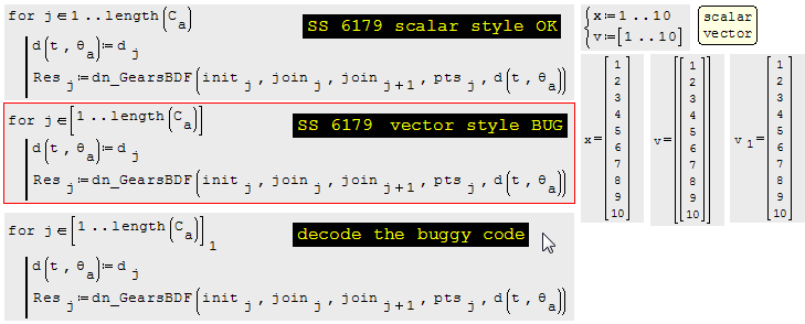

#112 Posted: 11/12/2020 8:42:07 PM
The switch from 5346 to 6179 didn't destroy any of the previous 5346.
That latest SS destroys 6179 is purely a bug.
Mathcad 11 didn't destroy previous Mathcad 8
Decode the freaked code is non-sense to me.
Hello Hanski, try to decode the bug, let's see if it goes to end.

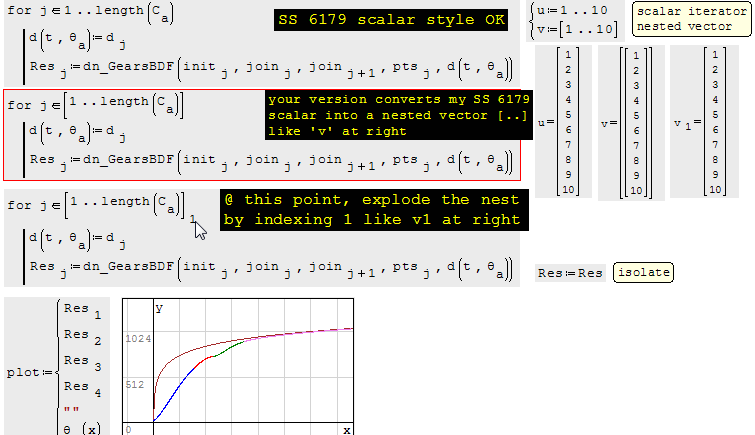

#116 Posted: 11/13/2020 2:55:37 PM
Jean,
My very limited capabilities within SMath is unable to «doctor» this.
I understand SMath is a work in progress (thank god). It seems a shame older sheets are throwing up errors because the structure/use of functions are no longer supported/have changed.
1. That piece that turned red in your *.PDF, try to code as per Uni snippet.
2. Otherwise, try to doctor the damaged SS 6179 as demonstrated.
There is no justification for your SS version to convert SS 6179 scalar into nested vector.
That to me is a bug that may render zillions documents red from the Samples Repository.
Please report where you stand-in [blue sky, red document, OK].
Cheers ... Jean.
ODE Multiconditional [Carlos Compactum] Copy.sm (82.73 KiB) downloaded 914 time(s).

Yes, not happy latest SS converts SS 6179 scalar into vector.
Thanks for your immense contribution ... Jean.

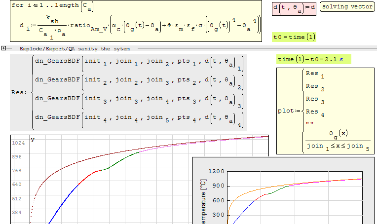

#119 Posted: 11/14/2020 11:05:50 AM
... w/o for loop, still conserving the export for QA sanity.
