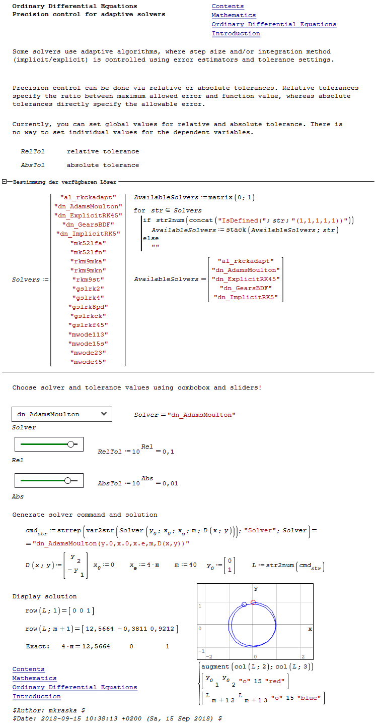

Just one question - is it possible to define a function quickswitchODEsolver(a,b,c,d,e)=ODEsolver(a,b,c,d,e) <-- This could be Rkadapt() for example, or maybe another solver.
Can the 8 different resolutions then be solved by quickswitchODEsolver()?
The goal is to have to change the solver function only one place rathere than 8, if I want to switch.
Cheers.

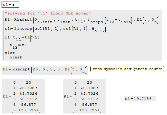

Cheers.
Temperaturforlop.sm (119.63 KiB) downloaded 1126 time(s).
There might be smoother ways but this works. Note that I had to replace the sliders because the old regions don't seem to work any more with new SMath versions.
Section Math ODE precision.sm (23.08 KiB) downloaded 1080 time(s).
Thanks. I already had a go at this approach as uni directed me towards it.
It works fine when I apply it to ODE itself, but when I wrap the ODE into a for loop (a necessity to establish boundary conditions for the whole set of ODEs) something goes wrong..
Cheers
